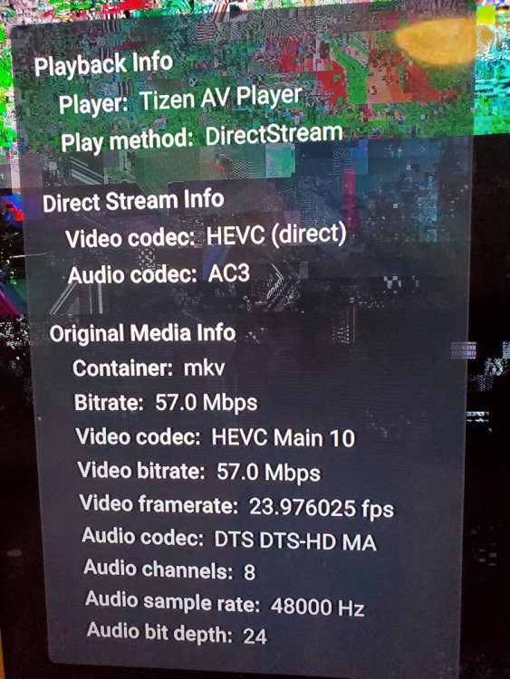

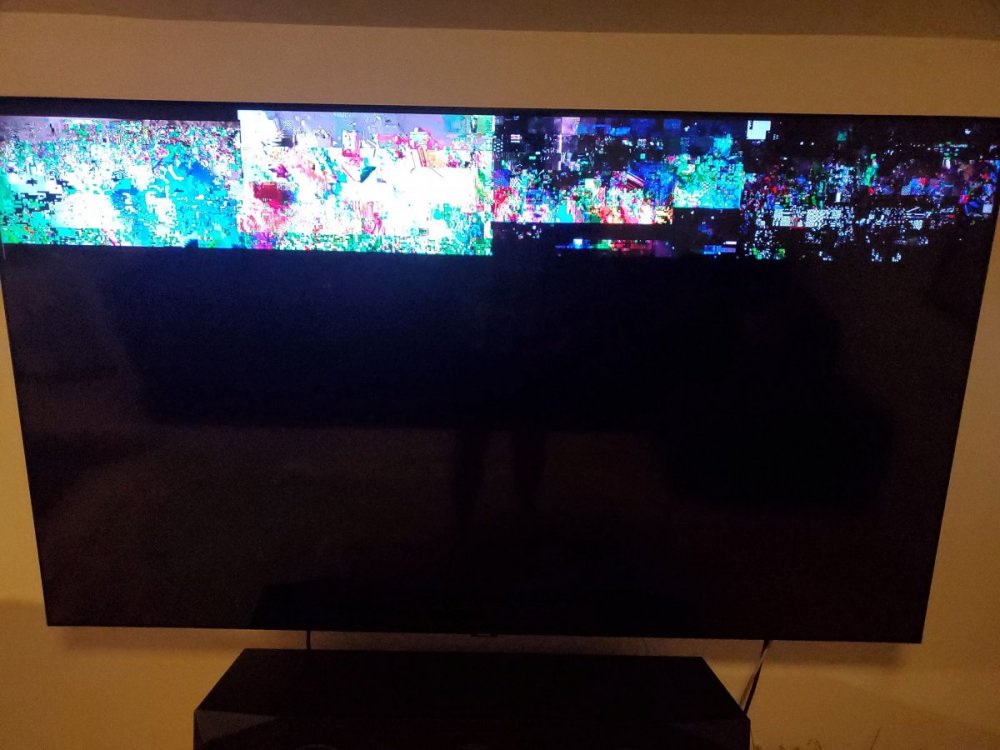

Crusher21 0 Posted November 10, 2020 Posted November 10, 2020 I've been attempting to watch two 4K movies on my Samsung Q70. I've ensured that subtitles are off (because Emby will start transcoding the video when subtitles are enabled) and you can see from the picture below that it is not transcoding. However, I can visually see the free space on my SSD going down about 1GB/4 seconds when the movie is playing (and I've traced it back to the 'transcoding-temp' folder). When I exit out of the movie on my TV, that directory gets cleared. Windows is only installed on a 128GB SSD at the moment and this problem is causing my SSD to hit 0 bytes free. When this happens, I start to notice buffering on the TV. Also, I thought this may be related so I posted a picture of it: usually when the SSD hits 0 bytes free and there is a scene change in the movie, you will see a distorted image like below. The audio will continue to play in the background. The picture will not remain static, it will continuously change, not very drastic changes though. The video will never successfully proceed to the next scene. Even if I exit the video and fast forward to the time index, the aforementioned folder will once again consume the free space on my disk and the same problem will arise (still uncertain if this would occur if I could immediately seek to the timeframe, but for some reason I'm only able to do 10sec increments which takes forever because I have to wait for each buffer). I'm going to try to workaround the problem for the time being by hosting my appdata folder on a larger drive, but why is this 'transcoding-temp' folder continuing to increase in size when Emby is not transcoding? Also, is the distortion from scene changing (usually around the 5-minute mark of the video) likely due to the lack of free space on the drive? I can confirm that the source files are intact.
Happy2Play 9802 Posted November 10, 2020 Posted November 10, 2020 (edited) The image show DirectStreaming, so the transcoding-temp folder is being used. This folder is used no matter the playback method unless a true direct playback is being done. If the server does a http direct play the folder is used also. https://support.emby.media/support/solutions/articles/44001920144-direct-play-vs-direct-streaming-vs-transcoding You will need to relocate the transcoding-temp to a larger drive. Dashboard-Transcoding "Transcoding temporary path" Edited November 10, 2020 by Happy2Play

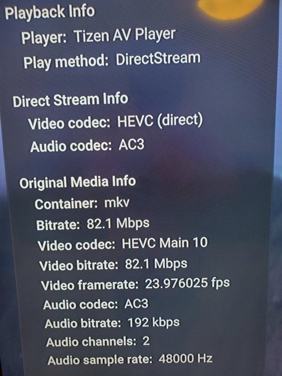

Crusher21 0 Posted November 10, 2020 Author Posted November 10, 2020 @Happy2Play I believe I have identified the issue. The problem is not with the video codec, it is the audio codec. As you suggested, I tried to find a source file that would not require transcoding. I was not able to find one but I found one that did not require the audio codec to be transcoded (see details in the picture below). The file played perfectly using built-in AC3 audio. For fun, I tested again with the DTS-HD MA 7.1 codec and once again ran into the same problem. Both problematic files use this codec. The file that did not have a problem used TRUEHD 7.1. Is this a bug that can be looked into?
FrostByte 5437 Posted November 10, 2020 Posted November 10, 2020 (edited) This is a known issue with the Samsung app when converting HD audio or DTS with 4K. For best results you will want an alternate audio track in all your 4K which your TV supports so that it Direct Plays. I.e. no HD audio, or DTS at all if your TV is 2018 or newer Edited November 10, 2020 by FrostByte 1
