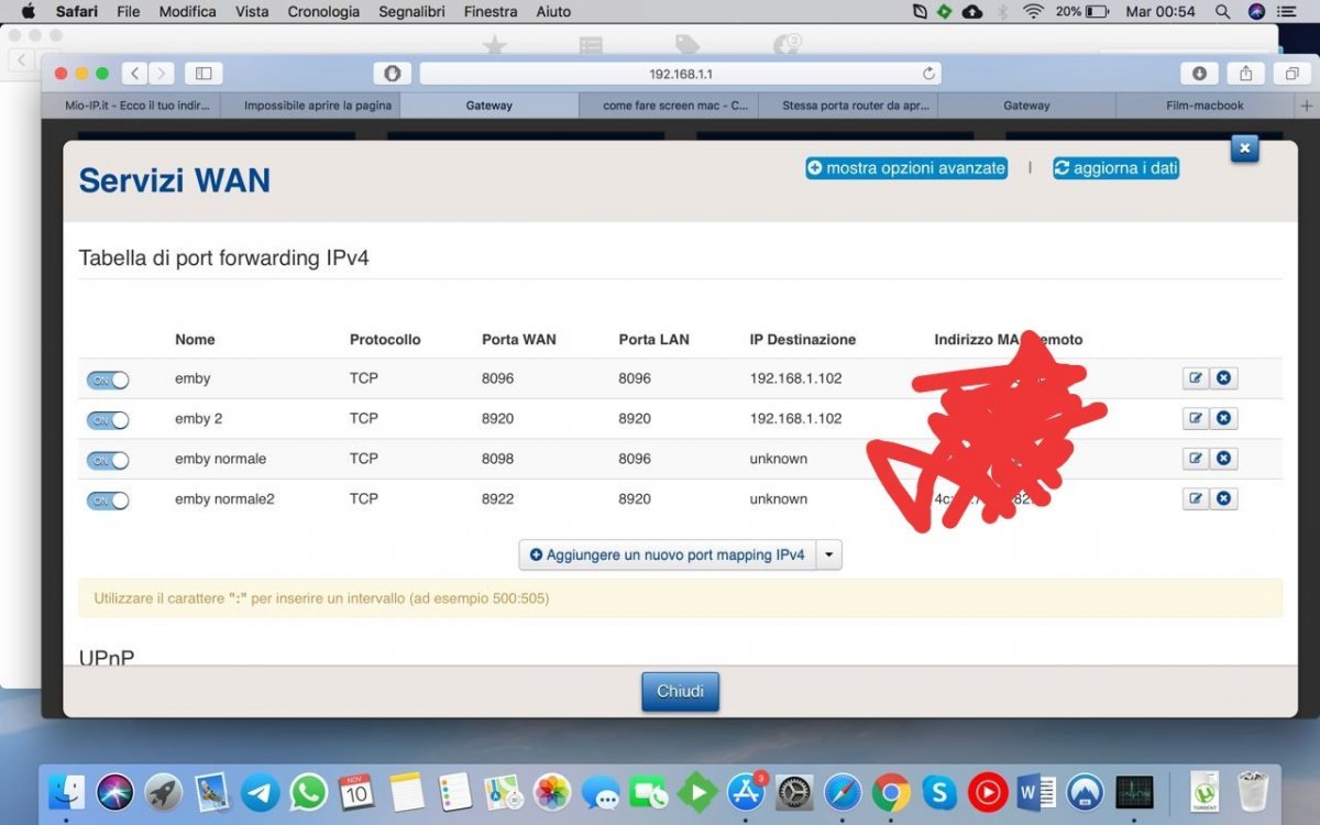

damnlazers 0 Posted November 9, 2020 Posted November 9, 2020 Good evening to all, today I started to explore this "emby" world. I created a media server to share with some of my friends; however they had some problems in the connection to the server from the beginning. But, I followed the tutorial and, opening the router's ports, my friends managed to connect to my server. Now, i try to explain: i forwarded the ports for the local IP address of my range extender and NOT for my main router, so, just going from a room to another, and automatically switching the connection to my main router, the others cannot connect to the server anymore, because i can't open the same ports for two different locals IP. Any possible solution? Something to "pretend" to open the ports for both the ip addresses? Thank you for your time, Mauro

damnlazers 0 Posted November 9, 2020 Author Posted November 9, 2020 (edited) 34 minutes ago, cayars said: Hi, Not sure I follow you. A range extender shouldn't have any ports to open as it's just a WIFI extender not a router. Port forwarding is part of firewall setup between the WAN and LOCAL side. Can you elaborate more what setup you have in place? Hi, thanks for answering! The local IP address changes when I switch my connection to the wifi extender. The problem is: I cannot forward the same port for more than one local IP address. Ip address goes to "unknown" when i'm not connected, but it is 192.168.1.224. I tried to open the same port through keeping the same LAN port and changing just the WAN. Didn't work Edited November 10, 2020 by damnlazers

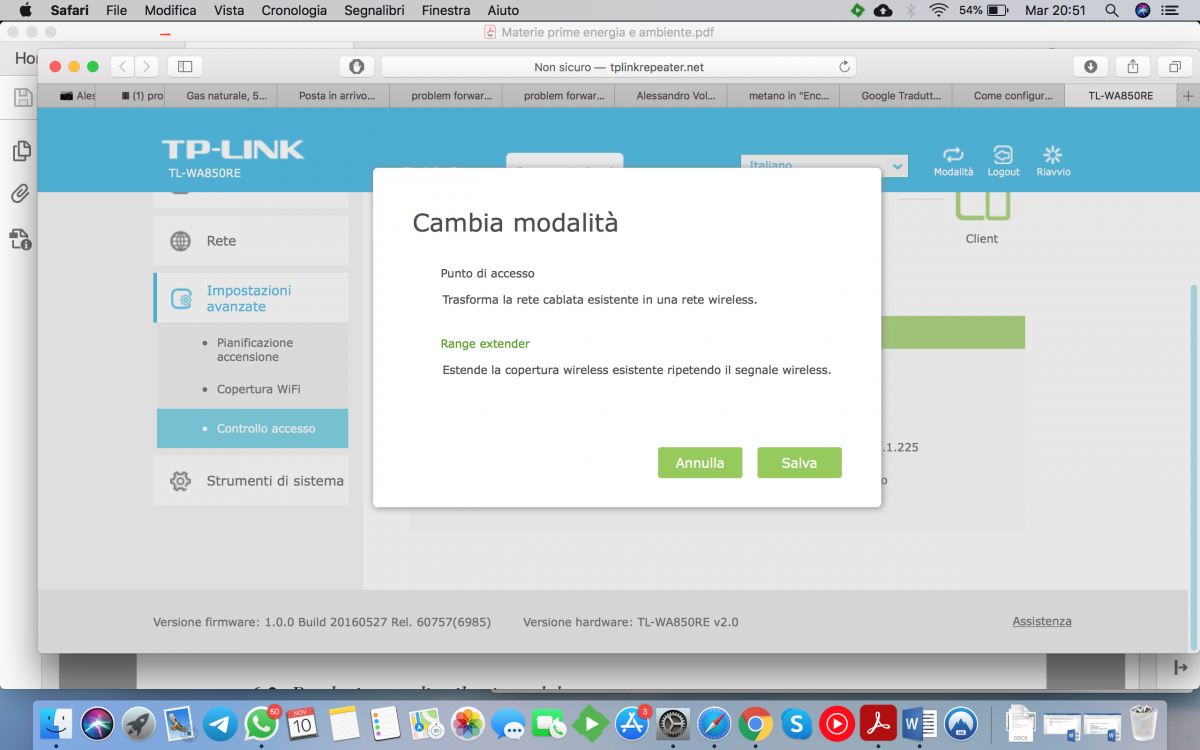

damnlazers 0 Posted November 10, 2020 Author Posted November 10, 2020 2 hours ago, rbjtech said: You may have it set to an 'AP' mode (Access Point) or something like that - you basically need it in 'Extender' mode where all you need to set, is the existing Wifi details. 2 hours ago, cayars said: It's not a matter of just DHCP but this "range extender" is setup wrong and running in the wrong mode. IT's not range extending. This is my wifi-extender setup. Hope it's understandable! Second screenshot is: change mode: -access point, -range extender When i connect to that, LAN address on the emby server changes and it's like i never port-forwarded (cause it seems it's valid just for one LAN address).

pwhodges 2028 Posted November 11, 2020 Posted November 11, 2020 I note that the extender settings display the SSID with "extender" on the end of it. Surely the SSID should be the same as the original, which presumably does not have that? Paul
rbjtech 5337 Posted November 11, 2020 Posted November 11, 2020 https://static.tp-link.com/res/down/doc/TL-WA850RE(EU)_V2_UG.pdf The setup looks very simple - if you have WPS on your main router/wifi - then press it, followed by the wps on the extender. Job done. Do not choose a different SSID name if you do it manually - choose the SAME SSID, then clients can connect to either/or AP as they wish. The backhaul network will be the same, regardless of the number of AP's - so any port forwarding will then work without any issues.
