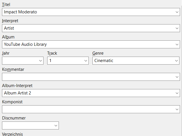

horstepipe 422 Posted November 9, 2020 Author Posted November 9, 2020 22 minutes ago, Happy2Play said: Any extended tags ie musicbrainz ids? not that I'm aware of. These are the only tags visible in mp3tag (screenshot). Is there another way to verify the tags are not corrupted somehow?

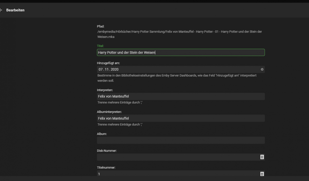

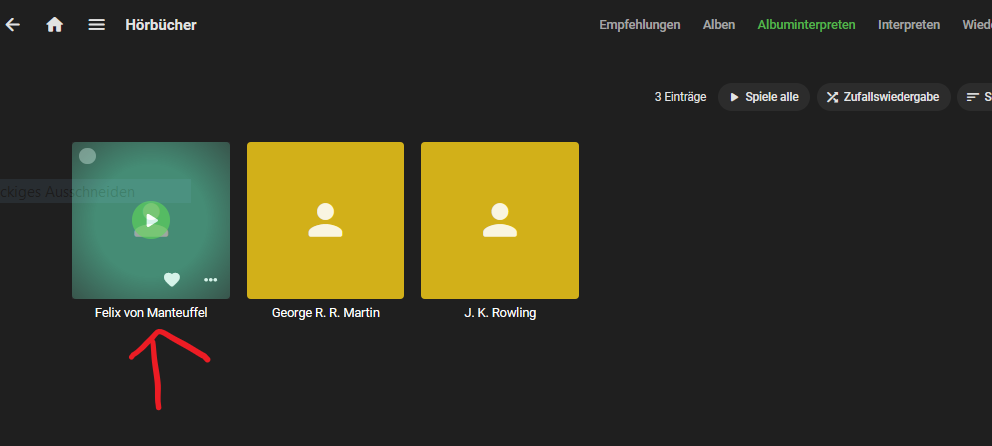

horstepipe 422 Posted November 9, 2020 Author Posted November 9, 2020 (edited) so I'm not able to give reproduction steps for exactly this problem, but I am able to give reproduction steps to show there is some inconsistency at all. I tested on a fresh Emby Server installation (Windows 10). Just add the attached folder to an audio book library, check and note the artist and album artists Emby is showing, remove the folder from Emby library and change the album artist field to e.g. "album artist 2". Now add the folder back to Emby, take a look at artists and album artists field and repeat the whole process (editing the album artists tag). You will see strange results. E.g. while I'm just testing around I see this inconsistency: In words: I didn't touch the "artists" tag of the file, but Emby doesn't show the artist anymore. Test Audio Book.7z Edited November 9, 2020 by horstepipe

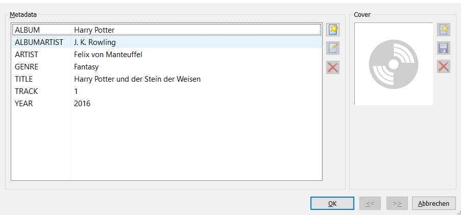

PenkethBoy 2068 Posted November 9, 2020 Posted November 9, 2020 select all the files from one of the problem albums and do ALT+T to bring up the extended tag dialog box i would guess you will see other tags not in the left hand panel 1
horstepipe 422 Posted November 9, 2020 Author Posted November 9, 2020 thanks. This is just from one file, but it is the one which I already tried to add isolated from the others where the issue reappeared. Looking fine, doesn't it?

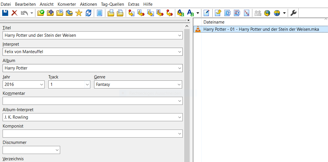

horstepipe 422 Posted November 11, 2020 Author Posted November 11, 2020 1 hour ago, Happy2Play said: Sorry on a new portable Windows server I have no issue changing Album Artist 2 to Album Artist 3 and it appearing, then changing it back to Album Artist 2 and it appearing. What software do you use to change the tag?
Happy2Play 9802 Posted November 11, 2020 Posted November 11, 2020 Just now, horstepipe said: What software do you use to change the tag? Same as shown above, Mp3tag v3.0.3
