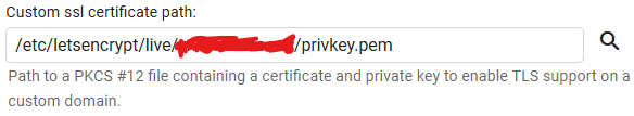

Snaak 0 Posted November 6, 2020 Author Posted November 6, 2020 Yes, but when I try to save this I keep getting "not found". Which is why I think I missed a step. I thought the path would either be /etc/letsencrypt/live/MyHostname/fullchain.pem or /etc/letsencrypt/live/MyHostname/privkey.pem. Sadly neither of those work.
Q-Droid 1011 Posted November 6, 2020 Posted November 6, 2020 Emby doesn't work with a PEM file, it needs a PKCS 12 archive with your private key, certificate and intermediate (chain) certs.
Snaak 0 Posted November 6, 2020 Author Posted November 6, 2020 Just now, Q-Droid said: Emby doesn't work with a PEM file, it needs a PKCS 12 archive with your private key, certificate and intermediate (chain) certs. Oh I see, my bad. In that case, how would I activate SSL then if I can't do it with certbot?
Q-Droid 1011 Posted November 6, 2020 Posted November 6, 2020 When certbot runs it saves your newly issued cert under its own structure. You can run openssl to create the pfx archive which you then copy to the location for emby, like /var/lib/emby/ssl. openssl pkcs12 -export -in /etc/letsencrypt/live/<FQDN>/fullchain.pem -inkey /etc/letsencrypt/live/<FQDN>/privkey.pem -out <your filename>.pfx Remember the password you give it. To verify pfx and password are good. openssl pkcs12 -info -in <your filename>.pfx -nokeys Create the directory /var/lib/emby/ssl, make sure it's owned by emby. Copy the pfx file there (make sure it's owned by emby), then enter the full path and password in the Emby network setup. Save and restart Emby.

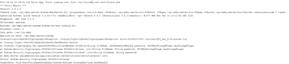

Snaak 0 Posted February 6, 2021 Author Posted February 6, 2021 (edited) On 2/5/2021 at 12:28 AM, Q-Droid said: The timing is about right for the cert to expire. Click on the "Not Secure" tag (or the lock) on the browser address bar, then on "Certificate" to view it. The validity date will be in that window. LetsEncrypt certs are good for 90 days. Run certbot again to renew the cert then follow the same steps above that you used the last time. I followed the steps but it won't work, I have an error in my log but I can't make sense of it. Edited February 6, 2021 by Snaak Better screenshot
Q-Droid 1011 Posted February 6, 2021 Posted February 6, 2021 Post output from: ls -l /var/lib/emby/ssl
Snaak 0 Posted February 6, 2021 Author Posted February 6, 2021 (kudos to your reaction speed btw, much appreciated)
Q-Droid 1011 Posted February 6, 2021 Posted February 6, 2021 sudo chown emby:emby /var/lib/emby/ssl/certificate.pfx restart emby 1
Snaak 0 Posted February 6, 2021 Author Posted February 6, 2021 I see, I assumed the certificate.pfx would also be owned by emby because I gave the path ownership. Another quick question, can't I simply use "certbot renew" to renew my certificate? Or wouldn't it work because Emby doesn't support it?
Q-Droid 1011 Posted February 6, 2021 Posted February 6, 2021 The pfx will be owned by the user who creates it, the one running openssl. Certbot creates the pem files, it doesn't create the pfx file so "certbot renew" only gets you partway there. The pfx file is a container to hold the certificates in a pkcs12 file format. With LetsEncrypt they need to be replaced every 90 days. Other ACME based clients might have the option to renew the certs and create the pfx in one step but I haven't explored those. 1
