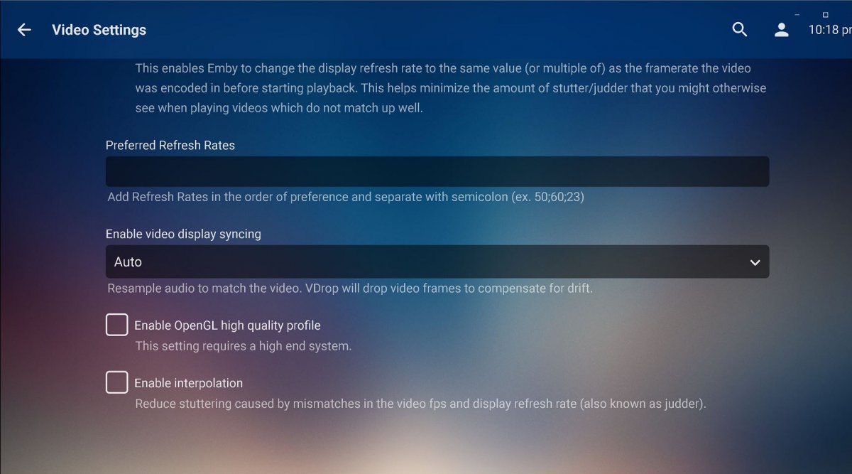

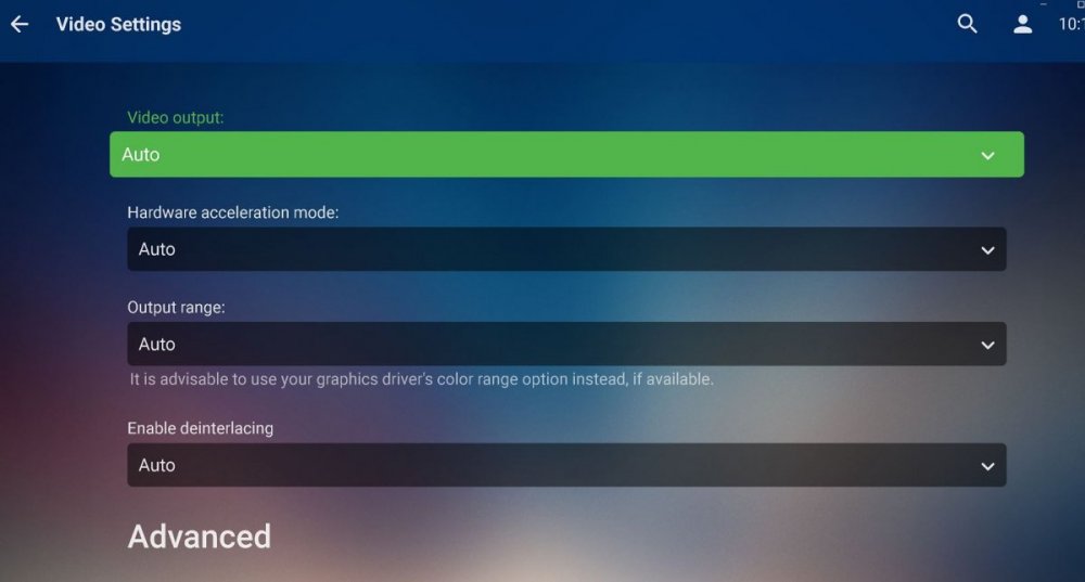

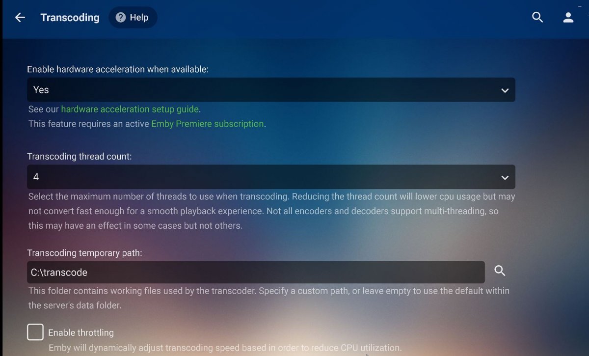

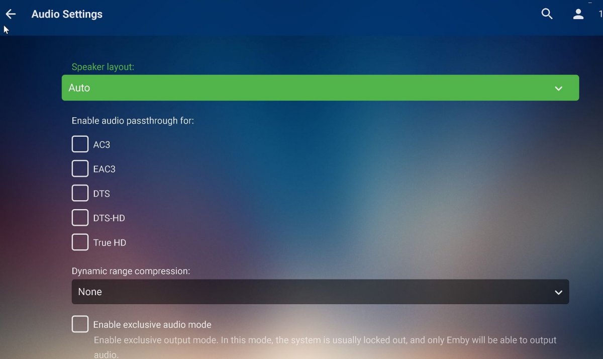

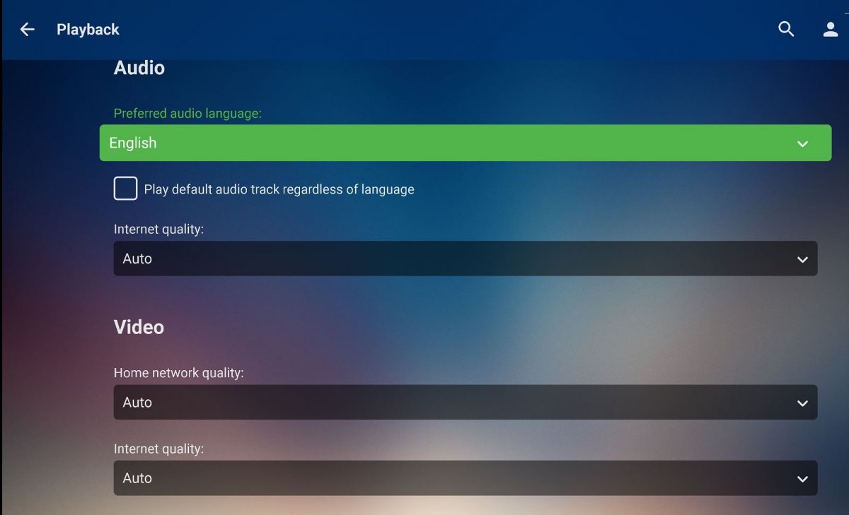

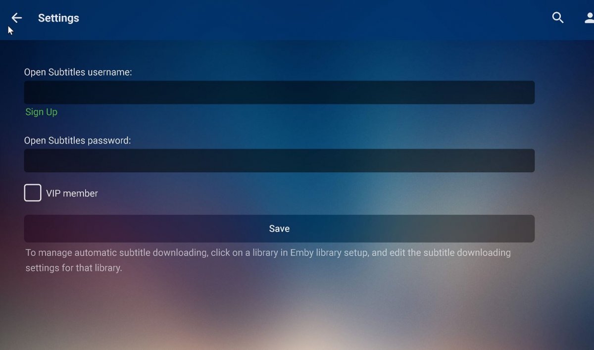

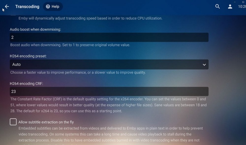

maxxcool7421 0 Posted November 4, 2020 Author Posted November 4, 2020 (edited) here's a start! DxDiag output.. i7-3770 CPU @ 3.40GHz 4-physical cores, 4-hyperhtreaded. CPU is hard locked at 3.4ghz, It never drops under 3.4Ghz 1030 GT Nvidia ; supports decode hevc, but not encode hevc 16GB ram OS on a SSD Emby server and theater installed to the SSD Transcode DIR is on the SSD Media files on (2) 4tb platter drives Power profile set to 'high performance', no drive sleep getting screenshots.. DxDiag.media.dell.txt Edited November 4, 2020 by maxxcool7421
maxxcool7421 0 Posted November 4, 2020 Author Posted November 4, 2020 (edited) those are the defaults obviously from the beta player. Additional data ; playing the file from the server>browser makes the issue ''worse'' .. the subs pop in and out nearly instantly and not very often. Edited November 4, 2020 by maxxcool7421

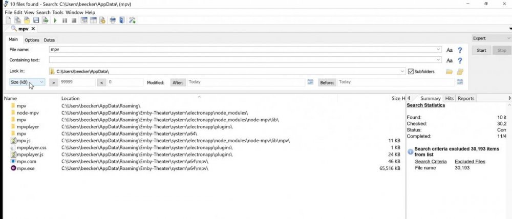

maxxcool7421 0 Posted November 4, 2020 Author Posted November 4, 2020 (edited) 8 hours ago, sooty234 said: Ok, so let's get an mpv log. Unzip the folder to: C:\users\USERNAME\AppData\Roaming Open the file mpv.conf You'll see the line log-file=" Complete the line to specify the directory and file name. I suggest the desktop, as it's easy to find, but anywhere is fine. So it will look something like this: log-file="C:\Users\maxxcool7421\Desktop\mpv log.txt" Play the video once, and attach the log. MPV settings file does not exist? Searched and did not find it in the root if roaming, figured it was in a subfolder so searched and did nor see it here... searched all of C volume and did not find it... did a in file text search for log-file and also did not get any hits on C volume ... Edited November 4, 2020 by maxxcool7421
sooty234 266 Posted November 4, 2020 Posted November 4, 2020 (edited) Oh my bad, I forgot to attach the zip file. You can do it yourself, though. You have the mpv folder, just make a file called mpv.conf. And put the log-file line in it. Edited November 4, 2020 by sooty234
