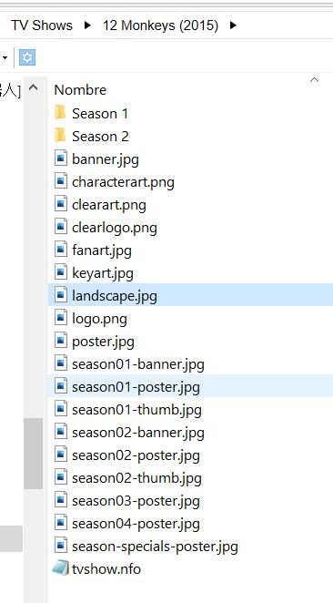

Happy2Play 9802 Posted November 1, 2020 Posted November 1, 2020 Can you go over a specific example showing folder content and server log.
rodainas 191 Posted November 1, 2020 Author Posted November 1, 2020 (edited) Here it is. Thank you Problem originated after doing a replace existing images with just TVDB as Series Fetcher (with no image type selected on settings), the tv shows library lose all the series images, and recreating the library gives the same result. Edited December 24, 2020 by rodainas
Happy2Play 9802 Posted November 1, 2020 Posted November 1, 2020 Nothing is standing out that I can see be it is only affecting "/mnt/drive4/TV Shows" that I can see from the log. All images with media should take priority over online images. But the log does not reference any series images. If you created a new library with a new name and path and moved a couple series into that new folder do you see the same results? I am thinking possibly a database issue if this test works. 1
rodainas 191 Posted November 1, 2020 Author Posted November 1, 2020 Am testing that out, new library with a new folder with a couple of tv shows, emby is scanning, I will get back to you with the results
rodainas 191 Posted November 1, 2020 Author Posted November 1, 2020 (edited) Ok the scan finished and emby is showing the local images, I will try try to make the library with the original name and original folder name and see what happens now. Edited November 1, 2020 by rodainas
Happy2Play 9802 Posted November 1, 2020 Posted November 1, 2020 8 minutes ago, rodainas said: Ok the scan finished and emby is showing the local images, so I cant use now the name TV Shows for the library and the folder TV Shows? Just guessing here but that would appear so as there is something wrong in the database with that specific path. But it is more about the Path issue, then the library name.
rodainas 191 Posted November 1, 2020 Author Posted November 1, 2020 I recreated the original library name and with the original library path, 2 tv shows, it scanned and showed the local images, so it appears it is working as expected now.
