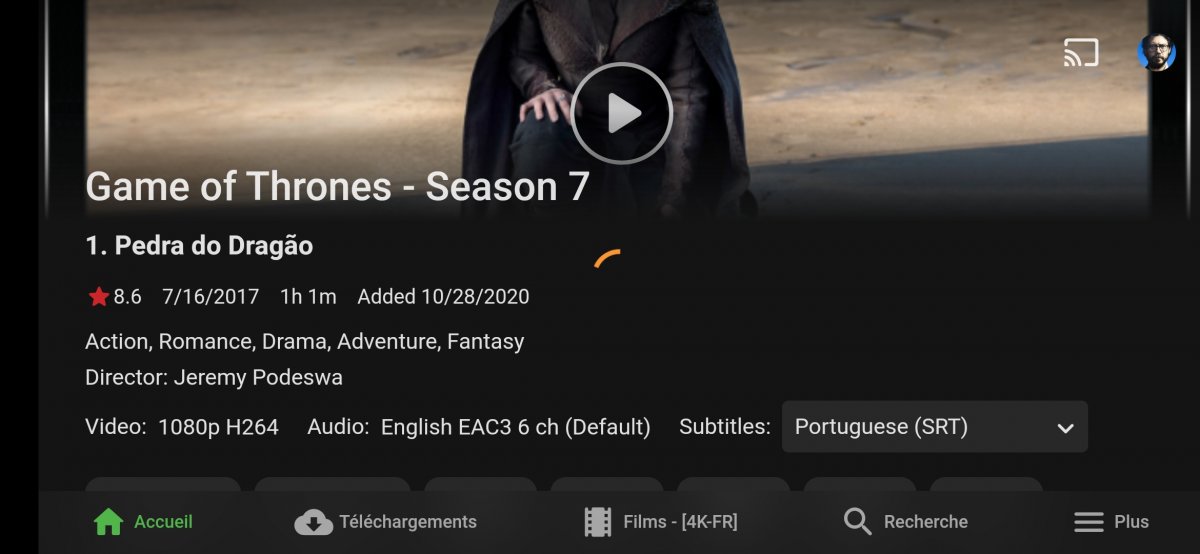

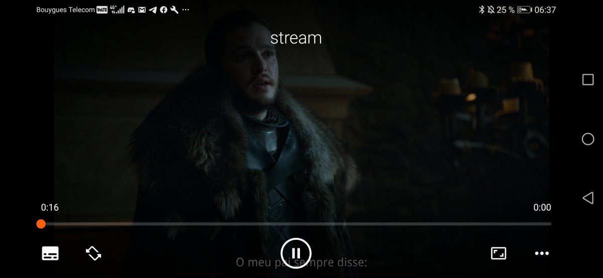

CyberPoison 33 Posted October 30, 2020 Author Posted October 30, 2020 (edited) With exoplayer (No sound or subtitles) With VLC (OK) With emby ( Just won't load nothing) LG WebOS (Works through the https) BTW the way my config is (Handled by Reverse Proxy) and I use ingress controller as reverse proxy to port 8096 because the 8290 won't work Edited October 30, 2020 by CyberPoison
CyberPoison 33 Posted October 30, 2020 Author Posted October 30, 2020 As you can see the emby app still spinning so the player doesn't start But on the external player (VLC) it works nice not sure if this is a issue with the server side config but if you have any suggestions to fix this across all platforms it will be nice
