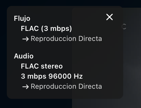

Luke 42255 Posted May 1, 2025 Posted May 1, 2025 If you view the song detail screen in the web app, does it show the correct sample rate?
vdatanet 1619 Posted May 1, 2025 Posted May 1, 2025 24 minutes ago, Luke said: If you view the song detail screen in the web app, does it show the correct sample rate? Yes, Using web app SFN shows the correct sample rate: BTW The same thing happens while using DLNA plugin
