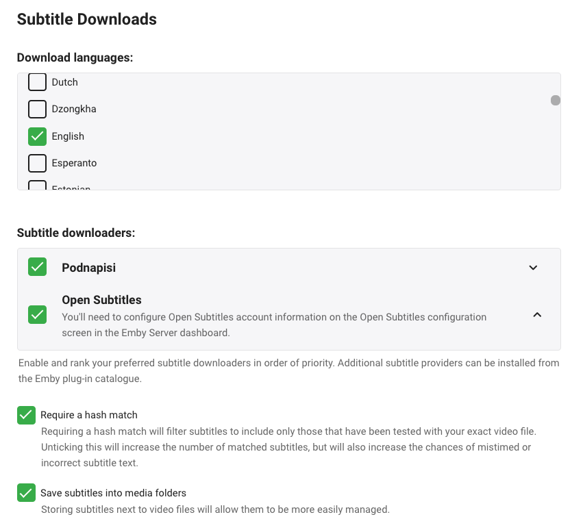

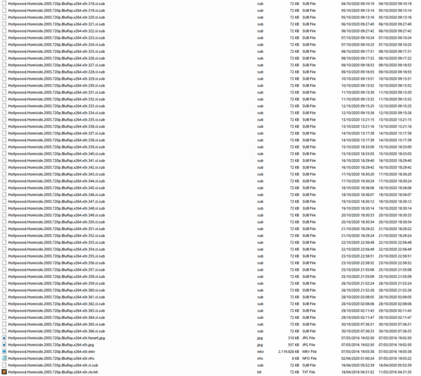

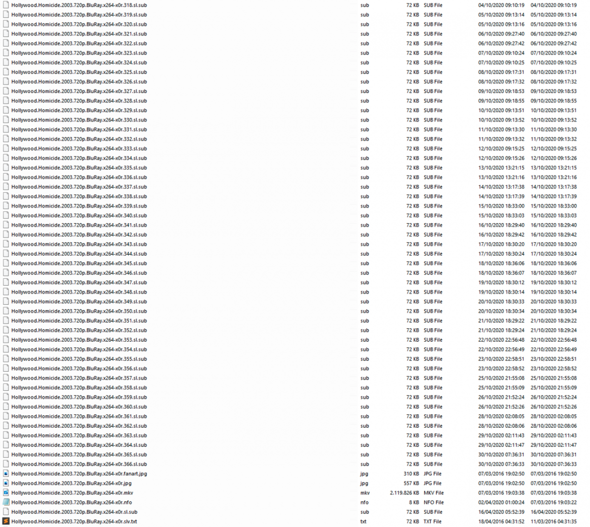

billzkid 1 Posted October 30, 2020 Posted October 30, 2020 (edited) Hi, I will try to further clarify the problem because I have the same issue. I just posted a snippet from a log i think it is relevant. I know you prefer whole logs so if this will not be enough i will provide whole logs. I am using Emby 4.5.2.0 as can be seen bellow in the App Data section from server log. The symptom of the error is, as drevokocur said, hundreds of subtitles for certain movies in the media folder. As you can see in the log excerpt below it seems subtitle manager tried to download subtitles twiceand saved 365-th and 366-th version of the subtitles for this movie then moved forward to next subtitles. I have upload screenshot of the folder with multiple subtitles as well. I have also attached screenshot of subtitles settings of the library. Slovenian and English languages are selected (can't be seen on screenshot). Is this ok (do you have enough info)? 2020-10-30 07:36:30.297 Info HttpClient: POST https://api.opensubtitles.org/xml-rpc 2020-10-30 07:36:30.356 Info HttpClient: GET https://www.podnapisi.net/subtitles/search/old?sXML=1&sL=sl&sK=Her Smell&sY=2019 2020-10-30 07:36:30.937 Info HttpClient: POST https://api.opensubtitles.org/xml-rpc 2020-10-30 07:36:30.994 Info HttpClient: GET https://www.podnapisi.net/subtitles/search/old?sXML=1&sL=sl&sK=Hollywood Homicide&sY=2003 2020-10-30 07:36:31.563 Info HttpClient: GET https://www.podnapisi.net/sl/subtitles/sl-hollywood-homicide-2003/5gQ/download 2020-10-30 07:36:31.968 Info SubtitleManager: Saving subtitles to F:\Movies\MoviesToWatchLater\Hollywood.Homicide.2003.720p.BluRay.x264-x0r\Hollywood.Homicide.2003.720p.BluRay.x264-x0r.365.sl.sub 2020-10-30 07:36:31.983 Info MediaProbeManager: ProcessRun 'ffprobe' Execute: C:\Users\billzkid\AppData\Roaming\Emby-Server\system\ffprobe.exe -i file:"F:\Movies\MoviesToWatchLater\Hollywood.Homicide.2003.720p.BluRay.x264-x0r\Hollywood.Homicide.2003.720p.BluRay.x264-x0r.mkv" -threads 0 -v info -print_format json -show_streams -show_chapters -show_format -show_data 2020-10-30 07:36:32.034 Info MediaProbeManager: ProcessRun 'ffprobe' Process exited with code 0 2020-10-30 07:36:32.295 Info HttpClient: POST https://api.opensubtitles.org/xml-rpc 2020-10-30 07:36:32.359 Info HttpClient: GET https://www.podnapisi.net/subtitles/search/old?sXML=1&sL=sl&sK=Hollywood Homicide&sY=2003 2020-10-30 07:36:33.003 Info HttpClient: GET https://www.podnapisi.net/sl/subtitles/sl-hollywood-homicide-2003/5gQ/download 2020-10-30 07:36:33.328 Info SubtitleManager: Saving subtitles to F:\Movies\MoviesToWatchLater\Hollywood.Homicide.2003.720p.BluRay.x264-x0r\Hollywood.Homicide.2003.720p.BluRay.x264-x0r.366.sl.sub 2020-10-30 07:36:33.792 Info HttpClient: POST https://api.opensubtitles.org/xml-rpc 2020-10-30 07:36:33.849 Info HttpClient: GET https://www.podnapisi.net/subtitles/search/old?sXML=1&sL=sl&sK=Holy Hell&sY=2016 2020-10-30 07:36:34.322 Info HttpClient: POST https://api.opensubtitles.org/xml-rpc App Data 2020-10-30 00:00:00.020 Info App: Application version: 4.5.2.0 2020-10-30 00:00:00.020 Info App: Emby Command line: C:\Users\billzkid\AppData\Roaming\Emby-Server\system\EmbyServer.dll -noautorunwebapp Operating system: Microsoft Windows 10.0.19041 Framework: .NET Core 3.1.8 OS/Process: x64/x64 Runtime: C:/Users/billzkid/AppData/Roaming/Emby-Server/system/System.Private.CoreLib.dll Processor count: 8 Data path: C:\Users\billzkid\AppData\Roaming\Emby-Server\programdata Application path: C:\Users\billzkid\AppData\Roaming\Emby-Server\system 2020-10-30 00:00:00.020 Info App: Plugins: Bluray Folder Support 1.0.0.0 Cinema Intros 1.0.35.0 Dlna 1.0.39.0 Dvd Folder Support 1.0.0.0 Fanart.tv 1.0.10.0 MovieDb 1.3.8.0 MusicBrainz 1.0.13.0 Nfo Metadata 1.0.34.0 OMDb 1.0.11.0 Open Subtitles 1.0.27.0 Podnapisi 1.0.6.0 Port Mapper 1.0.4.0 Studio Images 1.0.3.0 TheAudioDb 1.0.11.0 TheTVDB 1.0.35.0 Trailers 1.2.9.0 Webhooks 1.0.13.0 2020-10-30 00:03:17.619 Info SoftwareCodecProvider: h264, libx264, libx264 Software Encoder, V-E-libx264 2020-10-30 00:03:17.619 Info SoftwareCodecProvider: hevc, libx265, libx265 Software Encoder, V-E-libx265 2020-10-30 00:03:17.619 Info SoftwareCodecProvider: mpeg4, mpeg4, MPEG-4 part 2 Software Encoder, V-E-mpeg4 2020-10-30 00:03:17.619 Info SoftwareCodecProvider: msmpeg4v3, msmpeg4, MPEG-4 part 2 (MS Variant 3) Software Encoder, V-E-msmpeg4 2020-10-30 00:03:17.619 Info SoftwareCodecProvider: vp8, libvpx, libvpx VP8, V-E-libvpx 2020-10-30 00:03:17.621 Info SoftwareCodecProvider: h264, libx264, libx264 Software Encoder, V-E-libx264 2020-10-30 00:03:17.621 Info SoftwareCodecProvider: hevc, libx265, libx265 Software Encoder, V-E-libx265 2020-10-30 00:03:17.621 Info SoftwareCodecProvider: mpeg4, mpeg4, MPEG-4 part 2 Software Encoder, V-E-mpeg4 2020-10-30 00:03:17.621 Info SoftwareCodecProvider: msmpeg4v3, msmpeg4, MPEG-4 part 2 (MS Variant 3) Software Encoder, V-E-msmpeg4 2020-10-30 00:03:17.621 Info SoftwareCodecProvider: vp8, libvpx, libvpx VP8, V-E-libvpx 2020-10-30 00:03:17.622 Info Dx11VaCodecProvider: Start GetCodecList() 2020-10-30 00:03:19.214 Info Dx11VaCodecProvider: End GetCodecList() 2020-10-30 00:03:19.214 Info QuickSyncCodecProvider: ProcessRun 'ffdetect_qsvencdec' Execute: C:\Users\billzkid\AppData\Roaming\Emby-Server\system\ffdetect.exe -hide_banner -show_program_version -loglevel 48 -show_error -show_log 40 qsvencdec -print_format json -disable_dx11 2020-10-30 00:03:19.920 Info QuickSyncCodecProvider: ProcessRun 'ffdetect_qsvencdec' Process exited with code 0 2020-10-30 00:03:19.981 Info QuickSyncDx11CodecProvider: ProcessRun 'ffdetect_qsvencdec' Execute: C:\Users\billzkid\AppData\Roaming\Emby-Server\system\ffdetect.exe -hide_banner -show_program_version -loglevel 48 -show_error -show_log 40 qsvencdec -print_format json 2020-10-30 00:03:20.137 Info QuickSyncDx11CodecProvider: ProcessRun 'ffdetect_qsvencdec' Process exited with code 0 2020-10-30 00:03:20.197 Info NvidiaCodecProvider: ProcessRun 'ffdetect_nvencdec' Execute: C:\Users\billzkid\AppData\Roaming\Emby-Server\system\ffdetect.exe -hide_banner -show_program_version -loglevel 48 -show_error -show_log 40 nvencdec -print_format json -disable_dx11 2020-10-30 00:03:20.232 Info NvidiaCodecProvider: ProcessRun 'ffdetect_nvencdec' Process exited with code 1 2020-10-30 00:03:20.291 Info AmfCodecProvider: ProcessRun 'ffdetect_amfenc' Execute: C:\Users\billzkid\AppData\Roaming\Emby-Server\system\ffdetect.exe -hide_banner -show_program_version -loglevel 48 -show_error -show_log 40 amfenc -print_format json 2020-10-30 00:03:20.515 Info AmfCodecProvider: ProcessRun 'ffdetect_amfenc' Process exited with code 0 2020-10-30 00:03:20.574 Info AmfCodecProvider: Adapter #0: 'AMD Radeon(TM) RX Vega 11 Graphics' Id:5597 (Driver: , Vendor: 4098) D3D11 2020-10-30 00:03:20.575 Info AmfCodecProvider: Adapter #1: 'AMD Radeon(TM) RX Vega 11 Graphics [1]' Id:5597 (Driver: , Vendor: 4098) D3D11 2020-10-30 00:03:20.623 Info SoftwareCodecProvider: h264, libx264, libx264 Software Encoder, V-E-libx264 2020-10-30 00:03:20.623 Info SoftwareCodecProvider: hevc, libx265, libx265 Software Encoder, V-E-libx265 2020-10-30 00:03:20.623 Info SoftwareCodecProvider: mpeg4, mpeg4, MPEG-4 part 2 Software Encoder, V-E-mpeg4 2020-10-30 00:03:20.623 Info SoftwareCodecProvider: msmpeg4v3, msmpeg4, MPEG-4 part 2 (MS Variant 3) Software Encoder, V-E-msmpeg4 2020-10-30 00:03:20.623 Info SoftwareCodecProvider: vp8, libvpx, libvpx VP8, V-E-libvpx 2020-10-30 00:03:20.625 Info SoftwareCodecProvider: h264, libx264, libx264 Software Encoder, V-E-libx264 2020-10-30 00:03:20.625 Info SoftwareCodecProvider: hevc, libx265, libx265 Software Encoder, V-E-libx265 2020-10-30 00:03:20.625 Info SoftwareCodecProvider: mpeg4, mpeg4, MPEG-4 part 2 Software Encoder, V-E-mpeg4 2020-10-30 00:03:20.625 Info SoftwareCodecProvider: msmpeg4v3, msmpeg4, MPEG-4 part 2 (MS Variant 3) Software Encoder, V-E-msmpeg4 2020-10-30 00:03:20.625 Info SoftwareCodecProvider: vp8, libvpx, libvpx VP8, V-E-libvpx 2020-10-30 00:03:20.626 Info Dx11VaCodecProvider: Start GetCodecList() 2020-10-30 00:03:22.234 Info Dx11VaCodecProvider: End GetCodecList() 2020-10-30 00:03:22.235 Info QuickSyncCodecProvider: ProcessRun 'ffdetect_qsvencdec' Execute: C:\Users\billzkid\AppData\Roaming\Emby-Server\system\ffdetect.exe -hide_banner -show_program_version -loglevel 48 -show_error -show_log 40 qsvencdec -print_format json -disable_dx11 2020-10-30 00:03:22.886 Info QuickSyncCodecProvider: ProcessRun 'ffdetect_qsvencdec' Process exited with code 0 2020-10-30 00:03:22.945 Info QuickSyncDx11CodecProvider: ProcessRun 'ffdetect_qsvencdec' Execute: C:\Users\billzkid\AppData\Roaming\Emby-Server\system\ffdetect.exe -hide_banner -show_program_version -loglevel 48 -show_error -show_log 40 qsvencdec -print_format json 2020-10-30 00:03:23.102 Info QuickSyncDx11CodecProvider: ProcessRun 'ffdetect_qsvencdec' Process exited with code 0 2020-10-30 00:03:23.166 Info NvidiaCodecProvider: ProcessRun 'ffdetect_nvencdec' Execute: C:\Users\billzkid\AppData\Roaming\Emby-Server\system\ffdetect.exe -hide_banner -show_program_version -loglevel 48 -show_error -show_log 40 nvencdec -print_format json -disable_dx11 2020-10-30 00:03:23.201 Info NvidiaCodecProvider: ProcessRun 'ffdetect_nvencdec' Process exited with code 1 2020-10-30 00:03:23.259 Info AmfCodecProvider: ProcessRun 'ffdetect_amfenc' Execute: C:\Users\billzkid\AppData\Roaming\Emby-Server\system\ffdetect.exe -hide_banner -show_program_version -loglevel 48 -show_error -show_log 40 amfenc -print_format json 2020-10-30 00:03:23.481 Info AmfCodecProvider: ProcessRun 'ffdetect_amfenc' Process exited with code 0 2020-10-30 00:03:23.540 Info AmfCodecProvider: Adapter #0: 'AMD Radeon(TM) RX Vega 11 Graphics' Id:5597 (Driver: , Vendor: 4098) D3D11 2020-10-30 00:03:23.541 Info AmfCodecProvider: Adapter #1: 'AMD Radeon(TM) RX Vega 11 Graphics [1]' Id:5597 (Driver: , Vendor: 4098) D3D11 Symptom in the folder Library settings: Edited October 30, 2020 by billzkid

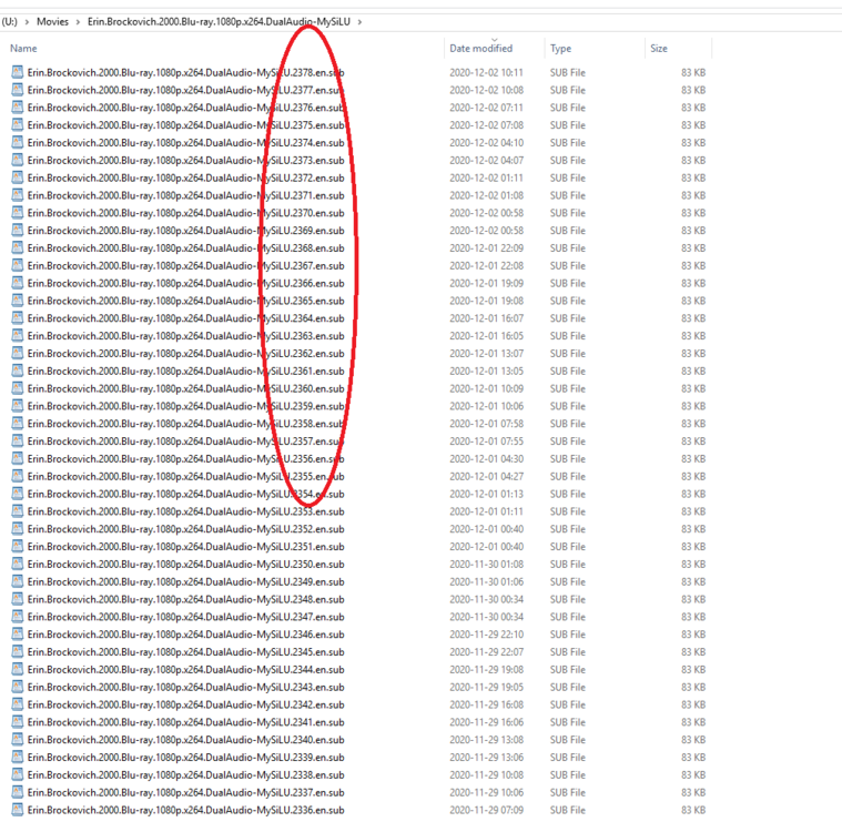

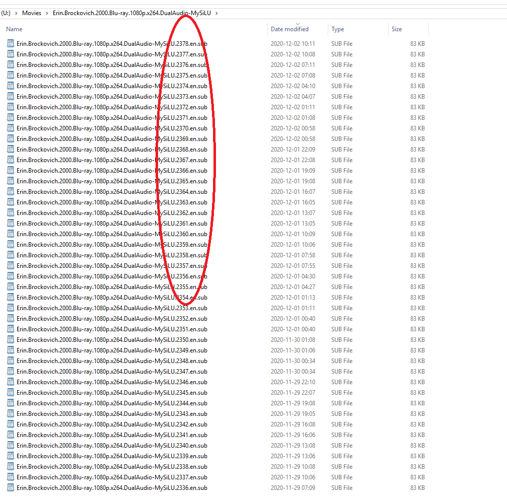

gberg 6 Posted December 2, 2020 Posted December 2, 2020 34 minutes ago, drevokocur said: @Lukehas this been resolved? I'm on 4.5.2.0. and the problem still occurs. thanks No, it's not solved yet, but I've bee told in theis thread it's going to be solved in the next release: But on the other hand I was told it should have been solved in the next release earlier, when it in fact wasn't solved. So we will just have to hope for it to be solved in the upcomming releas whenever it wil come... But this really needs to be solved, I have movies with several thousand of subtilte files, and I atached a image showing that.
