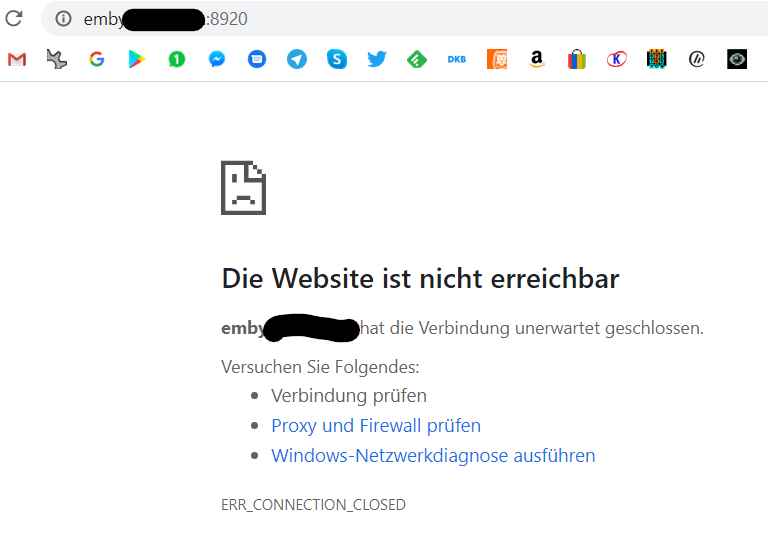

mholin 23 Posted October 20, 2020 Posted October 20, 2020 Hi guys yesterday I did another attempt to get my emby server working over SSL connection. I created letsencrypt certificate and imported PFX file to emby server. This does look fine. On second picture are my router port forwardings. But at the end, when I try to enter https://emby....:8920 there comes an ERR_CONNECTION_CLOSED With http://emby...:8096 everything is working What is my problem here? Any hints?
rbjtech 5337 Posted October 20, 2020 Posted October 20, 2020 (edited) The host has closed the connection - ie traffic has reached the host ok and the return traffic is ok. I would suggest something is wrong with the Certificate. Perhaps a password mismatch, domain name mismatch or incorrect format/chain ? I would create a new Cert, following the guides here. If using Windows - try using 'certutil' to confirm if the certificate is fully valid. Edited October 20, 2020 by rbjtech
mholin 23 Posted October 20, 2020 Author Posted October 20, 2020 ok, I checked with certutil and did not found anything obviously. Anyway, I went through the process of creating a completely new cerfificate and now everything is fine. I'm with SSL now. thanks for your support bye Michael 2
