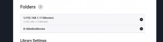

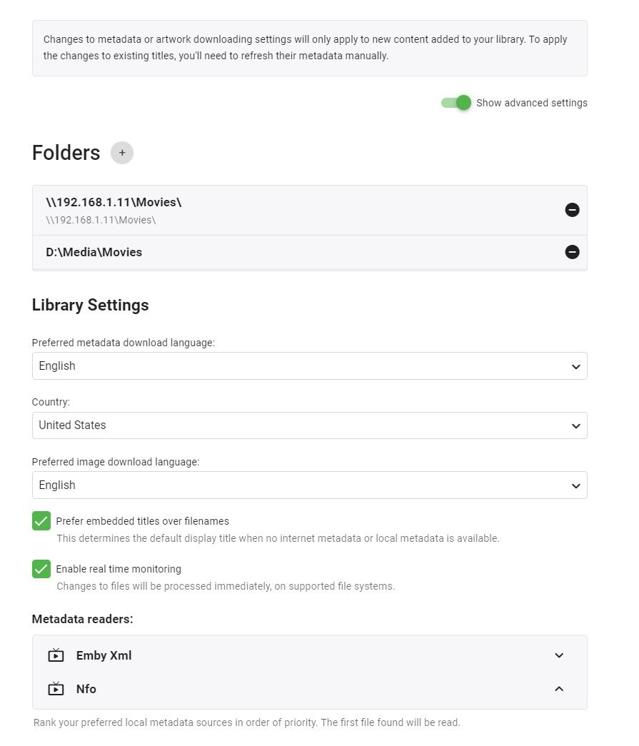

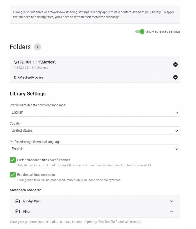

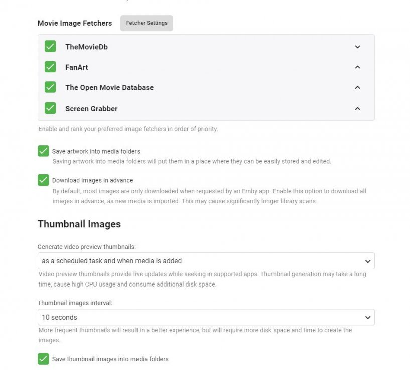

PenkethBoy 2068 Posted October 21, 2020 Posted October 21, 2020 couple of questions 1 are you running emby as a service? 2. in your library(s) setup for movies what paths have you set - screen shots would be best could you do a new log from startup not a restart so i can see the dll loading etc and the watchers beingt turned on for the libraries you have several errors - that need fixing but dont think they relate to the issue - for now you have a lot of plugins loaded - do you need them all? As they take up resources and slow down library scans etc I think i know whats going on but need more info to be sure

edeyzel 0 Posted October 21, 2020 Author Posted October 21, 2020 (edited) 32 minutes ago, PenkethBoy said: i think its his library setup - but want more data first Here you go. Edited October 21, 2020 by edeyzel

PenkethBoy 2068 Posted October 22, 2020 Posted October 22, 2020 remove the \ from the end of the first path and also delete the optional path completely save and run a scan
