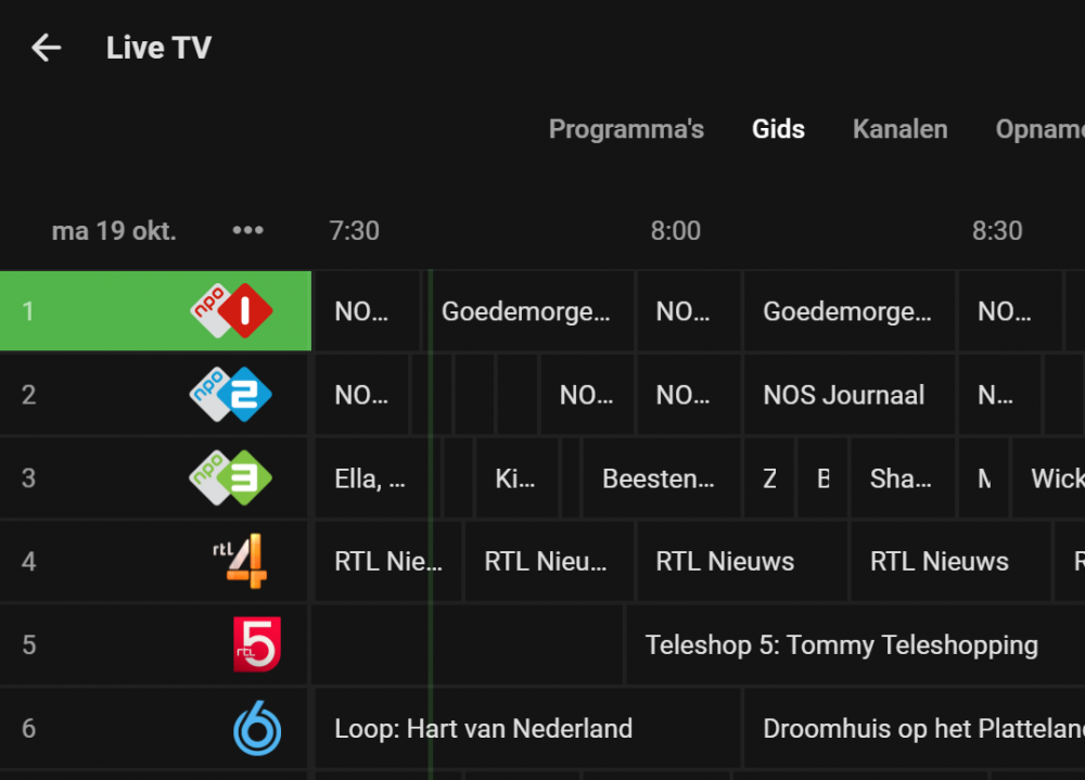

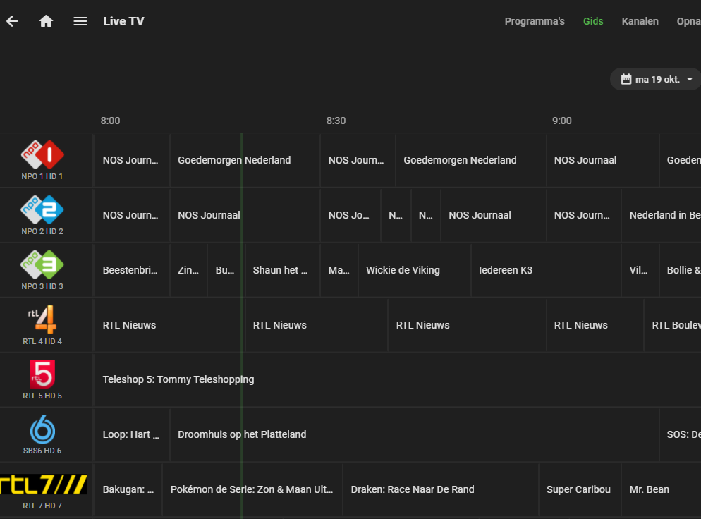

Peter Nent 71 Posted October 19, 2020 Author Posted October 19, 2020 I'm using Emby in different ways. This 10-feet feature request is intended for the 'normal' browser GUI on our 46-inch TV, as the Emby Theater already has such a 10-feet approach (bigger font/characters), but is (in my opinion) not as easy to use as the 'normal' browser Emby GUI. Compare: EMBY-browser (Chrome or Edge Chromium) EMBY-Theater: Notice the bigger font/characters in EMBY-Theater compared with EMBY-browser....
