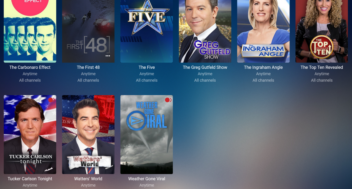

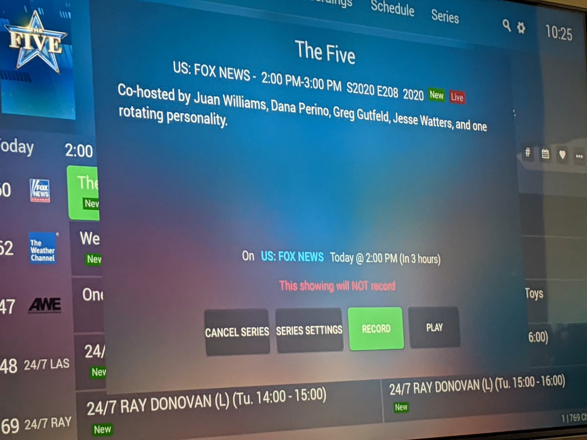

Tony B. 38 Posted October 13, 2020 Posted October 13, 2020 There is a "Will Not Record" on all the programs that I have scheduled to record. It also seems I can't manually schedule anything. I would rather not post logs in a public forum, whomever wants to help me fix this, please post and I'll send you the logs in a PM.
Carlo 4561 Posted October 13, 2020 Posted October 13, 2020 Can you post a picture of what you see regarding the "Will Not Record"?
Tony B. 38 Posted October 13, 2020 Author Posted October 13, 2020 Not really sure why you needed this. I have done 4 guide refreshes, none of them has gotten my series or manual recording to show up. Rebooted the computer, restarted emby, nothing is getting these to show up under scheduled and that also means that nothing is recording anymore.. Not cool.

Carlo 4561 Posted October 14, 2020 Posted October 14, 2020 I'm in the Eastern Time Zone and record most of those same shows and I'm not having an issue with any of them recording other than the fact that some of the shows aren't on right now because of the Amy Coney Barrett Supreme Court Nomination hearings in front of the Senate. @Tony B. what app is that being shown in the picture? Have you tried looking at the recording settings in the web app? Do you get the same problem? Would you be open to a remote session to let me take a look?
Tony B. 38 Posted October 14, 2020 Author Posted October 14, 2020 3 minutes ago, cayars said: I'm in the Eastern Time Zone and record most of those same shows and I'm not having an issue with any of them recording other than the fact that some of the shows aren't on right now because of the Amy Coney Barrett Supreme Court Nomination hearings in front of the Senate. @Tony B. what app is that being shown in the picture? Have you tried looking at the recording settings in the web app? Do you get the same problem? Would you be open to a remote session to let me take a look? That is the Fire stick beta on TV. The bottom screenshot was just off the desktop. Continue by PM if you want to do a remote desktop session. Although, you haven't seen any logs, would that even help figure out why it isn't scheduling it? Or, does it not show you stuff like that?

Luke 42208 Posted October 16, 2020 Posted October 16, 2020 On 10/13/2020 at 1:31 PM, Tony B. said: Not really sure why you needed this. I have done 4 guide refreshes, none of them has gotten my series or manual recording to show up. Rebooted the computer, restarted emby, nothing is getting these to show up under scheduled and that also means that nothing is recording anymore.. Not cool. The option is based on season and episode numbers, so looking at this screenshot, it's season 2020 episode 208. Do you already have that in your library?
Carlo 4561 Posted October 16, 2020 Posted October 16, 2020 It's not just that Luke, but the fact he has 4 Fox News channels in his lineup. So sometimes these recording show up on other channels or may not at all as episodes are missing on some channels. Also on some channels the episodes as messed up due to the duplicate stationIDs in the lineup. Data in the Guide is unreliable due to the lineup and duplicate stations/EPGs.
