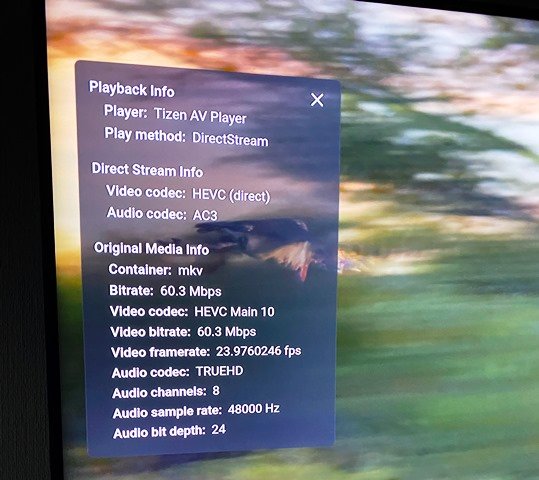

CogyG 3 Posted December 15, 2020 Posted December 15, 2020 Very strange, i can't playblack with AC3, the client crash and reboot. If i select TRUEHD or DTS HD (with another movie) the movies just plays. But on stats for nerds, DirectStream info plays AC3 And is it possible to DirectPlay on wifi (this device is upstairs)? Thanks in advance
SamES 1084 Posted December 15, 2020 Posted December 15, 2020 It's unusual for the app to crash and reboot. Samsung TV's do not support Direct playback of TrueHD and since 2018 do not support DTS either. This is why these tracks are causing the audio track to be encoded. With 4K content DirectStreaming is problematic and you will likely get playback issues. I'm not sure why the client would be crashing. You could try to uninstall the client, power cycle the TV, then reinstall the latest version and check if it still crashes. I think it's important to test your file with the AC3 track to confirm if the subtitle selection issue is the same

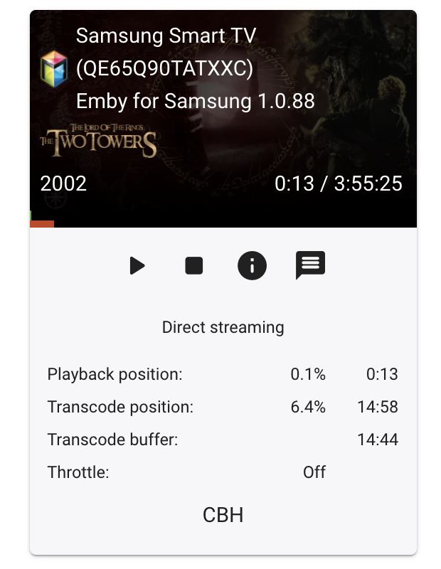

cbh 0 Posted January 1, 2021 Posted January 1, 2021 Hi, Anybody knows where I can download older release for newer samsung tv? Thanks /Claus
cbh 0 Posted January 1, 2021 Posted January 1, 2021 I got the same issue. Any eta for a fix? Thanks /Claus
cbh 0 Posted January 1, 2021 Posted January 1, 2021 19 minutes ago, cbh said: I got the same issue. Any eta for a fix? Thanks /Claus I have two sound tracks in the movie. If I choose "TRUEUD 7.1" audio then it shows the wrong subtitle language If I choose "AC3 5.1" audio then it is show the correct subtitle language. I use an external .srt subtitle file. /Claus
SamES 1084 Posted January 1, 2021 Posted January 1, 2021 Why? Is there an issue with the current release? If you let us know what the problem is we can fix it. Older releases generally won't work as Samsung time limits the beta and it won't install or run for a fixed period after it is created.
SamES 1084 Posted January 1, 2021 Posted January 1, 2021 We can fix the issue for the TrueHD case, it's on my list. However, as TrueHD is not supported and is being converted on the server to AC3 anyway, you will have better performance if you select the exisiting AC3 track as it will avoid transcoding the audio (and the subs issue!)
cbh 0 Posted January 1, 2021 Posted January 1, 2021 Ok. Is the direct streaming then video and not video and audio? Do you have en ETA on the fix? Thanks /Claus
cbh 0 Posted January 1, 2021 Posted January 1, 2021 I thought a subtitle issues could be solved with an older release. But I tried, but it have the same issue. I replied in another post regarding the subtitle issue. Thanks
FrostByte 5453 Posted January 1, 2021 Posted January 1, 2021 Direct Streaming is almost always when audio only is converted to something the Samsung TV supports and the video part is unconverted and sent as is. If you display Stats for Nerds within the Samsung app it should tell you what is being converted and why As SamES pointed out you will get best results by selecting an audio codec which the TV supports before clicking Play. Since TrueHD isn't listed in the chart below and AC3 is then just select the AC3 beforehand. Either way you will be getting AC3 in the end https://developer.samsung.com/smarttv/develop/specifications/media-specifications/2020-tv-video-specifications.html#20TV_PREMIUM(UHD)
