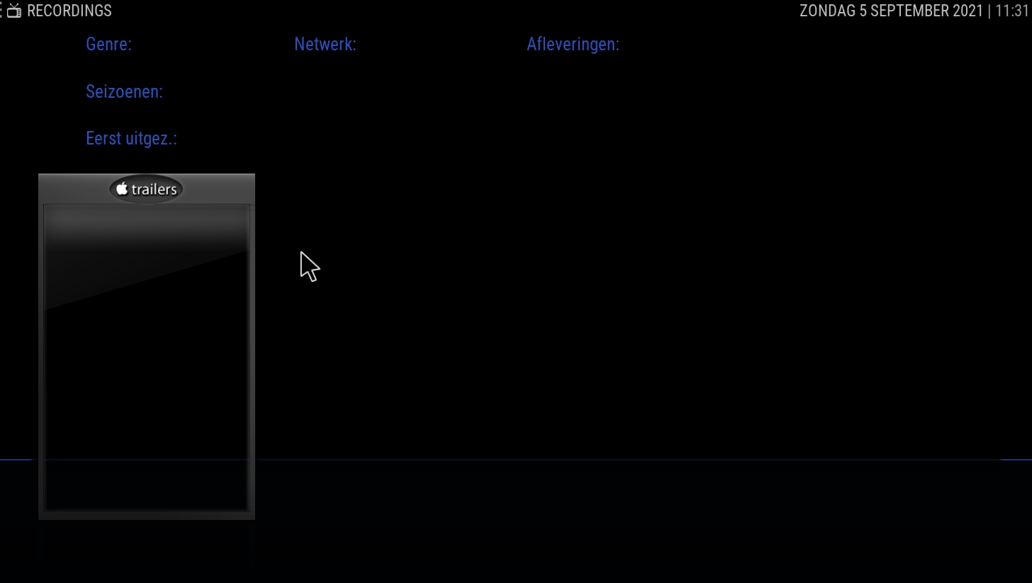

heula 192 Posted September 5, 2021 Posted September 5, 2021 17 hours ago, quickmic said: New version available: delta changelog: - improve progress updates - redesign sync - fix trakt issue - fix invalid content sync Actually, there are many changes under the hood, and it's a more experimentalish version as the previous ones. Also a complete db reset is mandatory. Please just update the plugin, the DB reset should be triggered automatically (also improvements there and it's part of the test). Progress updates (from emby to Kodi) should now be instant without any possible overhead. I'm still not 100% happy with progress updates from Kodi to emby server. I'm still working on it, but it's tricky. I try to migrate as many as possible commands/updates from http queries to websocket queries (Kodi -> Emby). (Emby -> Kodi) is already using this approach since ever, but there were many unnecessary (kodi) DB queries involved. I removed all of them to a bare minimum. Actually this is were the performance upgrades came from. Also the sync should be a little faster than before. @heula Please try this version, I hope it fixes the recording issues too. Installed the new version and after the database reset not much has changed when Kodi is open while recording and or recordings has finisht. Tested with 4 recordings and they are all visible within Emby but not in Kodi while open. Nothing appears in Kodi and I have waited about 90 minutes or so. kodi.log embyserver.txt

heula 192 Posted September 5, 2021 Posted September 5, 2021 After restarting Kodi also nothing happens, the new recorded shows are not appearing. kodi.log

heula 192 Posted September 5, 2021 Posted September 5, 2021 After a library repair the shows do appear but they are all empty again. kodi.log

quickmic 1709 Posted September 5, 2021 Author Posted September 5, 2021 (edited) 6 hours ago, heula said: After a library repair the shows do appear but they are all empty again. kodi.log 239.37 kB · 1 download I've send you a test version. I hope it fixes the issue. btw, it has nothing todo with recording. The problem is, the seasoninfo is empty on recorded files. Actually this could happen anywhere not only on recordings. Now it's added season "0" if no info received by Emby server. Season "0" is usually the indicator for "Specials" in TV shows. Edited September 5, 2021 by quickmic 1
