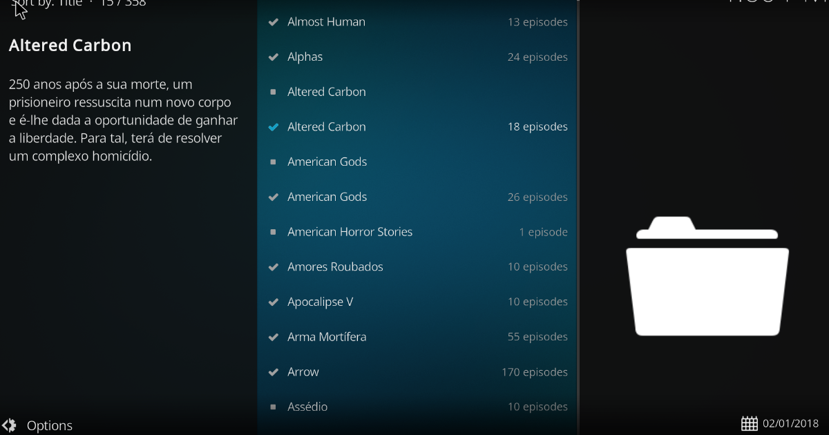

wanderjarra 18 Posted July 18, 2021 Posted July 18, 2021 Good afternoon, now the scenario has changed. My series can be loaded even if on a different disk and join all seasons, but he creates 2 names for each series in this way. The first one has the correct logo and image, but inside it is empty without the seasons, the other one has no logo or image and contains the episodes correctly. This has already been reported or is it on the list to be fixed ??? Do you need the log of my files to check something? I am available to help in whatever you need, thank you in advance.

LichenKing 17 Posted July 18, 2021 Posted July 18, 2021 @wanderjarra If you are using the experimental builds did you do a Kodi Local DB Reset. I have a feeling there was a change in data that did not delete the old entries.
wanderjarra 18 Posted July 19, 2021 Posted July 19, 2021 Yes, it's always the latest version and always resetting the old database.

quickmic 1709 Posted July 19, 2021 Author Posted July 19, 2021 12 hours ago, wanderjarra said: Good afternoon, now the scenario has changed. My series can be loaded even if on a different disk and join all seasons, but he creates 2 names for each series in this way. The first one has the correct logo and image, but inside it is empty without the seasons, the other one has no logo or image and contains the episodes correctly. This has already been reported or is it on the list to be fixed ??? Do you need the log of my files to check something? I am available to help in whatever you need, thank you in advance. A similar issue was reported yes. Cau you confirm the affected TV-Shows are distributed over several folders on Emby server? e.g. c:\TVShows\Season1 d:\TVShows\Season2 ...and they are merged on Emby server?
