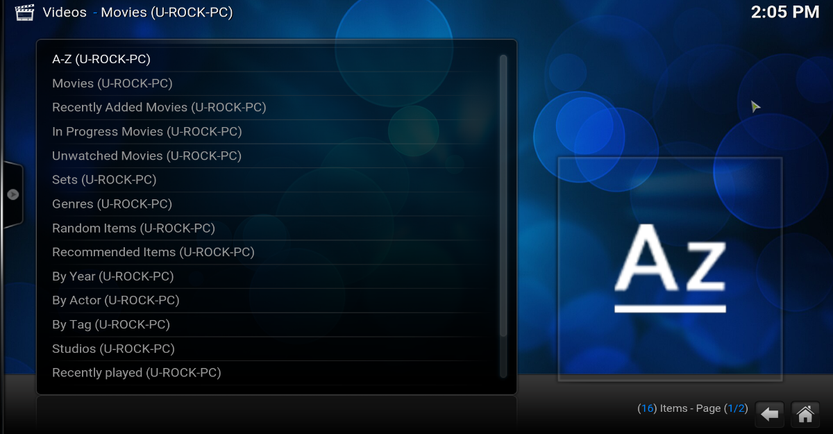

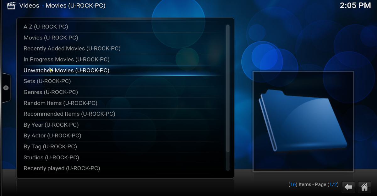

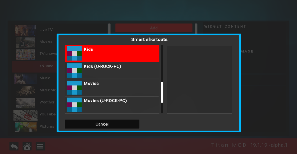

t123thomas 63 Posted April 14, 2021 Posted April 14, 2021 (edited) Hi Quicmic, The new apparoach to Nope with server name have caused the submenu to not display in the Titan skin, will this approach be permernet on a going forward if so, what changes do I need to make in the skin and where as I have to pass the info to the developer of Titan skin. Thanks Edited April 14, 2021 by t123thomas

quickmic 1709 Posted April 15, 2021 Author Posted April 15, 2021 11 hours ago, t123thomas said: Hi Quicmic, The new apparoach to Nope with server name have caused the submenu to not display in the Titan skin, will this approach be permernet on a going forward if so, what changes do I need to make in the skin and where as I have to pass the info to the developer of Titan skin. Thanks Please hold on, I'm still working on the nodes and it will change once again in the next release. Let's go from there..

t123thomas 63 Posted April 19, 2021 Posted April 19, 2021 On 4/14/2021 at 2:39 PM, t123thomas said: Hi Quicmic, The new apparoach to Nope with server name have caused the submenu to not display in the Titan skin, will this approach be permernet on a going forward if so, what changes do I need to make in the skin and where as I have to pass the info to the developer of Titan skin. Thanks Any update on this issue?
quickmic 1709 Posted April 20, 2021 Author Posted April 20, 2021 10 hours ago, t123thomas said: Any update on this issue? No, I'm still working on a new version and will release it in the next days. 1
