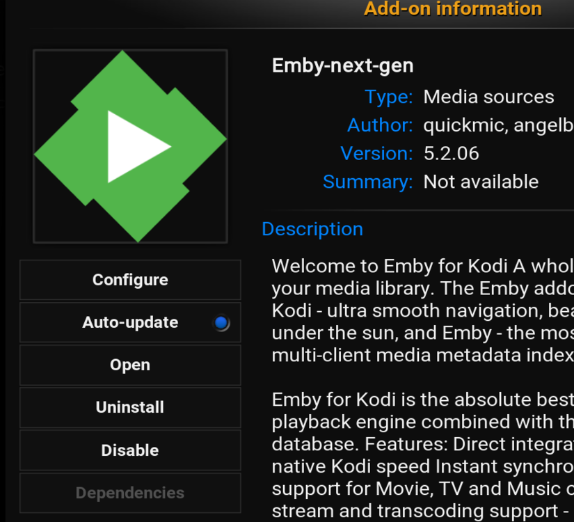

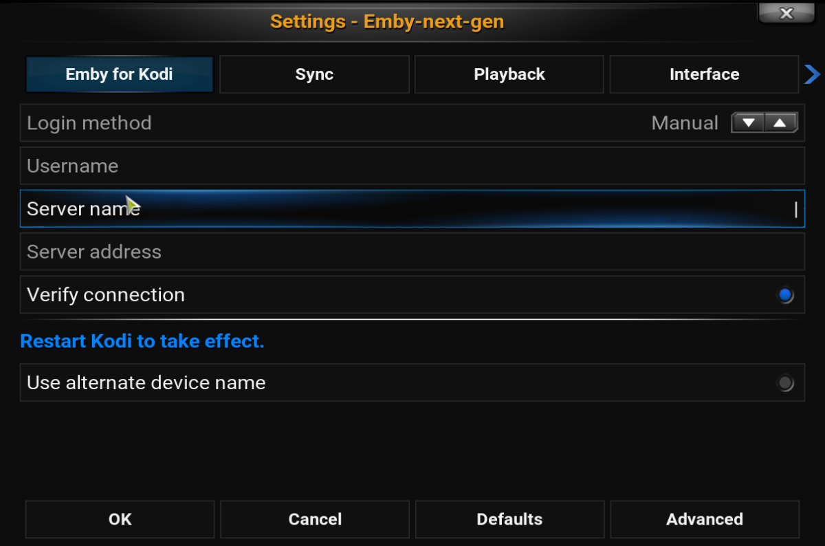

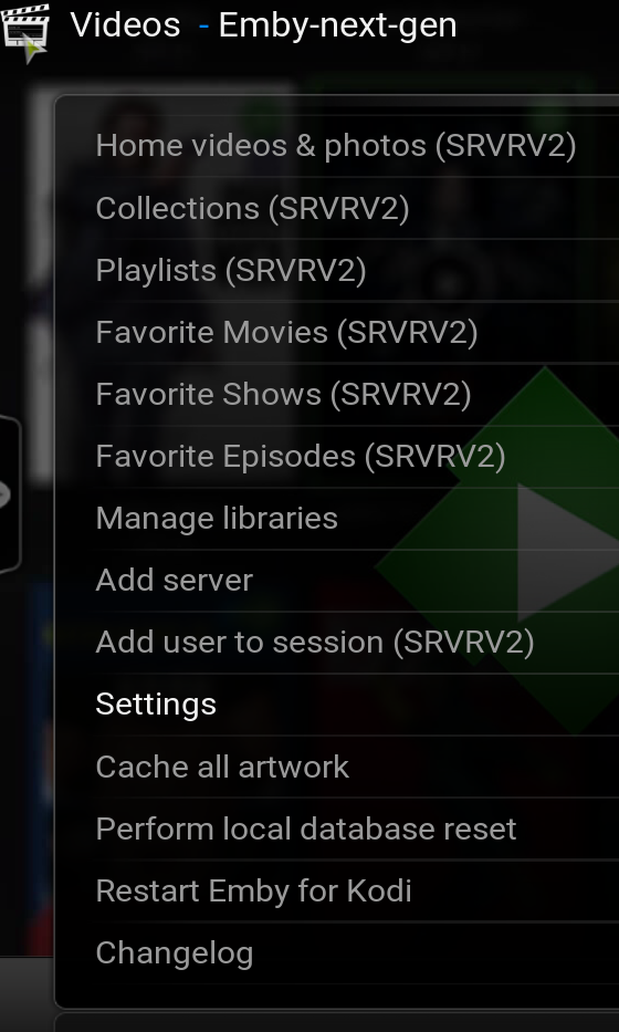

CharleyVarrick 284 Posted March 27, 2021 Posted March 27, 2021 14 hours ago, djhifi said: EDIT: I cannot seem to access "Settings" (of E4K) in .06. I click and nothing happens. quickmic already acknowledge Settings button unresponsive and already commited to have a look/fix. Workaround is instead of going to Settings from this path (1st pic), go for addon info/configure (2nd pic) 1

CharleyVarrick 284 Posted March 28, 2021 Posted March 28, 2021 (edited) Hi quickmic, speaking of unresponsive Settings (see my own self quote further below), I just noticed that while the workaround does get us in settings, something is odd within E4K tab (ps I would rather call it connection tab). It does not seem to cause me any issue, but I'm pretty sure it used to display my username, server name and maybe server address too. Yet when I fire up kodi, it connects just fine without asking to login, no error, all good, but I find it odd that connection tab is all blank fields. Please advise 22 hours ago, CharleyVarrick said: quickmic already acknowledge Settings button unresponsive and already commited to have a look/fix. Workaround is instead of going to Settings from this path (1st pic), go for addon info/configure (2nd pic) Edited March 28, 2021 by CharleyVarrick 1
quickmic 1709 Posted March 28, 2021 Author Posted March 28, 2021 12 hours ago, dodewill76 said: Hi I have just done a clean install of Kodi Matrix RC1 and installed version 5.2.05. After installing the Emby for Kodi Plugin the system asks me to connect to my Emby server, which works fine. It then shows me the list of users setup on my Emby server. However, when I click on one of them to sign in the plugin wont allow me to sign in. Instead it takes me back to the available users page. I have to manually login by typing in the username and password, even though my Emby server is setup "dont require a password on the local network". Is there a setting I am missing in kodi matrix that is causing this issue? Will be fixed in next version
quickmic 1709 Posted March 28, 2021 Author Posted March 28, 2021 28 minutes ago, CharleyVarrick said: Hi quickmic, speaking of unresponsive Settings (see my own self quote further below), I just noticed that while the workaround does get us in settings, something is odd within E4K tab (ps I would rather call it connection tab). It does not seem to cause me any issue, but I'm pretty sure it used to display my username, server name and maybe server address too. Yet I fire up kodi it it connects just fine without asking to login, no error, all good, but I find it odd that connection tab is all blank fields. Please advise I'm working on it, actually there are some other issues in the connection settings/config menu. 1
