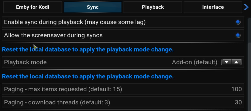

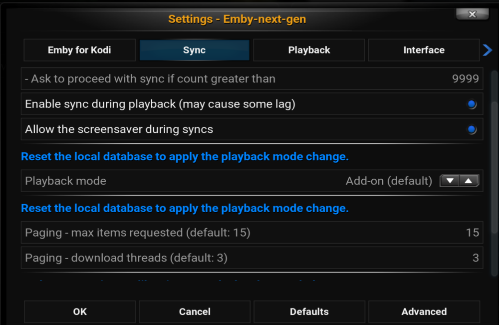

quickmic 1709 Posted March 26, 2021 Author Posted March 26, 2021 Performance hint: Increase in plugin option -> sync: Paging max items. I use 100 Increase in plugin option -> sync: Paging download threads. I use 30 The default values are ridiculously low. I'll change the default values by next version 3

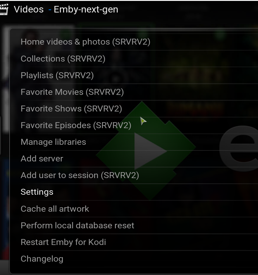

quickmic 1709 Posted March 26, 2021 Author Posted March 26, 2021 2 minutes ago, CharleyVarrick said: I just updated to last experimental and report an issue, Settings is unresponsive ( I can't get in) Thanks, confirmed. That's a bug, I'll fix it. You can still access the settings via plugin -> configuration, It's exactly the same 1

CharleyVarrick 284 Posted March 26, 2021 Posted March 26, 2021 (edited) I dont need to click on Kodi to open it anymore, I just look at the desktop shortcut and it opens. What do those 2 settings actually do, I blindly follow whatever you said but how/where would I notice a difference? Edited March 26, 2021 by CharleyVarrick 1
quickmic 1709 Posted March 26, 2021 Author Posted March 26, 2021 (edited) 11 minutes ago, CharleyVarrick said: I dont need to click on Kodi to open it anymore, I just look at the desktop shortcut and it opens. What do those 2 settings actually do, I blindly follow whatever you said but how/where would I notice a difference? Paging settings are addressing simultaneous background threads and number of downloads. Download threads = simultaneous workers (threads) max items = Number of items pushed from Emby server per query. e.g. 1000 items to be synced, it's splits 1000 items into 100 items each Edited March 26, 2021 by quickmic 2

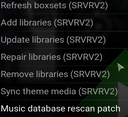

CharleyVarrick 284 Posted March 26, 2021 Posted March 26, 2021 Thanks. One other question, if I may, about emby next gen/manage libraries What is the difference between Update and Repair libraries ? Ever since those existed, I never tried Repair.
quickmic 1709 Posted March 26, 2021 Author Posted March 26, 2021 (edited) Repair: Same as manually: remove lib followed by add lib Update: Keeps lib, just queries all lib-items from Emby server for refresh. Difference: If invalid recordsets already in the Kodi DB, an update will not fix it. It just adds new/changed content. Edited March 26, 2021 by quickmic 1
