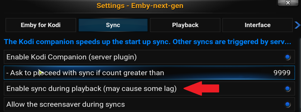

CharleyVarrick 284 Posted March 22, 2021 Posted March 22, 2021 (edited) I am surprised this never being mentionned. Speaking of which, wasnt there an option in there (some time ago) to display progress bar if update count greater than 10 or something? Edited March 22, 2021 by CharleyVarrick

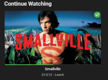

tube82 73 Posted March 22, 2021 Posted March 22, 2021 I am experiencing a minor issue with the current version regarding the update of watch progress. If I start a video in Kodi and pause it midway through, it correctly appears in the "Continue Watching" section in Emby web interface, but when I then finish watching it in Kodi, progress is not correctly updated in Emby. It is marked as watched as expected, but it remains under "Continue Watching" and with the progress it had when it was first paused. It then looks like this: 1
quickmic 1709 Posted March 22, 2021 Author Posted March 22, 2021 New version released (page 1 of this thread). It fixes two issues. -(realtime) update season sync -remove items on sync 1
quickmic 1709 Posted March 22, 2021 Author Posted March 22, 2021 44 minutes ago, tube82 said: I am experiencing a minor issue with the current version regarding the update of watch progress. If I start a video in Kodi and pause it midway through, it correctly appears in the "Continue Watching" section in Emby web interface, but when I then finish watching it in Kodi, progress is not correctly updated in Emby. It is marked as watched as expected, but it remains under "Continue Watching" and with the progress it had when it was first paused. It then looks like this: Thanks for reporting, not sure if this is a Emby server issue or a plugin issue. Can you please test with Emby app? If it shows the same behavior, probably a server issue.
tube82 73 Posted March 22, 2021 Posted March 22, 2021 10 minutes ago, quickmic said: Thanks for reporting, not sure if this is a Emby server issue or a plugin issue. Can you please test with Emby app? If it shows the same behavior, probably a server issue. Just tried with Emby Android app. Could not reproduce the behavior. Episode disappeared from "Continue Watching" section correctly. 1
quickmic 1709 Posted March 22, 2021 Author Posted March 22, 2021 (edited) ok, I'll have a look. (put on the list) Edited March 22, 2021 by quickmic

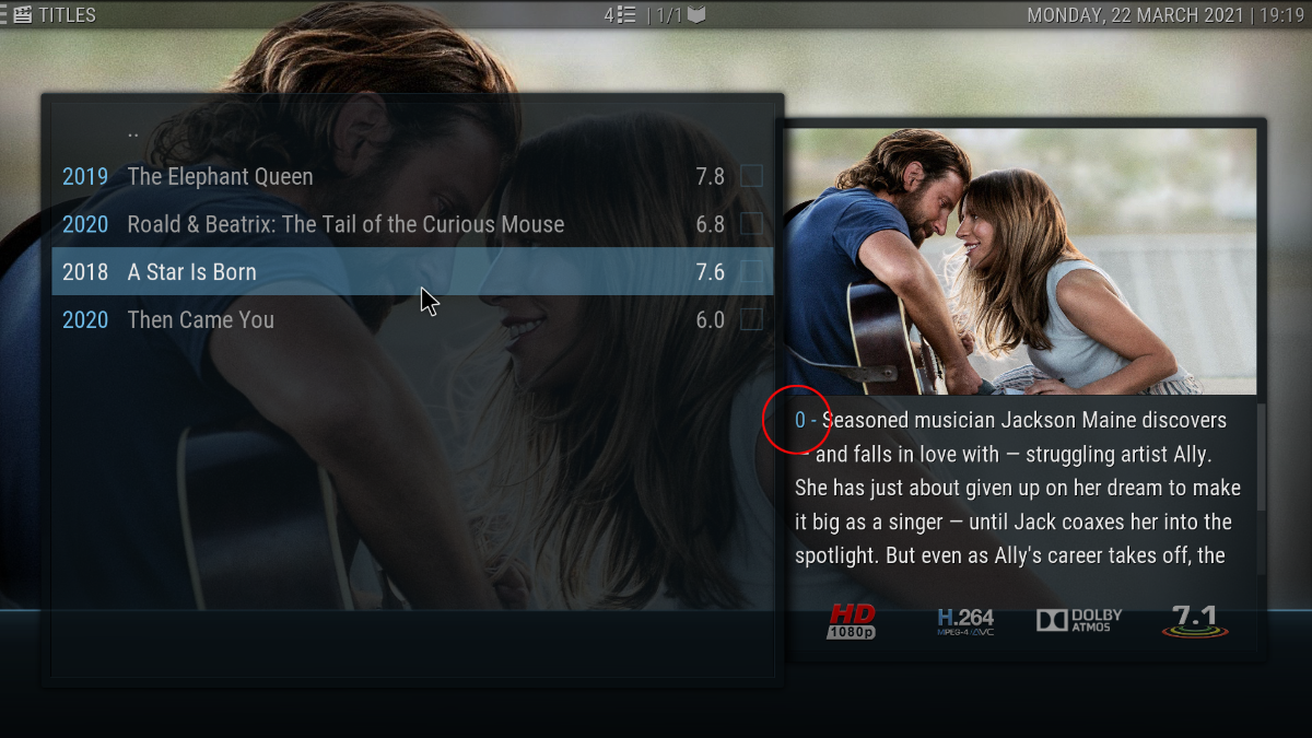

BaukeZwart 94 Posted March 22, 2021 Posted March 22, 2021 I noticed a cosmetic issue. When there is no tagline “0 –“ is shown in the movie plot field. This is also the case when using the Kodi default Estuary Skin. I never noticed this before, can this be E4K related?
djhifi 56 Posted March 22, 2021 Posted March 22, 2021 (edited) I'm using 5.2.02 and sometimes incremental syncs simply stop mid-sync. Like, forever. Nothing throwed in the logs. Only fix is quitting KODI and starting it back. Incremental sync starts from 0 again, but eventually gets over the previous % where it stopped and completes successfully. Edited March 22, 2021 by djhifi
quickmic 1709 Posted March 22, 2021 Author Posted March 22, 2021 (edited) @BaukeZwart Some other users mentioned that as well. How do you access this information? Edited March 22, 2021 by quickmic

djhifi 56 Posted March 22, 2021 Posted March 22, 2021 7 minutes ago, BaukeZwart said: I noticed a cosmetic issue. When there is no tagline “0 –“ is shown in the movie plot field. This is also the case when using the Kodi default Estuary Skin. I never noticed this before, can this be E4K related? I noticed that zero yesteday too, but not in there, on main menu widgets, if I'm over a movie. It's in the place of "unwatched" (episode number). But I think its skin related, I'm using the same skin as you: AEON Nox: SiLVO Report it there for us please
quickmic 1709 Posted March 22, 2021 Author Posted March 22, 2021 Just now, djhifi said: Sorry what do you mean by "how do you access this information" ? This was an answer addressing @BaukeZwart You posted too fast
