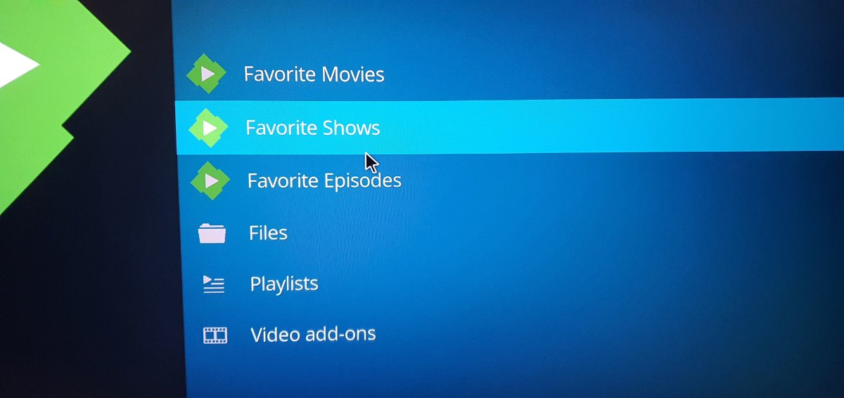

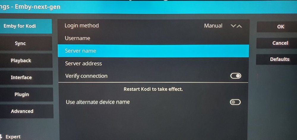

Gofran 6 Posted March 19, 2021 Posted March 19, 2021 (edited) Thank you for the reply i did that i loged in but when i want to add tv show or somthing i only see picture in the begining i could only choose user than servername than see second picture mine tvshow are not there when checking I did not add mine server 1 picture Edited March 19, 2021 by Gofran

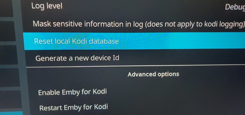

quickmic 1709 Posted March 19, 2021 Author Posted March 19, 2021 (edited) Hmm, this seems you are not logged in at all. Have you used emby-next gen before? If not (and I assume you have a backup!!!): Reset all settings (THIS WILL WIPE ALL DATA AND REQUIRES A KODI DB REBUILD (not emby Server DB)): plugin -> configuration -> Advanced -> "Reset local Kodi database" and answer all questions with yes. The rest should be guided. Edited March 19, 2021 by quickmic
Gofran 6 Posted March 19, 2021 Posted March 19, 2021 It does nothing for me is it maybe because i am on beta test of emby itself
Gofran 6 Posted March 19, 2021 Posted March 19, 2021 So when i click this it goes away but no question like yes or no just to front of kodi
quickmic 1709 Posted March 19, 2021 Author Posted March 19, 2021 ok, then try: shutdown Kodi (important!): Don't do it while running delete the content of this folder (completely), but keep the folder: /home/USERNAME/.kodi/userdata/addon_data/plugin.video.emby-next-gen/ on libreelec it's: /storage/.kodi/userdata/addon_data/plugin.video.emby-next-gen/ restart Kodi:

quickmic 1709 Posted March 19, 2021 Author Posted March 19, 2021 (edited) 1 hour ago, Gofran said: Ok Info for other users: The issue was Emby server reported the wrong IP to Kodi. This can happen if you run the Emby server behind NAT. In this case it was a docker container using internally 10.X.X.X subnet and was accessible from outside via 192.X.X.X. In similar cases you MUST set the external IP address in Emby server settings! Edited March 19, 2021 by quickmic 1
