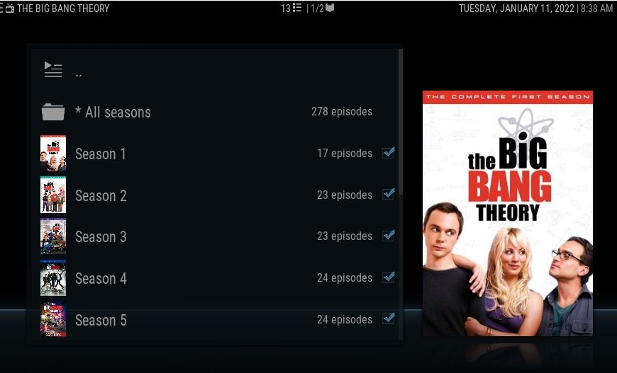

Guest worthington_j Posted January 11, 2022 Posted January 11, 2022 (edited) 43 minutes ago, embyL0VER said: I can not reproduce worthington_j's Problem. In the embuary skin, artwork for tv shows are like they should be. But there is no listview for seasons, there is only a listview for all tv shows and there posters will show like they should. I'm using the Aeon Nox Silvo skin and not Embuary. Attached is a picture of what I see. Below is a screenshot of the way it should look and what I see in 6.2.4. Edited January 11, 2022 by worthington_j
quickmic 1709 Posted January 11, 2022 Author Posted January 11, 2022 5 minutes ago, worthington_j said: I'm using the Aeon Nox Silvo skin and not Embuary. Attached is a picture of what I see. Below is a screenshot of the way it should look and what I see in 6.2.4. Looks good, is this after downgrade to 6.2.4? Do you know what is shown? I mean Kodi type of the image.
Guest worthington_j Posted January 11, 2022 Posted January 11, 2022 13 minutes ago, quickmic said: Looks good, is this after downgrade to 6.2.4? Do you know what is shown? I mean Kodi type of the image. Downgrading does not resolve the issue. It has to do with the version used during the scan of the show. I went from 5.x to 6.2.5 which caused a DB reset when I found this issue. After downgrading to 6.2.4 and performing another DB reset the images displayed correctly. If I install 6.2.4 > Scan in my library > Upgrade to 6.2.5 the display is correct, but I'm assuming anything new I scan in will be incorrect.

Guest worthington_j Posted January 11, 2022 Posted January 11, 2022 (edited) 12 minutes ago, quickmic said: You uploaded 2 screenshots. Both looks correct. The screenshot below displays the show when it was scanned it with 2.6.5. As you can see I have circled the season folder that display the shows fanart vs using the season folders. The next screenshot is with the show scanned it with 6.2.4. You can see where I circled the season folders displaying the season poster and NOT the fanart. This is the display I have always seen in the past and I believe to be correct. Edited January 11, 2022 by worthington_j
quickmic 1709 Posted January 11, 2022 Author Posted January 11, 2022 4 minutes ago, worthington_j said: The screenshot below displays the show when it was scanned it with 2.6.5. As you can see I have circled the season folder that display the shows fanart vs using the season folders. The next screenshot is with the show scanned it with 6.2.4. You can see where I circled the season folders displaying the season poster and NOT the fanart. This is the display I have always seen in the past and I believe to be correct. Ahhhhh this one, I thought the season picture on the right side is wrong. I'll check it.
quickmic 1709 Posted January 11, 2022 Author Posted January 11, 2022 @embyL0VER and @worthington_j Now we are circling back. Aeon Nox Silvo skin shows thumbs on the left side. Obviously worthington_j has none and fallback is used. As mentioned priority in case of missing thumb is currently 1.thumb 2.fanart 3.poster Obviously worthington_j wants: 1.thumb 2.poster 3.fanart @worthington_j Emby server is capable to load the thumbs for almost all popular TVShows. Big Bang Theory is a good example. I have all thumbs available on my server (and synced to Kodi), so you can consider loading them. It's not a actual fix for the request, but at least it helps.

quickmic 1709 Posted January 11, 2022 Author Posted January 11, 2022 One more thought. Kodi/artwork "standard" "defines" fallbacks (also) on aspect ratios. thumb is usually landscape, posters are portrait. So it's probably not a good idea to use a portrait image as a fallback for landscape. This "breaks" other skins.
quickmic 1709 Posted January 11, 2022 Author Posted January 11, 2022 1 minute ago, worthington_j said: I use -thumbs for the episodes but not for the season folders. In the past for the Season01 folder it would always display the season01-poster.jpg, it didn't matter if I was using Emby/Jellyfin/Kodi. Frankly, there is no perfect solution and I cannot fix every skin inconsistencies. Please discuss this with each other and just let me know what you want. I'm out here.
