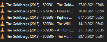

tube82 73 Posted October 29, 2021 Posted October 29, 2021 Using 6.1.5 I have a problem with episodes that are only partially deleted. Scenario is more of a corner case I guess: An episode is added to Emby and later upgraded to a higher quality version, meaning the same episode is added, deleted and re-added. Possibly all before Emby for Kodi knows of the first version because the client was offline the whole time. On Emby server everything is fine, but in Kodi this results in a duplicate of the episode that has no fanart and is a dead link. This problem is rather new. Not sure if it only appeared with 6.1.5 or a little sooner. It hasn't been long, though.
quickmic 1709 Posted October 30, 2021 Author Posted October 30, 2021 (edited) 10 hours ago, tube82 said: Using 6.1.5 I have a problem with episodes that are only partially deleted. Scenario is more of a corner case I guess: An episode is added to Emby and later upgraded to a higher quality version, meaning the same episode is added, deleted and re-added. Possibly all before Emby for Kodi knows of the first version because the client was offline the whole time. On Emby server everything is fine, but in Kodi this results in a duplicate of the episode that has no fanart and is a dead link. This problem is rather new. Not sure if it only appeared with 6.1.5 or a little sooner. It hasn't been long, though. Currently I cannot reproduce the issue but in theory it's a removal before added issue. The sync queues are staggered which means: Delete Items -> Update Items -> Progress update items If Emby server reports: 2 new/updated items and 1 removed (the one removed is one of the new items), situation as follows: 1.task remove -> item not found 2.update/add item -> 2 new items (one invalid, cause was removed from Emby server, but not found by plugin in removal task) As mentioned, this is theory, cause my Emby server doesn't report 2 new items. It reports one even if: 1. item added -> sync Emby server, 2. rename item -> sync server 3. Start Kodi btw, I don't think is is a new problem. If my assumption is correct, this was always the case. I try to design a test case, but yours in not reproducible. Edited October 30, 2021 by quickmic
quickmic 1709 Posted October 30, 2021 Author Posted October 30, 2021 Probably you have folders removed -> different case. When it comes to edge cases, I need really exact instructions what you have done. Probably post the folder structure before and after.
tube82 73 Posted October 30, 2021 Posted October 30, 2021 (edited) 3 hours ago, quickmic said: Probably you have folders removed -> different case. When it comes to edge cases, I need really exact instructions what you have done. Probably post the folder structure before and after. I don't think it has to do with folders. The two most recent occurences were with single episodes in an existing folder. This is what it looks like in Kodi: Season 9 folder has existed since September: Episode 6 was added and replaced on Emby server in the same night, so Kodi was probably not running at that time. Emby log shows: 2021-10-28 03:09:45.684 Info LibraryMonitor: Season 9 (/video/TV Shows/The Goldbergs (2013)/Season 9) will be refreshed. 2021-10-28 03:09:45.781 Info MediaProbeManager: ProcessRun 'ffprobe' Execute: /bin/ffprobe -i file:"/video/TV Shows/The Goldbergs (2013)/Season 9/The Goldbergs (2013) - S09E06 - The Hunt for the Great Albino Pumpkin [HDTV-720p][AC3 5.1][x264].mkv" -threads 0 -v info -print_format json -show_streams -show_chapters -show_format -show_data 2021-10-28 03:09:45.892 Info MediaProbeManager: ProcessRun 'ffprobe' Process exited with code 0 2021-10-28 06:46:51.893 Info LibraryMonitor: Season 9 (/video/TV Shows/The Goldbergs (2013)/Season 9) will be refreshed. 2021-10-28 06:46:51.968 Info App: Removing item from database, Type: Episode, Name: The Hunt for the Great Albino Pumpkin, Path: /video/TV Shows/The Goldbergs (2013)/Season 9/The Goldbergs (2013) - S09E06 - The Hunt for the Great Albino Pumpkin [HDTV-720p][AC3 5.1][x264].mkv, Id: 189257 2021-10-28 06:46:51.968 Info App: Deleting path /config/metadata/library/07/073d540874680116afa5e4a48c65a380 2021-10-28 06:46:52.117 Info MediaProbeManager: ProcessRun 'ffprobe' Execute: /bin/ffprobe -i file:"/video/TV Shows/The Goldbergs (2013)/Season 9/The Goldbergs (2013) - S09E06 - The Hunt for the Great Albino Pumpkin [WEBDL-720p][EAC3 5.1][h264].mkv" -threads 0 -v info -print_format json -show_streams -show_chapters -show_format -show_data 2021-10-28 06:46:52.241 Info MediaProbeManager: ProcessRun 'ffprobe' Process exited with code 0 I am certain this is a new problem because this procedure happens all the time on my server and I never had a problem like this before. Edited October 30, 2021 by tube82
quickmic 1709 Posted October 30, 2021 Author Posted October 30, 2021 4 hours ago, tube82 said: I don't think it has to do with folders. The two most recent occurences were with single episodes in an existing folder. This is what it looks like in Kodi: Season 9 folder has existed since September: Episode 6 was added and replaced on Emby server in the same night, so Kodi was probably not running at that time. Emby log shows: 2021-10-28 03:09:45.684 Info LibraryMonitor: Season 9 (/video/TV Shows/The Goldbergs (2013)/Season 9) will be refreshed. 2021-10-28 03:09:45.781 Info MediaProbeManager: ProcessRun 'ffprobe' Execute: /bin/ffprobe -i file:"/video/TV Shows/The Goldbergs (2013)/Season 9/The Goldbergs (2013) - S09E06 - The Hunt for the Great Albino Pumpkin [HDTV-720p][AC3 5.1][x264].mkv" -threads 0 -v info -print_format json -show_streams -show_chapters -show_format -show_data 2021-10-28 03:09:45.892 Info MediaProbeManager: ProcessRun 'ffprobe' Process exited with code 0 2021-10-28 06:46:51.893 Info LibraryMonitor: Season 9 (/video/TV Shows/The Goldbergs (2013)/Season 9) will be refreshed. 2021-10-28 06:46:51.968 Info App: Removing item from database, Type: Episode, Name: The Hunt for the Great Albino Pumpkin, Path: /video/TV Shows/The Goldbergs (2013)/Season 9/The Goldbergs (2013) - S09E06 - The Hunt for the Great Albino Pumpkin [HDTV-720p][AC3 5.1][x264].mkv, Id: 189257 2021-10-28 06:46:51.968 Info App: Deleting path /config/metadata/library/07/073d540874680116afa5e4a48c65a380 2021-10-28 06:46:52.117 Info MediaProbeManager: ProcessRun 'ffprobe' Execute: /bin/ffprobe -i file:"/video/TV Shows/The Goldbergs (2013)/Season 9/The Goldbergs (2013) - S09E06 - The Hunt for the Great Albino Pumpkin [WEBDL-720p][EAC3 5.1][h264].mkv" -threads 0 -v info -print_format json -show_streams -show_chapters -show_format -show_data 2021-10-28 06:46:52.241 Info MediaProbeManager: ProcessRun 'ffprobe' Process exited with code 0 I am certain this is a new problem because this procedure happens all the time on my server and I never had a problem like this before. I've send you a test version. You must repair sync all TVShows or reset your complete db. It should fix an edge case with inconsistent season information which could result in double episodes. Not sure if this is fixes your problem, but it was the only issue I found. 1
