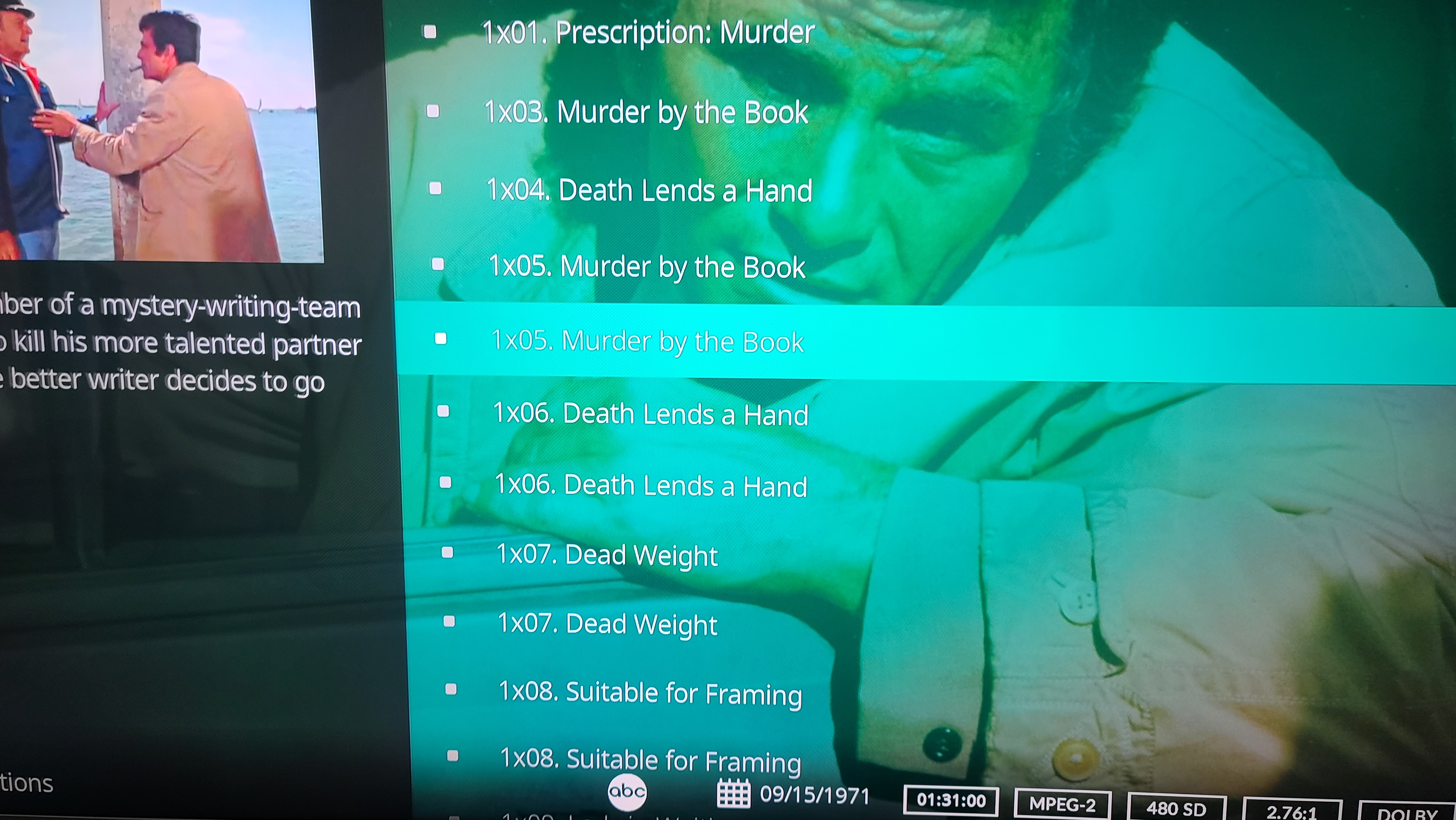

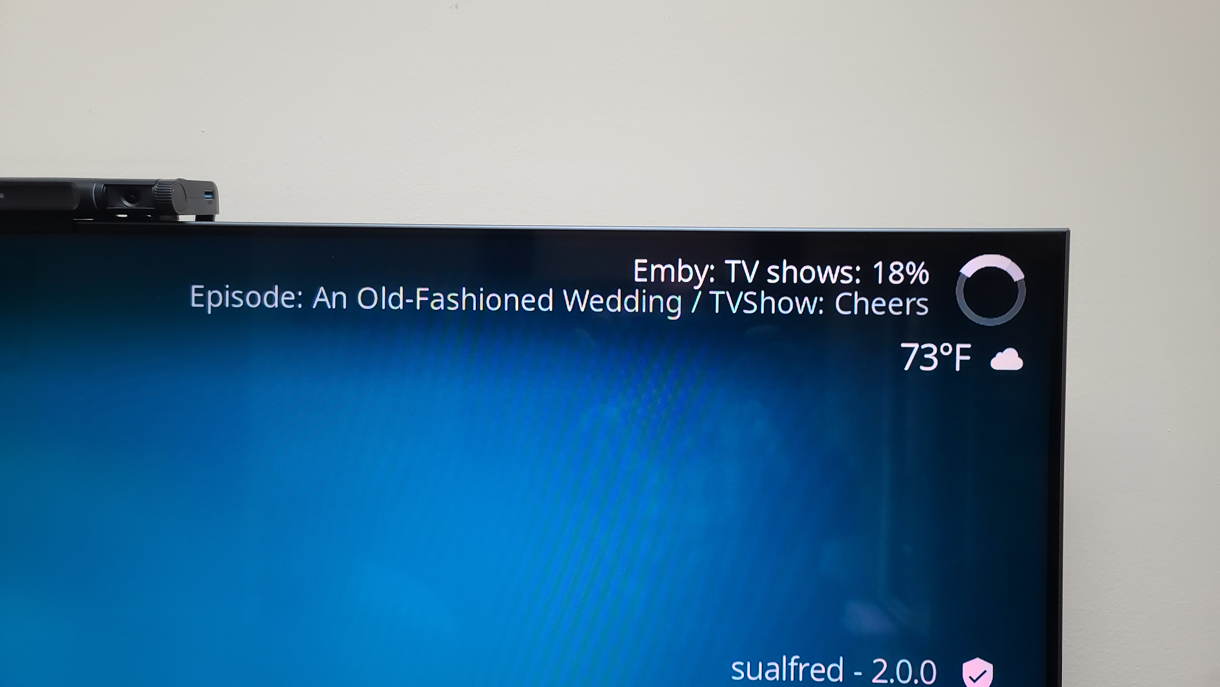

clarkss12 304 Posted October 12, 2021 Posted October 12, 2021 (edited) I updated to the latest .13 version, but still having issues with multiple episodes (duplicates). I am running Emby for Kodi on a box running CoreELEC as the OS.... When your addon scans, it gets to one particular episode (The Red Ghost of Eagle Creek - Death Valley Days) and freezes for a few minutes, then starts scanning again at 18% for the TV series of Cheers........ This goes on and on forever. I found the duplicates, and deleting them..... But, is there a better way to continue scanning?? Here is the log. thanks. log-2021-10-12-16.40.03.zip Edited October 12, 2021 by clarkss12

quickmic 1709 Posted October 14, 2021 Author Posted October 14, 2021 (edited) On 10/12/2021 at 7:01 PM, clarkss12 said: I updated to the latest .13 version, but still having issues with multiple episodes (duplicates). I am running Emby for Kodi on a box running CoreELEC as the OS.... When your addon scans, it gets to one particular episode (The Red Ghost of Eagle Creek - Death Valley Days) and freezes for a few minutes, then starts scanning again at 18% for the TV series of Cheers........ This goes on and on forever. I found the duplicates, and deleting them..... But, is there a better way to continue scanning?? Here is the log. thanks. log-2021-10-12-16.40.03.zip 645.86 kB · 1 download Did Kodi crash after that episode, cause sounds like? That would explain the rollback to 18% -> resume function after a Kodi crash. The log file didn't show any specific issue. Can you disable the screensaver? Maybe it's related to it. Edited October 14, 2021 by quickmic
clarkss12 304 Posted October 14, 2021 Posted October 14, 2021 6 hours ago, quickmic said: Did Kodi crash after that episode, cause sounds like? That would explain the rollback to 18% -> resume function after a Kodi crash. The log file didn't show any specific issue. Can you disable the screensaver? Maybe it's related to it. Kodi would crash on that episode every time because of a duplicate. This would go on forever. I deleted the duplicates, and it would continue on, until it found another duplicate, and would repeat the same process until I deleted that duplicate. For two days, I kept deleting duplicates, because your addon would never finish it's scan, so I uninstalled it. No, it was not related to the screensaver. I am still in the process of finding and deleting duplicates of my shows episodes, so I can use your addon again.
quickmic 1709 Posted October 14, 2021 Author Posted October 14, 2021 1 hour ago, clarkss12 said: Kodi would crash on that episode every time because of a duplicate. This would go on forever. I deleted the duplicates, and it would continue on, until it found another duplicate, and would repeat the same process until I deleted that duplicate. For two days, I kept deleting duplicates, because your addon would never finish it's scan, so I uninstalled it. No, it was not related to the screensaver. I am still in the process of finding and deleting duplicates of my shows episodes, so I can use your addon again. I've performed a test with duplicates. No issue, but I tested with a distributed folder. Where exactly is the episode located? How does Emby server handle this case?
clarkss12 304 Posted October 14, 2021 Posted October 14, 2021 21 minutes ago, quickmic said: I've performed a test with duplicates. No issue, but I tested with a distributed folder. Where exactly is the episode located? How does Emby server handle this case? I have several hard drives, with TV Shows and their episodes scattered across those drives. I have been recording TV shows for several years, using different software DVRs. I have used Tvheadend DVR, one that I can't even remember, the HDHomeRun, Plex DVR and Emby DVR. Anyway that is why I have my recordings scattered all over my network. For example, I may have one episode of "Superman" (Season 1 Episode 1) on one hard drive, and a duplicate "Superman" (Season 1 Episode 1) on a different hard drive that I recorded years ago. Emby handles them correctly. Kodi, scans them and shows ALL of the duplicates....... See the attached. I have been spending hours deleting those duplicates. Thankfully, Emby "sees" those episodes that are scattered across my network and will NOT re-record the episodes that I already have recorded.
quickmic 1709 Posted October 14, 2021 Author Posted October 14, 2021 1 hour ago, clarkss12 said: I have several hard drives, with TV Shows and their episodes scattered across those drives. I have been recording TV shows for several years, using different software DVRs. I have used Tvheadend DVR, one that I can't even remember, the HDHomeRun, Plex DVR and Emby DVR. Anyway that is why I have my recordings scattered all over my network. For example, I may have one episode of "Superman" (Season 1 Episode 1) on one hard drive, and a duplicate "Superman" (Season 1 Episode 1) on a different hard drive that I recorded years ago. Emby handles them correctly. Kodi, scans them and shows ALL of the duplicates....... See the attached. I have been spending hours deleting those duplicates. Thankfully, Emby "sees" those episodes that are scattered across my network and will NOT re-record the episodes that I already have recorded. What's your setup on emby server?

clarkss12 304 Posted October 14, 2021 Posted October 14, 2021 (edited) My device that I am using, uses a microSD card for the OS, which is CoreELEC. I swapped sd cards that is using version 6.0.6 and it gets to around 15% complete then starts over, but doesn't appear to crash. I added a Log file. Next, on the same device, but running Android, I will test your addon. log-2021-10-14-17.07.39.zip Edited October 14, 2021 by clarkss12

quickmic 1709 Posted October 14, 2021 Author Posted October 14, 2021 4 minutes ago, clarkss12 said: My device that I am using, uses a microSD card for the OS, which is CoreELEC. I swapped sd cards that is using version 6.0.6 and it gets to around 15% complete then starts over, but doesn't appear to crash. I added a Log file. Next, on the same device, but running Android, I will test your addon. log-2021-10-14-17.07.39.zip 998.27 kB · 0 downloads 6.0.6 -> the plugin crashes directly due to bugs
clarkss12 304 Posted October 14, 2021 Posted October 14, 2021 I tested on a Beelink GT Mini 2 Android TV box running a modded Android TV OS........ I did a complete re-install of Kodi 19.2 and then installed the plugin.video.emby-6.1.3. I only added TV shows to scan..... When it got to Season 10 Episode 25 "An Old-Fashioned Wedding", it stopped scanning an sat there forever (still sitting at that episode). This particular episode recording has two parts, guessing that the recording was interrupted and then continued to record. Anyway, you addon gets confused with anything that is different. Now, I will test using my Nvidia Shield. kodi.log
quickmic 1709 Posted October 14, 2021 Author Posted October 14, 2021 1 minute ago, clarkss12 said: I tested on a Beelink GT Mini 2 Android TV box running a modded Android TV OS........ I did a complete re-install of Kodi 19.2 and then installed the plugin.video.emby-6.1.3. I only added TV shows to scan..... When it got to Season 10 Episode 25 "An Old-Fashioned Wedding", it stopped scanning an sat there forever (still sitting at that episode). This particular episode recording has two parts, guessing that the recording was interrupted and then continued to record. Anyway, you addon gets confused with anything that is different. Now, I will test using my Nvidia Shield. kodi.log 763.14 kB · 0 downloads This log tells me a lot more, and looks like it's not about a similar episode issue. That's a multi-version issue, I'll investigate. Thanks!
quickmic 1709 Posted October 14, 2021 Author Posted October 14, 2021 2 minutes ago, quickmic said: This log tells me a lot more, and looks like it's not about a similar episode issue. That's a multi-version issue, I'll investigate. Thanks! Edit: ...or could be an update pushed from Emby server while you performed the initial sync...
