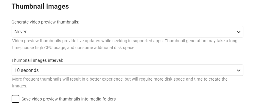

iPenguin02 5 Posted October 8, 2020 Posted October 8, 2020 Is there any way to change the chapter image intervals to something other than 10 seconds? I was hoping for every 30 seconds.
CBers 7541 Posted October 8, 2020 Posted October 8, 2020 (edited) Change the Thumbnail Images Interval setting in the Advanced settings for each library. Edited October 8, 2020 by CBers
iPenguin02 5 Posted October 8, 2020 Author Posted October 8, 2020 10 minutes ago, CBers said: Change the Thumbnail Images Interval setting in the Advanced settings for each library. Mine only has 2 options 10 Seconds and Chapter Markers
CBers 7541 Posted October 8, 2020 Posted October 8, 2020 Apologies, didn't realise that you couldn't change it. Used to be an option, but I guess for performance, the other options were removed.

iPenguin02 5 Posted October 8, 2020 Author Posted October 8, 2020 43 minutes ago, Luke said: I think what you mean is the skip forward/back length. Many of our apps have configuration for that to allow you to control it. Sorry should have been more clear, the Thumbnail Image intervals. I wanted to do 30 seconds or more to take up less space on my hard drive. 10 seconds seems like alot.
Carlo 4561 Posted October 8, 2020 Posted October 8, 2020 A bif is actually one screen shot pulled every x seconds. It's not a full screen image but a "small" image used for the display block on screen. Some clients don't handle some spacing like 30 seconds very well so after testing it was found that 10 seconds has both a good onscreen indication (pretty accurate) and seems to work well in all clients that support bif files..
