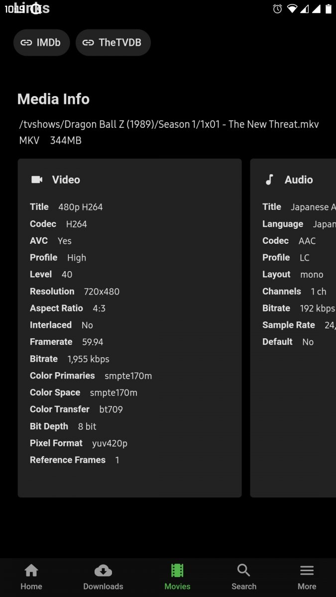

negativzeroe 80 Posted November 13, 2020 Author Posted November 13, 2020 33 minutes ago, Luke said: Are you trying to cast to chromecast, or play on the device? What are you trying to play? First episode of Dragon Ball Z (which has been confirmed to work on local storage and web) just on my Android device (also Fire TV but that is android based as well). It seems like it's acting just like Queen of the Damned did back when that was fixed.
Carlo 4561 Posted November 13, 2020 Posted November 13, 2020 1 hour ago, negativzeroe said: First episode of Dragon Ball Z (which has been confirmed to work on local storage and web) just on my Android device (also Fire TV but that is android based as well). It seems like it's acting just like Queen of the Damned did back when that was fixed. Can you provide a screen capture of the detail page from web admin for one of these episodes (bottom of detail page)? Thanks
negativzeroe 80 Posted November 14, 2020 Author Posted November 14, 2020 No just this show for some reason. Other h264 content plays fine.
