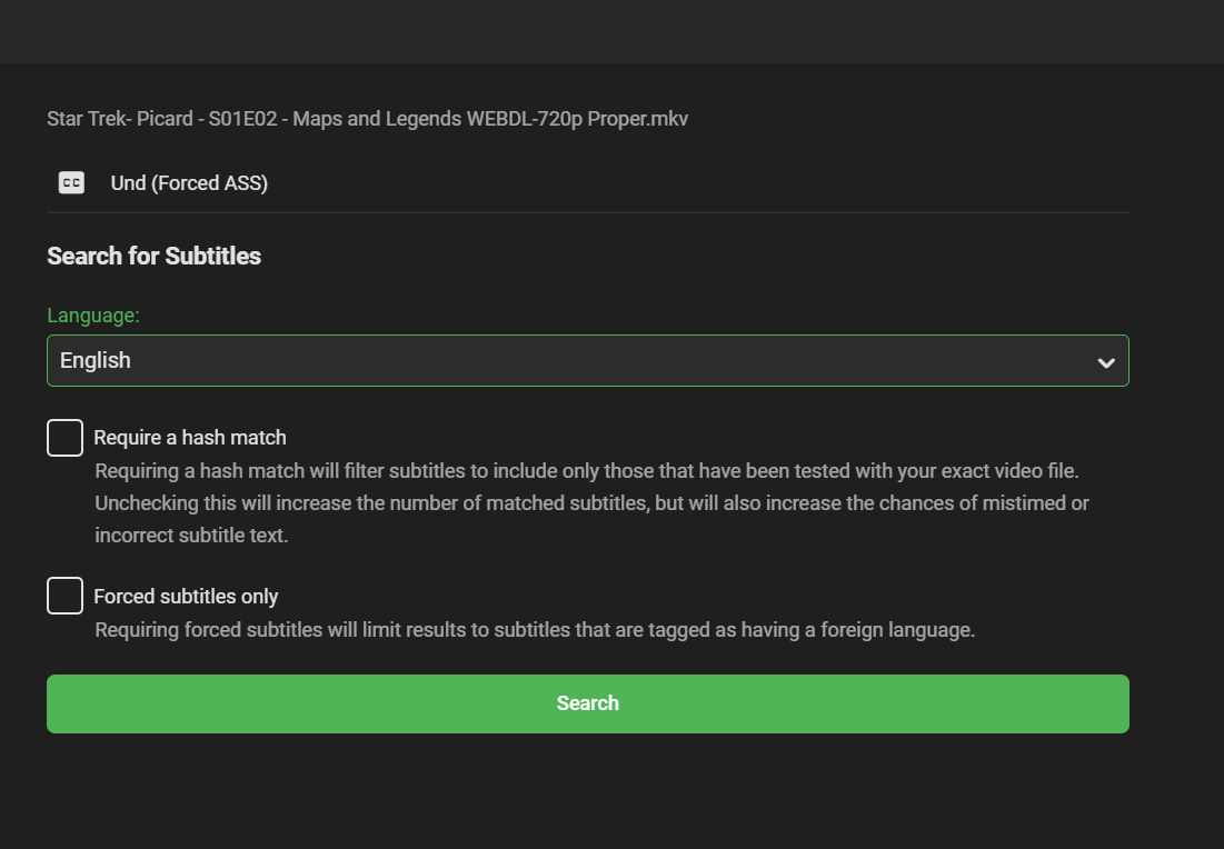

ItangoII 0 Posted October 7, 2020 Posted October 7, 2020 I've checked and double checked settings, open subtitles is finding such for other shows, but not for Warrior Nun. I checked on open subtitles, and season 1 is available. I've also checked the settings for that particular show. I can find nothing wrong. I'm not sure where to check for log info on the connection attempt which is where I would usually go next. Thanks
rbjtech 5337 Posted October 7, 2020 Posted October 7, 2020 Have you got 'Hash match' selected - if yes, then it may be that this is not a hash match, thus it is not selecting it for you. Untick that option - but as a result the subs may not be in sync.
Luke 42208 Posted October 7, 2020 Posted October 7, 2020 6 hours ago, rbjtech said: Have you got 'Hash match' selected - if yes, then it may be that this is not a hash match, thus it is not selecting it for you. Untick that option - but as a result the subs may not be in sync. Yes applying this filter is usually the reason why you may not get subtitles downloaded.
ItangoII 0 Posted October 7, 2020 Author Posted October 7, 2020 (edited) 8 hours ago, rbjtech said: Have you got 'Hash match' selected - if yes, then it may be that this is not a hash match, thus it is not selecting it for you. Untick that option - but as a result the subs may not be in sync. It does not seem to matter, I've tried it both ways with either of them checked and any combination. I also double checked the availability on Open Subtitles, and tried switching to another language (having verified that Italian was also there) and same result. Edited October 7, 2020 by ItangoII

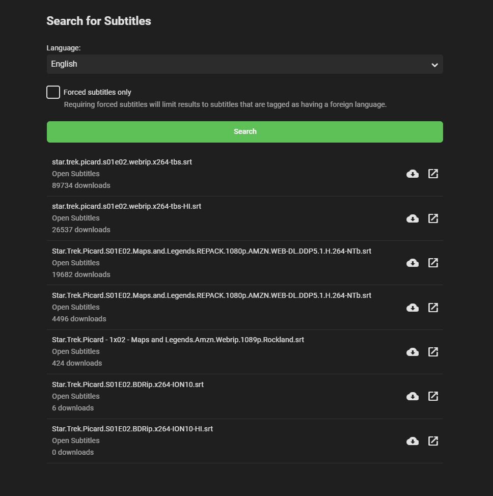

ItangoII 0 Posted October 8, 2020 Author Posted October 8, 2020 2 hours ago, Luke said: Ok yes that is true. Once you have 4.5.2 please let us know if you're still running into this. Thanks. Yes I am. And thanks for the help! I bumped into one of your posts to another person indicating that Emby would need write access to the medias directory in order to place the file. Perusing that, I have confirmed the Emby does have write access. However, I also realized Emby is not getting that far. Meaning it would fetch a list from Opensubtitles first allowing to user to choose which one to download, and that is what's not happening. I've gone over the few tutorials for setting up subtitles, and double checked them. All seems to be in order.
