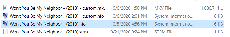

moshmont 8 Posted October 6, 2020 Author Posted October 6, 2020 Hey Luke, I was wrong, the mkv file did get created, I was looking in the wrong directory. But, the movie still won't play. I did find the log for the conversion, it's attached. I've also attached a pic of what is in that directory. ffmpeg-directstream-2150aa3c-d2db-4bac-9979-ddbcc6030eff_1.txt
