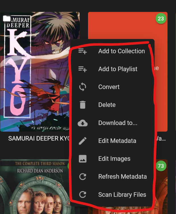

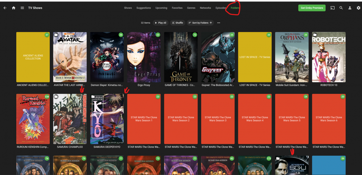

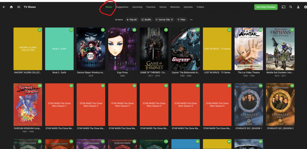

Kokimoto 0 Posted October 6, 2020 Author Posted October 6, 2020 I have Several folders with this issue here are some screen shots, check what it's mark with red. If you see on the last image there is no option for Identified it.

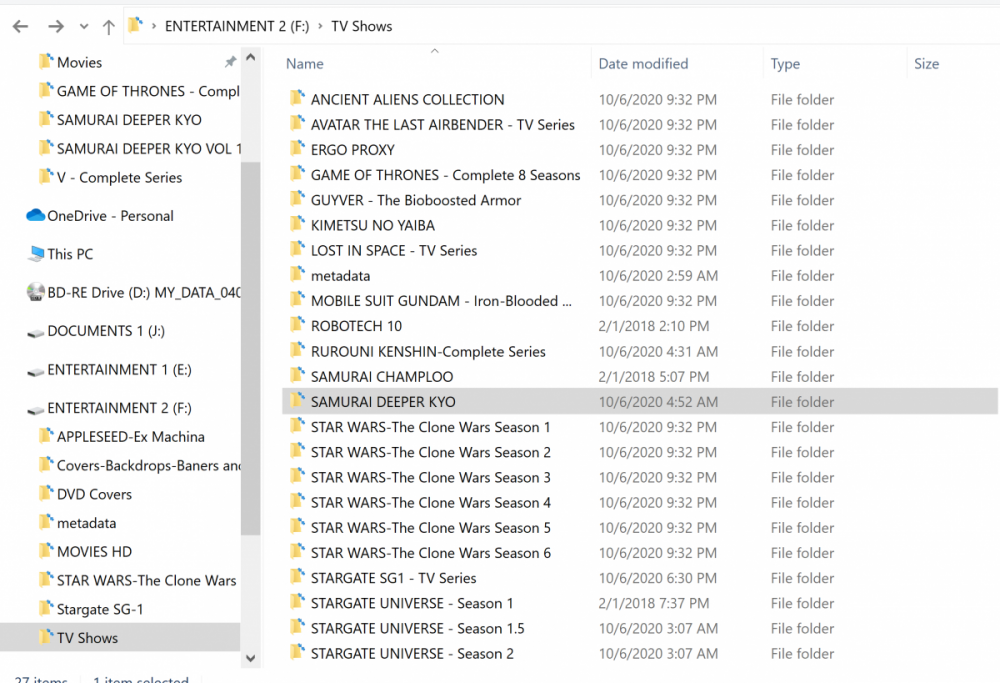

Carlo 4561 Posted October 7, 2020 Posted October 7, 2020 Hi, What does your folder structure on disc look like?
Happy2Play 9802 Posted October 7, 2020 Posted October 7, 2020 (edited) This means Emby auto detection does not understand that they are a Series and there currently no way to force Emby to treat them as a Series or even use Identify. Yes we would need to see folder structure and naming scheme. Edited October 7, 2020 by Happy2Play

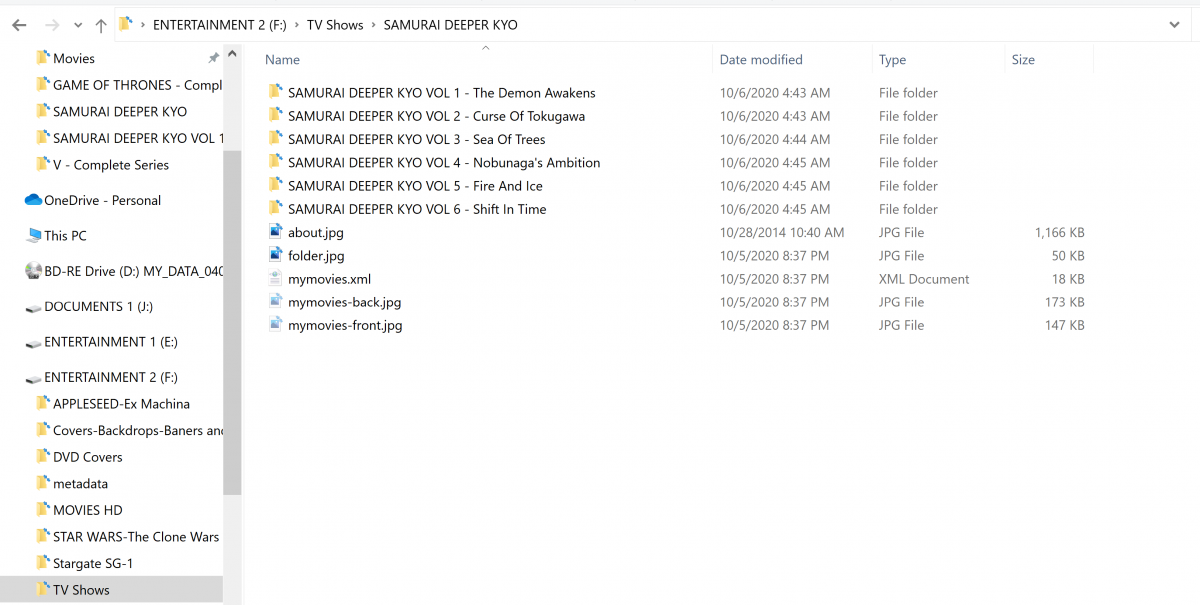

Kokimoto 0 Posted October 7, 2020 Author Posted October 7, 2020 I use the same folder structure on all my folders and files, I have even compare then with the ones that work, I sending a capture of one of the folders tat I have issues with.
Happy2Play 9802 Posted October 7, 2020 Posted October 7, 2020 Emby is very finicky with Show/Season/Episode or Show/Episode structure and naming schemes. In this case Emby is not registering your specific Season level naming. How are the episodes named? https://support.emby.media/support/solutions/articles/44001159110-tv-naming 1
Carlo 4561 Posted October 7, 2020 Posted October 7, 2020 That structure is likely why you aren't getting proper matching. You will have far better luck following the guide Happy2Play linked to which is the tried and true method of folder/file naming. There are utilities such as FileBot that can do much of the work of renaming for you.
