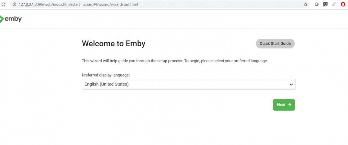

antelopelabs 0 Posted October 7, 2020 Author Posted October 7, 2020 3 hours ago, speechles said: Go to the PC running Emby server. Open a browser using: http://127.0.0.1:8096/web/index.html#!/dashboard When you use the link above what is reported for your LAN access? That is the value you want to use when connecting inside your network. Disregard the WAN access if you never want to connect remotely. It just brings me to this screen, even though the server is setup and working (I can reach it through my mobile). It also does the same thing if I try to go to the specific IP address of the server.
speechles 2062 Posted October 7, 2020 Posted October 7, 2020 @Luke Can you help here? Something is haywire and I do not know how to find the needle in this hay stack.
Luke 42208 Posted October 7, 2020 Posted October 7, 2020 @cayars can jump on with him and take a look at what's going on.
Carlo 4561 Posted October 7, 2020 Posted October 7, 2020 39 minutes ago, antelopelabs said: It just brings me to this screen, even though the server is setup and working (I can reach it through my mobile). It also does the same thing if I try to go to the specific IP address of the server. As Luke mentioned I can do a remote session with you and help you get this sorted out. Send me a PM and we can set this up. I've got time today if you do or we can schedule this for another day. 1
