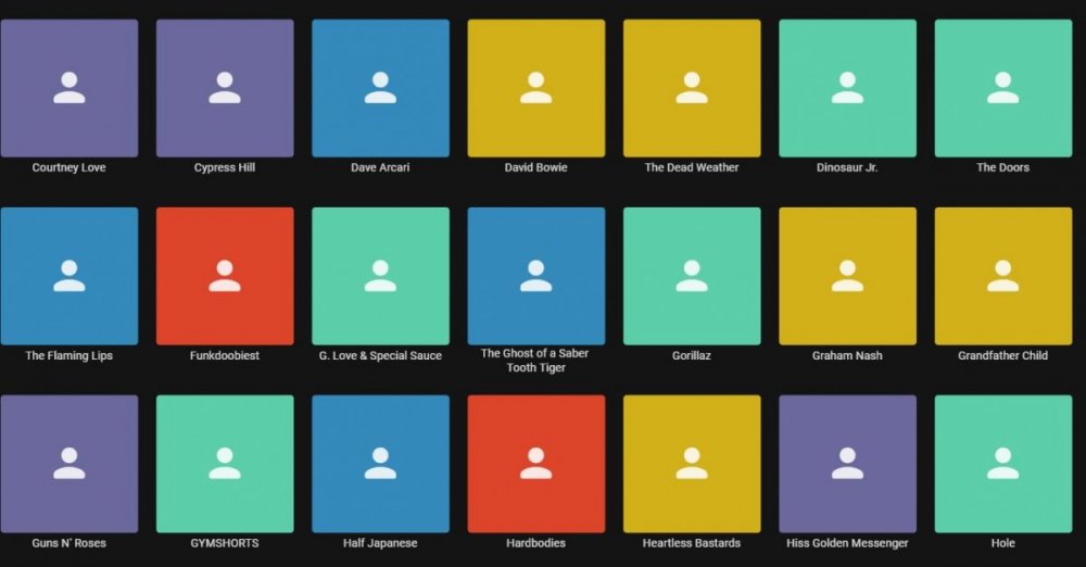

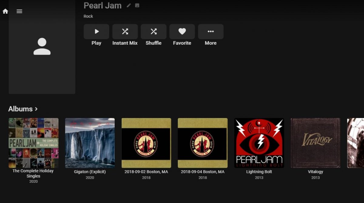

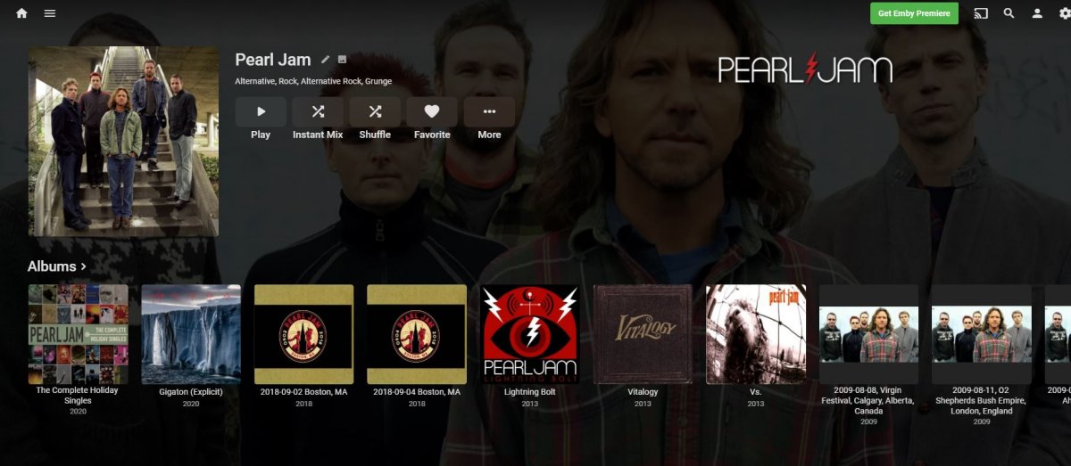

jbaggs 2 Posted August 26, 2020 Posted August 26, 2020 Hello again! As of now all but two of the artists in my music library are without any type of image (music_collection.jpg). Which is the way it should be since I am not using any music metadata plugins (plugins.jpg - music brainz & audiodb uninstalled) and Emby does not recognize folder.ext (in my case I was using folder.jpg) even though this says otherwise: https://support.emby.media/support/solutions/articles/44001159113-music-naming So why did Pearl Jam go from having no artist picture, logo, or background (pj_before_refresh.jpg) to having an artist picture, logo and background (pj_after_refresh.jpg) after I selected refresh media (and replace images was not selected). Albums that did not have any album art in the tags had their image changed to this "default" picture. (seen in pj_after_refresh.jpg) If I understand correctly Emby should not have gone out to the internet to retrieve this information, correct? So where is it coming from? The same thing happened to the Nirvana folder. I didn't take any screenshots. I have tried to refresh the metadata for a handful of other artists and nothing changed even after restarting the server and re-scanning libraries embyserver.txt
Happy2Play 9802 Posted August 26, 2020 Posted August 26, 2020 (edited) Artist tab will not use your folder structure artist image. That image will only be used in folder view. I believe that artist image will be coming from FanArt. There is no current way to stop Artist/People images from being downloaded. @jbaggs What are your Music Library settings? @Luke I haven't tested recently but has the MusicArtist issue been addressed if options are disabled via Library? Edited August 26, 2020 by Happy2Play

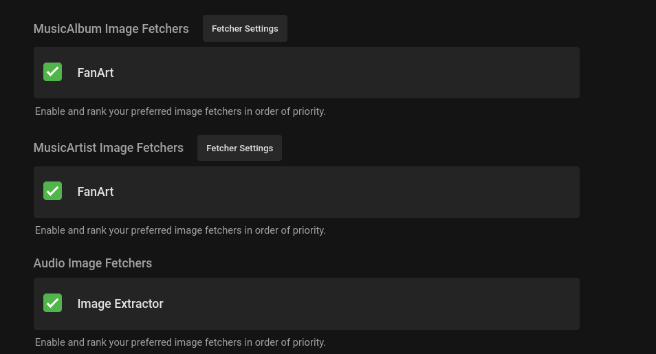

jbaggs 2 Posted August 27, 2020 Author Posted August 27, 2020 (edited) 20 hours ago, Happy2Play said: Artist tab will not use your folder structure artist image. Yeah I found a few threads that mentioned that. So I found these settings in the library's advanced section. Looks like they are enabled by default as I never set them. Is this what is downloading the images? If so ... why doesn't it work for any of the other artists I tried 'refresh metadata' with? Edited August 27, 2020 by jbaggs
Luke 42205 Posted August 27, 2020 Posted August 27, 2020 We'd have to go over an example, but fanart is based on musicbrainz id's, so you'll need to make sure your artists have musicbrainz id's assigned. You mentioned earlier you removed musicbrainz, so now that means you'll have to fill those values in manually, then you should be able to get images from fanart.
