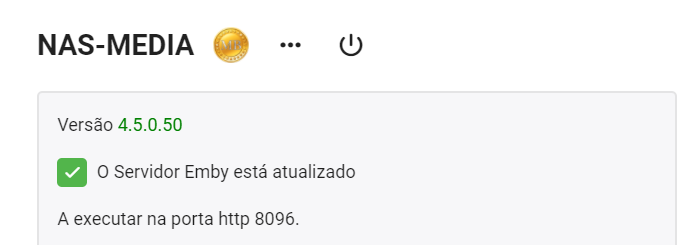

ricardonr 5 Posted September 29, 2020 Author Posted September 29, 2020 But on the settings the version is 4.5.0.50

Luke 42243 Posted October 3, 2020 Posted October 3, 2020 On 10/2/2020 at 1:54 PM, ricardonr said: Hi Luke, I've upgraded to 4.5.1.0 and now the scan library is stuck at 30,9%. Attached are the new logs. Can you take a look, please? Thanks, Logs.zip 279.64 kB · 0 downloads I still see just 4.5.0.50 in these log files. Are you sure you updated to 4.5.1?
Happy2Play 9811 Posted October 3, 2020 Posted October 3, 2020 19 minutes ago, Luke said: I still see just 4.5.0.50 in these log files. Are you sure you updated to 4.5.1? There are three server versions of logs there 4.5.0.14, 4.5.0.50, and 4.5.1.0. I would assume user will need to manually change permissions. 2020-10-02 18:32:40.768 Error App: Error getting version number from /volume1/Emby/plugins/MovieDb.dll *** Error Report *** Version: 4.5.1.0 Command line: /volume1/@appstore/EmbyServer/system/EmbyServer.dll -programdata /volume1/Emby -ffdetect /var/packages/EmbyServer/target/bin/ffdetect -ffmpeg /var/packages/EmbyServer/target/bin/ffmpeg -ffprobe /var/packages/EmbyServer/target/bin/ffprobe -nolocalportconfig -updatepackage emby-server-synology_{version}_x86_64.spk Operating system: Linux version 4.4.59+ (root@build3) (gcc version 4.9.3 20150311 (prerelease) (crosstool-NG 1.20.0) ) #25426 SMP PREEMPT Wed Jul 8 03:21:29 CST 2020 Framework: .NET Core 3.1.7 OS/Process: x64/x64 Runtime: volume1/@appstore/EmbyServer/system/System.Private.CoreLib.dll Processor count: 4 Data path: /volume1/Emby Application path: /volume1/@appstore/EmbyServer/system System.UnauthorizedAccessException: System.UnauthorizedAccessException: Access to the path '/volume1/Emby/plugins/MovieDb.dll' is denied. ---> System.IO.IOException: Permission denied --- End of inner exception stack trace --- at Interop.ThrowExceptionForIoErrno(ErrorInfo errorInfo, String path, Boolean isDirectory, Func`2 errorRewriter) at Microsoft.Win32.SafeHandles.SafeFileHandle.Open(String path, OpenFlags flags, Int32 mode) at System.IO.FileStream.OpenHandle(FileMode mode, FileShare share, FileOptions options) at System.IO.FileStream..ctor(String path, FileMode mode, FileAccess access, FileShare share, Int32 bufferSize, FileOptions options) at System.IO.FileStream..ctor(String path, FileMode mode, FileAccess access, FileShare share, Int32 bufferSize, Boolean useAsync) at System.Diagnostics.FileVersionInfo.TryLoadManagedAssemblyMetadata() at System.Diagnostics.FileVersionInfo.GetVersionInfo(String fileName) at Emby.Server.Implementations.ApplicationHost.GetDllVersion(String path) Source: System.Private.CoreLib TargetSite: Void ThrowExceptionForIoErrno(ErrorInfo, System.String, Boolean, System.Func`2[Interop+ErrorInfo,Interop+ErrorInfo]) InnerException: System.IO.IOException: Permission denied Source: TargetSite:
