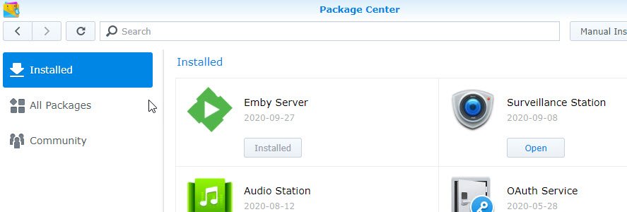

Now Emby shows "installed" - it used to show "open" like the others.
Not sure what to do.
I did run the server on the ds18+ and it is working and now shows it has the most current version.
Only the info in the package center seems to be messed up.

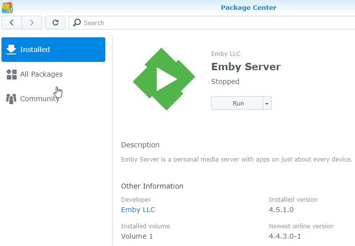

So I clicked "manual install" and then "run" when that was done.  Here are screenshots of the package center:
First note that it says 4.5.1 is installed and that it is stopped.  I can go to any one of the 3 roku devices I have and get emby to run and play a recorded show. Thus my conclusion is that the server is not stopped or how could I have run emby on the Roku?

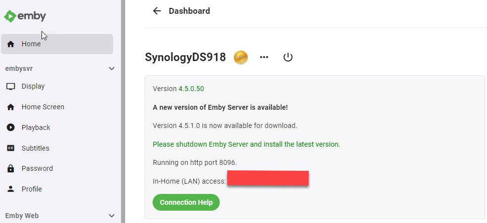

Here is what I see if I start Emby on the Synology select "manage emby server" and get the dashboard:
As you can see here it says it is running version 4.5.0.50 and that 4.5.1 is available.  This contradicts the previous image.
The text for this update said "Resolve install failures on certain Synology NAS models" so maybe the DS918+ is not one of them?  Have I done something wrong?  I have done many manual installs on different apps and had no trouble until this one.

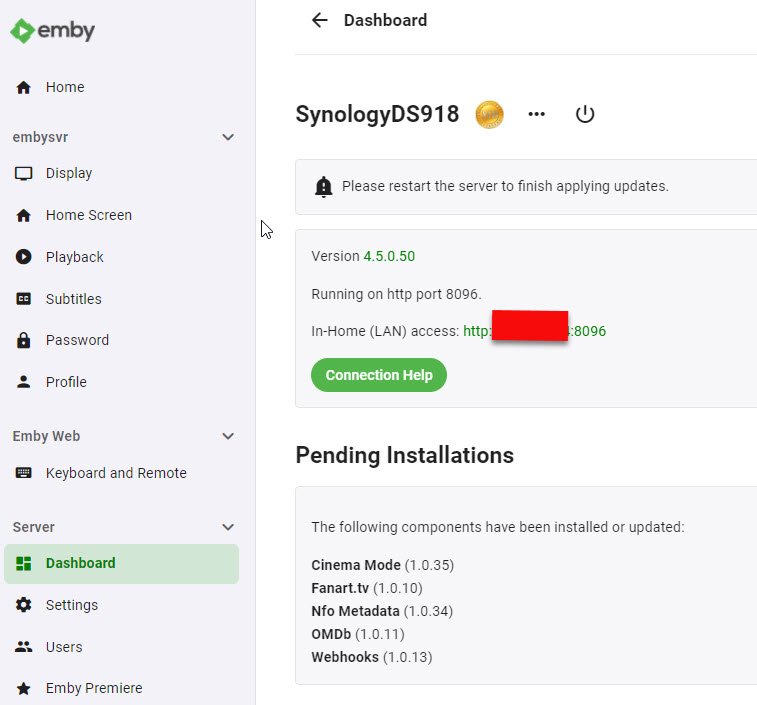

Today I happened to open emby server and went to the dashboard and noticed something different - I have no idea why this is different from previous images I have posted.
Notice "please restart the server to finish applying the updates" - this is not present on any of the previous images I have posted.
I assume it is referring to the emby server so I went to the package center but it already said it was stopped (see previous post).  So the only thing I could think to do was to restart the synology server.  My logic was that this would shut down all services and then restart then on re-boot.  So I restarted the DS918+.

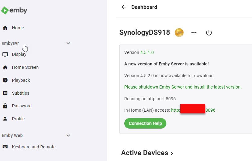

After restart of the DS918+:I went back to the emby dashboard.  Now the restart server message is gone and the "pending installation" is also gone (see previous image to see what they were) and it recognizes that 4.5.1 is installed and that 4.5.2 is available (image below).

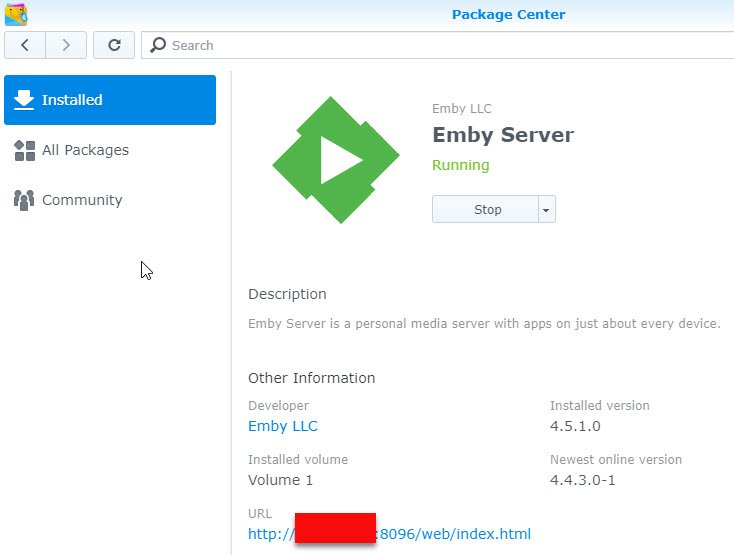

I then went to the package center:
I note that emby server is now "installed".  I then clicked on the emby server box:
Amazing!!!! it says it is running!
So it seems something changed to get emby to recognize that it needed to restart - I didn't knowingly do anything to emby since the last post.  So with the exception that the package center / installed shows the emby app as installed (the others are open).  It appears everything is back to the way it used to be.

The restarting for updates message you saw in Emby Server was about plugin updates. You can see what's been updated in the Pending Installations section.
