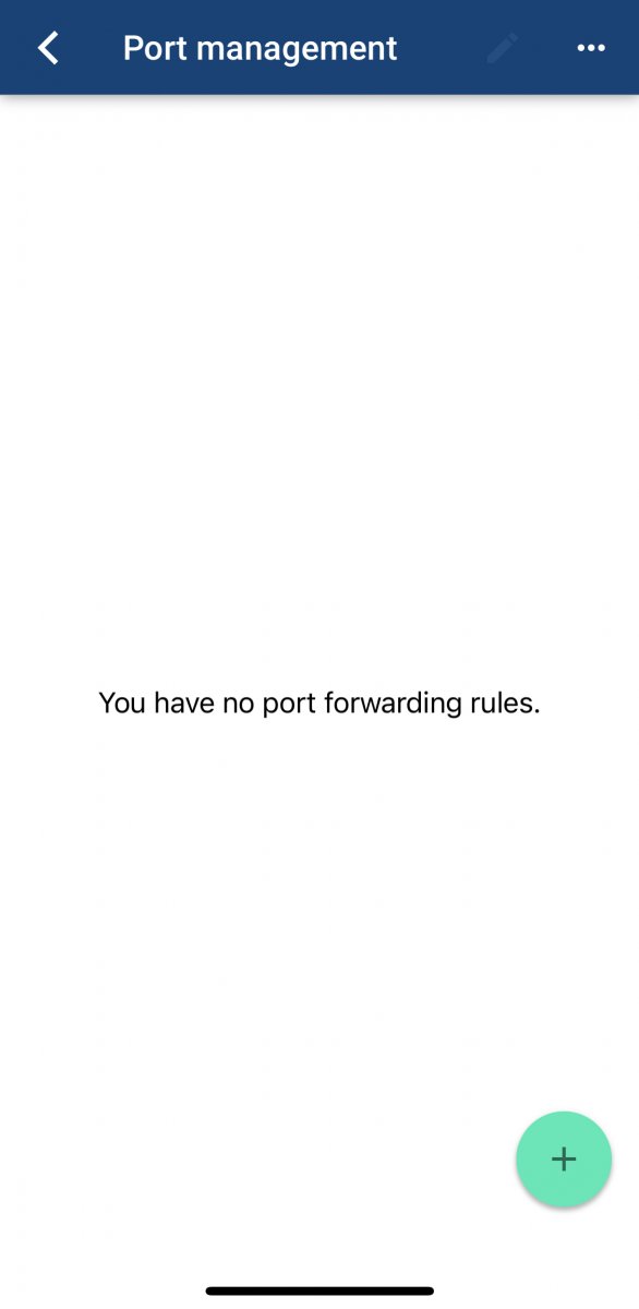

IamJosh 8 Posted September 28, 2020 Author Posted September 28, 2020 1 minute ago, Luke said: Hi, we're trying to help you. The old server installation automatically setup the port forwarding with your router. The new server installation may not have been able to do this, so that's why you should just go ahead and setup a port forwarding rule manually. I know, not being mad at anyone here, I’m really trying to figure this out too. i installed Emby back in the first laptop, and there is no port forward that was created, see attached print screen (using Google WiFi)
Luke 42210 Posted September 28, 2020 Posted September 28, 2020 Usually when an application adds a rule via upnp, routers generally don't show those in the list. So what's happening here is, your old server is reserving use of that port forwarding rule. The new server doesn't remove it, and therefore is unable to replace the rule with a new one. However if you were to manually add a port forwarding rule, then that would take precedence over the rules created by applications via upnp.
