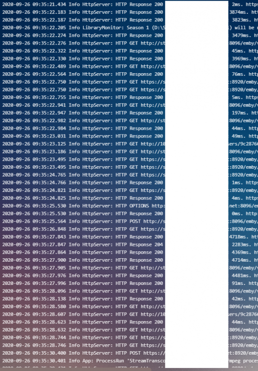

byusinger84 1 Posted September 26, 2020 Posted September 26, 2020 (edited) Server specs: Xeon @ 2.6 ghz with 32 cores and 16 GB of RAM 1 GB dedicated fiber connection SSDs for OS and Emby itself GTX 1050 for transcoding Running Emby 4.5.0.50 My Emby server is no slouch, as you can see. And yet, off and on I have users complaining about constant buffering even when trying to stream at a hard set 720p resolution at 1.5 megabit connection. It's hit or miss and isn't their internet as I can reproduce the problem on occasion when offsite. The only thing I can see in the logs is HTTP response times over several thousand and I've even seen up to 25,000 ms. I can't explain it. And this also happens to some users while at the same time other users continue to see no issues. It isn't always the same set of users either. Roku App, mobile apps, web apps, and iOS/Apple TV apps all have the same behavior but again it's hit or miss and extremely hard to reproduce on demand. See snippet of my logs. Any thoughts or suggestions? ffmpeg-transcode-8328c39c-0160-4d9f-91c5-ae7af0205a44_1.txt embyserver.txt Edited September 26, 2020 by byusinger84
PenkethBoy 2068 Posted September 26, 2020 Posted September 26, 2020 going to need a lot more info how many users, how many remote streams - how many concurrent without the problem and how many with etc etc full server log going to be needed as well - for a period before during and after the problem where are the movies etc stored and on what and maybe where have you looked for errors in the log - find any around the time you see the problem? Might be a red herring but you dont have much ram in that server - could be an issue - have you done any analysis - ruled anything out an how did you do that?
byusinger84 1 Posted September 26, 2020 Author Posted September 26, 2020 Just now, PenkethBoy said: going to need a lot more info how many users, how many remote streams - how many concurrent without the problem and how many with etc etc full server log going to be needed as well - for a period before during and after the problem where are the movies etc stored and on what and maybe where have you looked for errors in the log - find any around the time you see the problem? Might be a red herring but you dont have much ram in that server - could be an issue - have you done any analysis - ruled anything out an how did you do that? I have probably 30 users. Issue happens when one or 5 are streaming at the same time. It really doesn't have a rhyme or reason. Full server log is posted. Movies and TV shows are both having issues and are stored on redundant NAS devices with 10 gigabit connections. Yes. Read above what I said about the high HTTP response times. RAM isn't the issue as the Emby server utilizes less than 30% at any given time.
