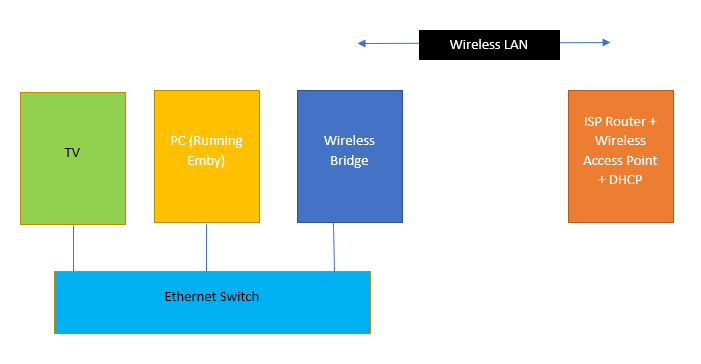

Solution vdatanet 1619 Posted September 25, 2020 Solution Posted September 25, 2020 (edited) If you can't connect your router, you can add a switch, connect both TV and Computer and add a wireless AP in bridge mode connected to the switch. Edited September 25, 2020 by vdatanet 1 1
Gilgamesh_48 1243 Posted September 25, 2020 Posted September 25, 2020 19 minutes ago, vdatanet said: If you can't connect your router, you can add a switch, connect both TV and Computer and add a wireless AP in bridge mode connected to the switch. I think that is the only way you might get acceptable performance without actually wiring to the router. I believe that network traffic that goes from the server to the TV does not need to actually progress through the router. But my networking expertise is quite old and I may be misremembering how networks actually function. But, even if the traffic must go through the router in this mode you will see an improvement in performance. Generally decent wireless access points have better performance than the cheep adapters found in most consumer devices.
rbjtech 5337 Posted September 25, 2020 Posted September 25, 2020 (edited) A router is used for the routing/NAT only - it is not used for LAN traffic. Therefore as @vdatanet has said, you just need to create an Ethernet network (with a small gigabit switch), next to your PC and TV, plug them both into it - and then use a Wireless bridge plugged into the same Ethernet switch which will give you wireless access to your router for internet access and core LAN services such as DHCP. All emby traffic between your TV and PC (and anything else plugged into the switch) will stay wired. The downside is if you lose wireless, then you lose the internet on the wired network and the ability to renew your DHCP leases. edit - it's Friday afternoon and I'm bored - so a quick mock up below ... Edited September 25, 2020 by rbjtech 1 1
bauerhunter11@gmail.com 1 Posted September 25, 2020 Author Posted September 25, 2020 31 minutes ago, rbjtech said: A router is used for the routing/NAT only - it is not used for LAN traffic. Therefore as @vdatanet has said, you just need to create an Ethernet network (with a small gigabit switch), next to your PC and TV, plug them both into it - and then use a Wireless bridge plugged into the same Ethernet switch which will give you wireless access to your router for internet access and core LAN services such as DHCP. All emby traffic between your TV and PC (and anything else plugged into the switch) will stay wired. The downside is if you lose wireless, then you lose the internet on the wired network and the ability to renew your DHCP leases. edit - it's Friday afternoon and I'm bored - so a quick mock up below ... Amazing -- this sounds super viable. Once I implement this and have time to test, I will post the outcomes for future users. Thanks guys! You all rock so hard. 1

vdatanet 1619 Posted September 25, 2020 Posted September 25, 2020 3 minutes ago, cayars said: Most home routers do have a 4 port switch built in (just saying). If the router is near, you can use the router switch. The location of the router has not been discussed, but I have understood that it is far from the TV and the server. 1
rbjtech 5337 Posted September 25, 2020 Posted September 25, 2020 1 minute ago, cayars said: Most home routers do have a 4 port switch built in (just saying). lol sure - semantics I guess, but the switch part is not a router... 1 hour ago, bauerhunter11@gmail.com said: But my computer and TV are right next to each other, but the router is on the other side of the house so a wired connection is unfortunately not possible. This is the reason the OP can't use the switch on his 'router' ..
vdatanet 1619 Posted September 25, 2020 Posted September 25, 2020 If the router's wifi is poor, you can add an AP in bridge mode next to the router, to get an optimal link between the switch and the router.
