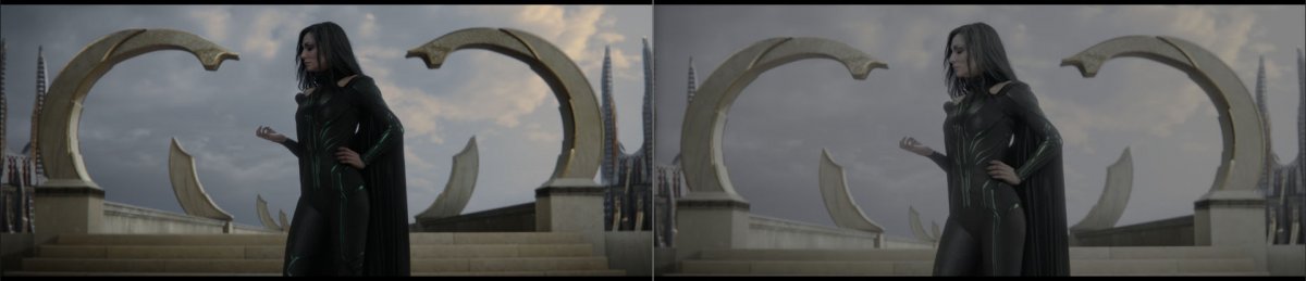

kirshman 1 Posted September 24, 2020 Posted September 24, 2020 (edited) Hello everyone. I have been using cayars script for awhile now, but wanted to give sickbeard a change. I ran it on a few different videos now, and they all look a little washed out as you can see below. Can anyone tell me what setting would be causing it to do this? This is vlc running the videos side by side. the one on the left is the orignal mkv ripped from the 4k, and the one on the right is the converted mp4 from sickbeard. I'll also include part of my config script so you can see. Edited September 24, 2020 by kirshman

Carlo 4561 Posted September 24, 2020 Posted September 24, 2020 You don't want to convert from 4K to 1080 as you're not handling the color conversion.. You would want to source a quality 1080p version before converting it to a lower bitrate streaming version so there is no color space issues.

vdatanet 1619 Posted September 25, 2020 Posted September 25, 2020 (edited) 23 minutes ago, kirshman said: Is there something else you'd recommend to convert 4k then? HDR to SDR conversion is not an easy task, if it were, Emby would do it when transcoding, but it isn't. SDR raw material always will look better than HDR to SDR converted material. Edited September 25, 2020 by vdatanet

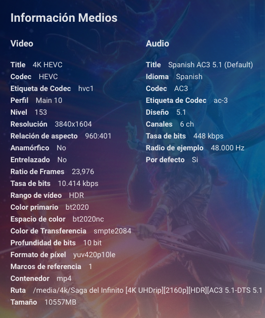

vdatanet 1619 Posted September 25, 2020 Posted September 25, 2020 Yes, you can. UHD remux is about 50 Gb and this UHD rip is about 10 Gb, and it's much better than 1080p.

vdatanet 1619 Posted September 25, 2020 Posted September 25, 2020 (edited) 13 minutes ago, cayars said: And that's probably the best way to do it if you're going to. Are you using a GPU for the conversion or just CPU? How long for a typical movie conversion? What type of size difference are you seeing? I'm using GPU for the conversion (Nvidia Cuda), It takes 2-3 hours (or more, I did that some time ago) using Nvidia GTX1060 and the size is about 1/5. Using a 55", I don't appreciate quality differences. Too much time for me, I prefer a UHD remux without conversion. Edited September 25, 2020 by vdatanet
