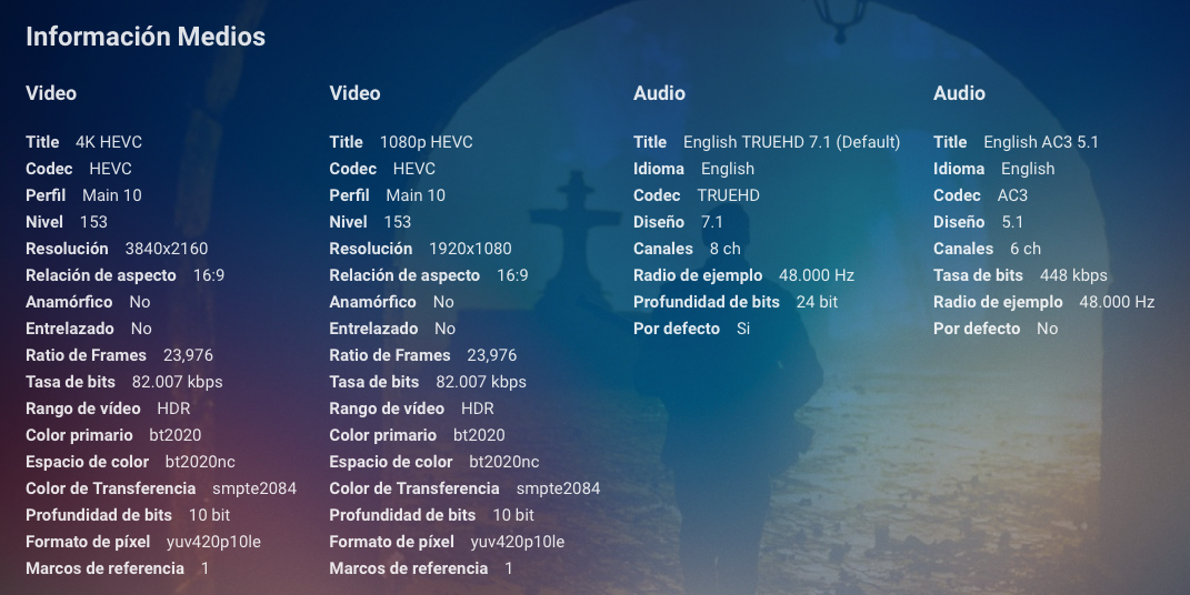

vdatanet 1619 Posted September 26, 2020 Posted September 26, 2020 46 minutes ago, CHA0SENG7NE said: Does anyone use 4k Remux files? If so how do you have yours setup to handle these? Yes, I can handle 3-4 streams direct playing. This is my setup: Server and Storage are in the same machine: Ubuntu server with i5 8600 CPU, 32 Gb RAM, 1Gb M.2 NVMe for the OS and for storage, a zfs pool with 6 drives 12 Tb/each, WD Red NAS. Wired Lan 1Gb. 4 Airpot Extreme (last generation), they are a little old but perform very well. I even can play those UHD remux in my bedroom Shield and Apple TV using Wifi. Most UHD remux I have are like this:
vdatanet 1619 Posted September 26, 2020 Posted September 26, 2020 This is my highest bitrate movie. I can play that without issues.
