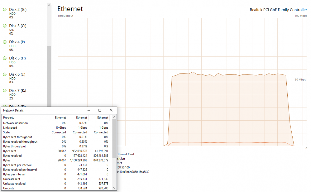

rbjtech 5337 Posted September 28, 2020 Posted September 28, 2020 So I have setup my NAS to be on a different physical NIC in the same server - it's on a different VLAN - and the results are the same. Although this time, it can be very clearly seen what the 2nd (storage) NIC is up to - with some VERY interesting developments. 10 Mbit H264 Jellyfish file - Plays OK - Note the limit @ 55 Mbit/sec DESPITE THIS BEING A 10 Mbit File - Note the duration - I did it twice because I missed it the first time. It is NOT streaming ! It is filling a buffer as quickly as it can. The buffer fill is complete before the file has finished playing ... 25 Mbit H264 Jellyfish file - Plays OK - Note the same ~55 Mbit limit - 'buffer' now taking longer to fill / maintain. 50 Mbit H264 Jellyfish file - Note the same limit @ 55 Mbit/sec - Note the duration - twice as long as above .. 100 Mbit H264 Jellyfish file - Note the same limit @ 55 Mbit/sec - Note the duration - twice as long as above .. Playback now stutters.. Nothing is contending on this network. So in summary - despite what I originally thought, the data is not being read as it's needed with a small buffer, it looks to be read as fast as it can with a large buffer - up to a max of 50 Mbit/sec (for me) and then played from the buffer. I would imagine the buffer management or refresh is where things are going wrong ? 1

rbjtech 5337 Posted September 28, 2020 Posted September 28, 2020 (edited) 32 minutes ago, vdatanet said: I did not expect these results: The Linux SMB client performs better than the native Windows client. Indeed - your LAN traffic is way in excess of 50Mbit/sec. I need to finish off finding out what is happening to the Windows Server (I have procmon from sysinternals running..) but I'd like to try a Unix VM running Emby on the same machine using the same NIC. The plot thickens.. The Windows SMB client is not the issue here - as standalone it can transfer 120 Mbytes/sec over a 1Gig link without issue - however, in combination with the Emby Server - the Emby 'buffer' cannot keep up with high bitrate files - and that's the part we need to find out why. Edited September 28, 2020 by rbjtech 1
