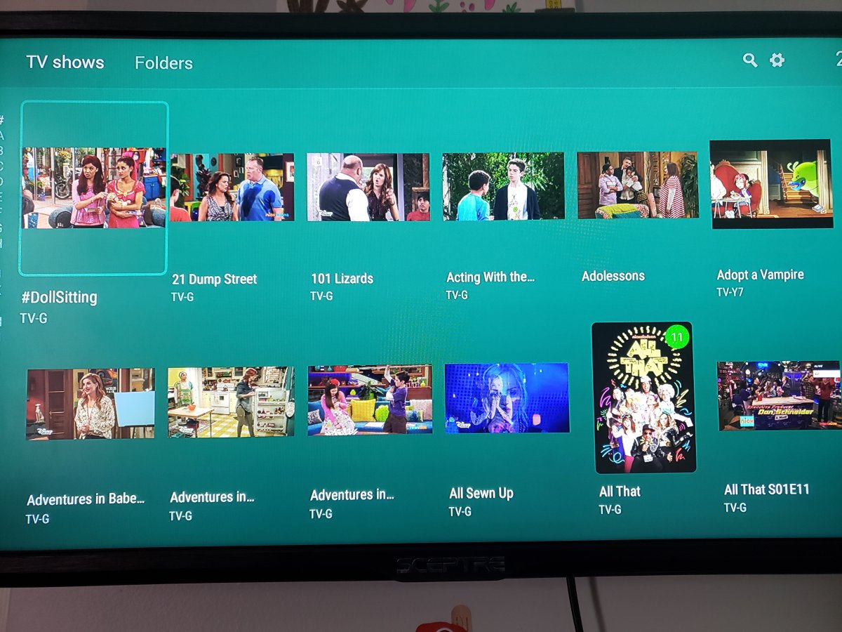

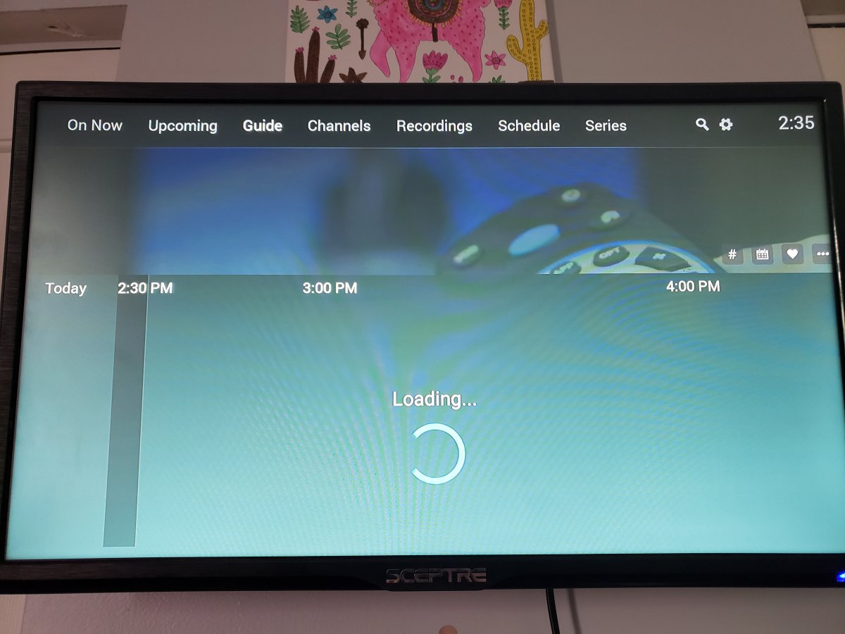

Dont1982 8 Posted September 23, 2020 Author Posted September 23, 2020 (edited) 20 minutes ago, cayars said: Hi, no you shouldn't have to as Premiere is good to unlock 25 devices. Can you go over an example of a problem you kids see? Have you checked their access to features in the web app users menu? Yes i have checked access and they have access to the live tv shows and recordings, The tv recording have show folders for all the seasons, when they are logged in it has the show folders and also all the episodes out of the folders, the live tv will not even load the guide. But when i log in everything works perfectly. I think it may have something to do with them not paying 120.00 each for an emby premiere. because it always pops up for emby premiere on their log ins. How do i put them as local users under my emby connect. the wiki has nothing bout that in there but it does state that on the emby server. i am attaching some pics. Edited September 23, 2020 by Dont1982
Dont1982 8 Posted September 23, 2020 Author Posted September 23, 2020 4 minutes ago, cayars said: What is wrong now that wasn't before? Need more info! the live tv worked and the tv shows were grouped like they should have been. After the server upgrade the other day this is the result on their accounts
Carlo 4561 Posted September 23, 2020 Posted September 23, 2020 Your kids do not need Emby Premiere as you install this on the server. What kind of TV is that or asked another way what app are you running in the TV picture above? What happens if you try using only a web browser with their credentials? Do you get the guide and can watch TV?

Dont1982 8 Posted September 23, 2020 Author Posted September 23, 2020 Ok i have figured it out. It is a problem with the tags and parental controls. If i give unrestricted access it works fine, but when I tag a channel or show with their names and tell the parental controls to only allow things with that tag specified to show, then i loses its mind and does not show a guide for live tv even if i give access to it, also on tv shows it does not show folder view. It shows all of the tv show episodes and folder view at the same time.
Carlo 4561 Posted September 23, 2020 Posted September 23, 2020 Doesn't sound like anything is wrong. If you set the user to allow allow things you've tagged THAT IS ALL THEY WILL GET. Emby is actually doing exactly what you told it to do. With that said there is not a built in way to do DVR recordings specific for certain people. What I've done is similar situations is setup recordings for users who want them but set "Keep up to:" X episode and set it to 3 or something. That way nothing need be deleted manually but they will only get the 3 most recent episodes. Makes them watch the things they asked to have recorded or "tough luck" when it get's deleted.
Dont1982 8 Posted September 23, 2020 Author Posted September 23, 2020 (edited) 4 minutes ago, cayars said: Doesn't sound like anything is wrong. If you set the user to allow allow things you've tagged THAT IS ALL THEY WILL GET. Emby is actually doing exactly what you told it to do. With that said there is not a built in way to do DVR recordings specific for certain people. What I've done is similar situations is setup recordings for users who want them but set "Keep up to:" X episode and set it to 3 or something. That way nothing need be deleted manually but they will only get the 3 most recent episodes. Makes them watch the things they asked to have recorded or "tough luck" when it get's deleted. no it isnt working correctly at all. I had been until this update. i have tagged live tv channels and tv recordings. Previously the tv guide showed channels with the listings, that i had tagged. And same with tv shows, and the tv shows would be in folder form not just a hodge podge of episodes. I have plenty of room for their shows and mine. Now after the update the live tv does not show anything on the guide and the tv shows are just episodes. I can un restrict it and it looks like it should. And there is a way that only they see it and on mine. I tag them with their name on the metadata and set the parental controls to only allow stuff with the specified tag. Emby unrestricted is workign as it should yes bt something is going on with the parental controls. and it has never done it until this update. Edited September 23, 2020 by Dont1982

Carlo 4561 Posted September 23, 2020 Posted September 23, 2020 @Luke parental controls are doing some very weird things and not honoring tags assigned. Steps to reproduce. Pick one or two Live TV channels as admin and add tag SHOWIT Create user TEST and deny them access to everything except Live TV. Setup parental restrictions so the user only see's content with tag SHOWIT. Login as TEST user and see what you get. I have access to libraries not granted access to. In live TV I get some programs but no guide, etc.. Something is quite off.

Luke 42246 Posted September 23, 2020 Posted September 23, 2020 Please try to use your local web app by putting this address into a browser: http://192.168.0.192:8096 Then login as one of these users. Are you able to see the guide then?
Dont1982 8 Posted September 23, 2020 Author Posted September 23, 2020 Just now, cayars said: @Luke parental controls are doing some very weird things and not honoring tags assigned. Steps to reproduce. Pick one or two Live TV channels as admin and add tag SHOWIT Create user TEST and deny them access to everything except Live TV. Setup parental restrictions so the user only see's content with tag SHOWIT. Login as TEST user and see what you get. I have access to libraries not granted access to. In live TV I get some programs but no guide, etc.. Something is quite off. thank you @cayars at least i know im not totally crazy lol. i have recreated it multiple times. I a, glad you were able to recreate it. Also do it to a recording and see what happens to the folder views lol. That is what the pics above show.
Dont1982 8 Posted September 23, 2020 Author Posted September 23, 2020 (edited) 2 minutes ago, Luke said: Please try to use your local web app by putting this address into a browser: http://192.168.0.192:8096 Then login as one of these users. Are you able to see the guide then? yes i can log in and No i am not able t see the guide with the parental on. it looks the same as the firestick app. But i log into mine as admin and it looks perfect, i remove the parental locks and it looks fine and works like it should. also the movies will not play it says too many errors giving up. But without parental controls on it plays fine on the same login. Edited September 23, 2020 by Dont1982 adding content
