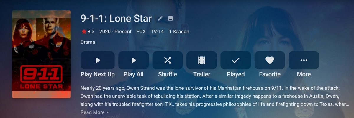

sooty234 266 Posted September 23, 2020 Posted September 23, 2020 Since the update, a lot of my images are broken. Refreshing and/or redownloading doesn't fix it, and can make it worse. The actual files are just fine. They're just broken in emby. embyserver.txt
sooty234 266 Posted September 23, 2020 Author Posted September 23, 2020 6 minutes ago, sooty234 said: The actual files are just fine. I'm revising that, I don't even know where some of those pictures, are. They aren't with the video. So I don't know if they're broken.

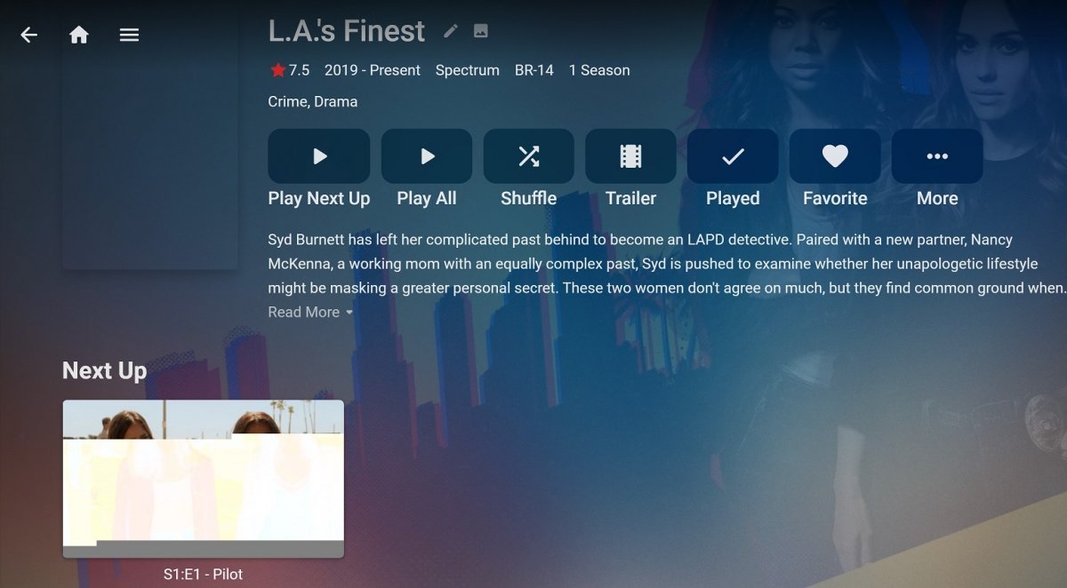

sooty234 266 Posted September 23, 2020 Author Posted September 23, 2020 (edited) This is awful. More and more of them. And this is how they look in all apps. Edited September 23, 2020 by sooty234

sooty234 266 Posted September 23, 2020 Author Posted September 23, 2020 Maybe this will help make it easier to understand. If I go to a show that has no issues then refresh the metadata and/or replace the images, the new images are screwed up.
Luke 42210 Posted September 23, 2020 Posted September 23, 2020 13 minutes ago, sooty234 said: On what device? The server? The server doesn't use my GPU. And as I said, it looks like this on all of my devices. The server. The skia graphics library is hardware accelerated.
sooty234 266 Posted September 23, 2020 Author Posted September 23, 2020 3 minutes ago, Luke said: The server. The skia graphics library is hardware accelerated. Well that's a terrible idea. How can I ditch that?
