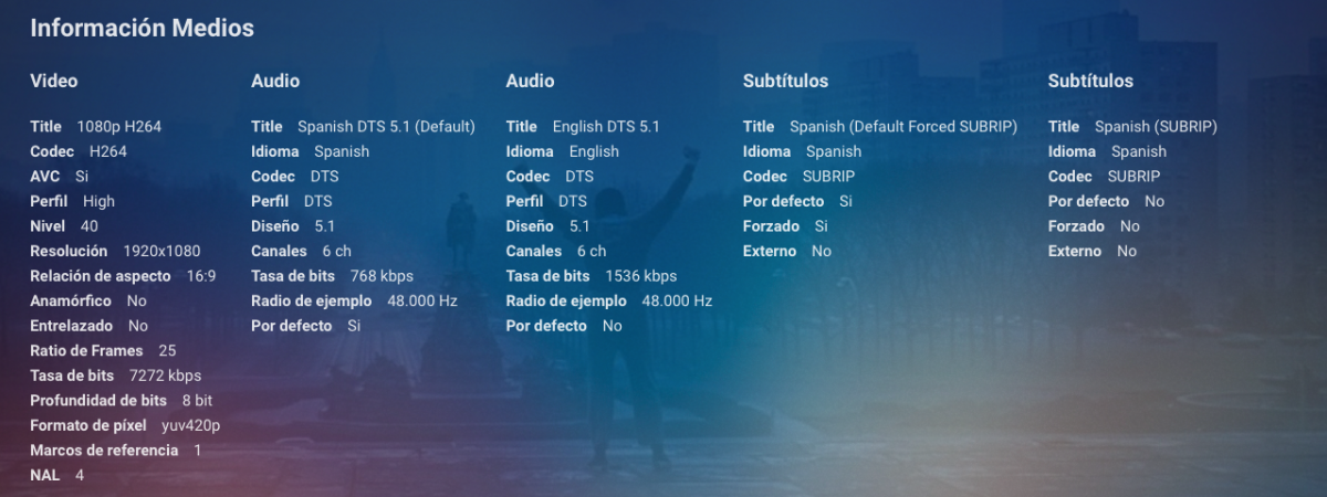

vdatanet 1619 Posted September 21, 2020 Posted September 21, 2020 (edited) I have some movies in 1080i format but Emby doesn't detect them as interlaced videos. This means that in devices that do not support interlaced video, such as Apple TV, they cannot play the content since instead of transcoding direct play is attempted. MediaInfo.txt Edited September 21, 2020 by vdatanet

Happy2Play 9802 Posted September 21, 2020 Posted September 21, 2020 4 minutes ago, cayars said: I can't read that mediainfo output so I don't know what it says. Would assume a translation issue as it shows Sweep type instead of Scan type. Video ID: 1 Format: AVC Format / Info: Advanced Video Codec Profile format: High @ L4 Format settings: CABAC / 2 Ref Frames Format settings, CABAC: Yes Format settings, RefFrames: 2 frames Codec ID: V_MPEG4 / ISO / AVC Duration: 1 h 59 min Bit rate type: Variable Bit rate: 4 862 kb / s Maximum bit rate: 15.0 Mb / s Width: 1 920 pixels Height: 1,080 pixels Aspect Ratio: 16: 9 Frame rate mode: Constant Frame rate: 25,000 FPS Color space: YUV Chroma subsampling: 4: 2: 0 Bit depth: 8 bit Sweep Type: Interlaced Sweep type, storage method: Separate fields Sweep order: Top field first Bits / (pixel * frame): 0.094 Stream size: 4.05 GiB (67%) Title: www.descargaya.es Spanish Language Default: Yes Forced: Yes
Carlo 4561 Posted September 21, 2020 Posted September 21, 2020 Well that clearly shows it being interlaced. vdatanet can you drop to the command line and run a "ffmpeg -i filename" and see if it say's it's interlaced or not?
