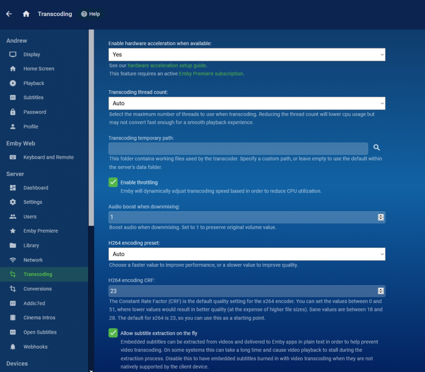

agottschling 2 Posted September 11, 2020 Author Posted September 11, 2020 I haven't disabled anything AFAIK. Transcoding settings page below:

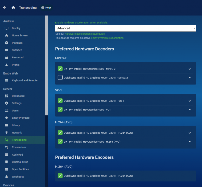

Happy2Play 9802 Posted September 11, 2020 Posted September 11, 2020 6 minutes ago, agottschling said: I haven't disabled anything AFAIK. Transcoding settings page below: Please toggle from Yes to Advanced.
Happy2Play 9802 Posted September 11, 2020 Posted September 11, 2020 If you disable h264 decoding do you get HWA encoding. But our ffmpeg god may have to explain why decoding is not working. You do have Emby Premiere, correct?

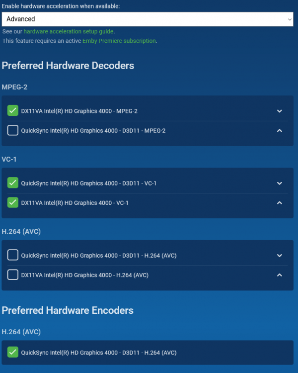

agottschling 2 Posted September 11, 2020 Author Posted September 11, 2020 Just now, Happy2Play said: If you disable h264 decoding do you get HWA encoding. But our ffmpeg god may have to explain why decoding is not working. You do have Emby Premiere, correct? Yes, I have a lifetime Premiere license No HW encoding w/ decoding disabled:
Happy2Play 9802 Posted September 11, 2020 Posted September 11, 2020 1 minute ago, agottschling said: Yes, I have a lifetime Premiere license No HW encoding w/ decoding disabled: Can you post the ffmpeg log for this playback.

Luke 42208 Posted September 12, 2020 Posted September 12, 2020 Try just selecting yes and going with the defaults and see how that compares.
Happy2Play 9802 Posted September 12, 2020 Posted September 12, 2020 2 minutes ago, Luke said: Try just selecting yes and going with the defaults and see how that compares. That is what is in the first post showing Error While Decoding. 21:35:57.913 Error while decoding stream #0:0: No such device or address
