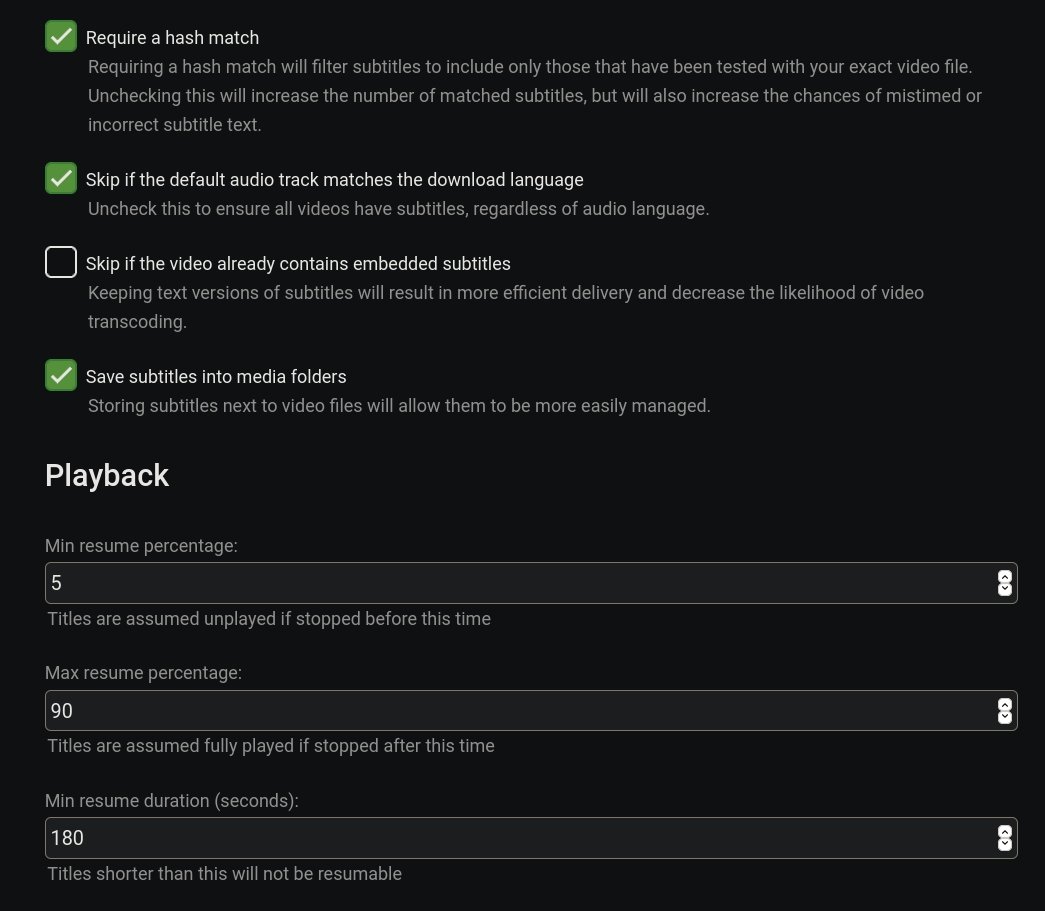

alanrbryant 0 Posted September 12, 2020 Author Posted September 12, 2020 Hey guys, thanks for responding! @Luke, I have attached two screenshots that show without tags (NoTags.jpg) and with tags (Tags.jpg). I add the tag and uncheck the box for Tags so that it does not get changed, but sometime later, maybe hours, maybe days, it reverts to no tags and checked. @Happy2Play, I have attached screenshots of my TV Shows configuration. There is a spot about saving metadata to nfo, does that mean that it does not then save it to the Emby db? I assumed that Emby used the nfo to initially match and then ignored it after. If that is not the case, could Sonarr then be overwriting the nfo and Emby reading it again? Thank you guys for all of your help.
