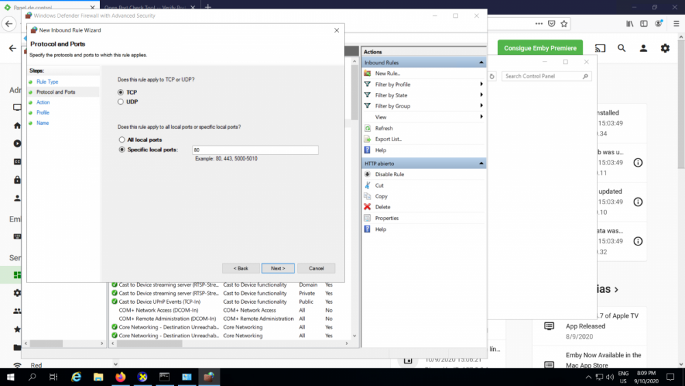

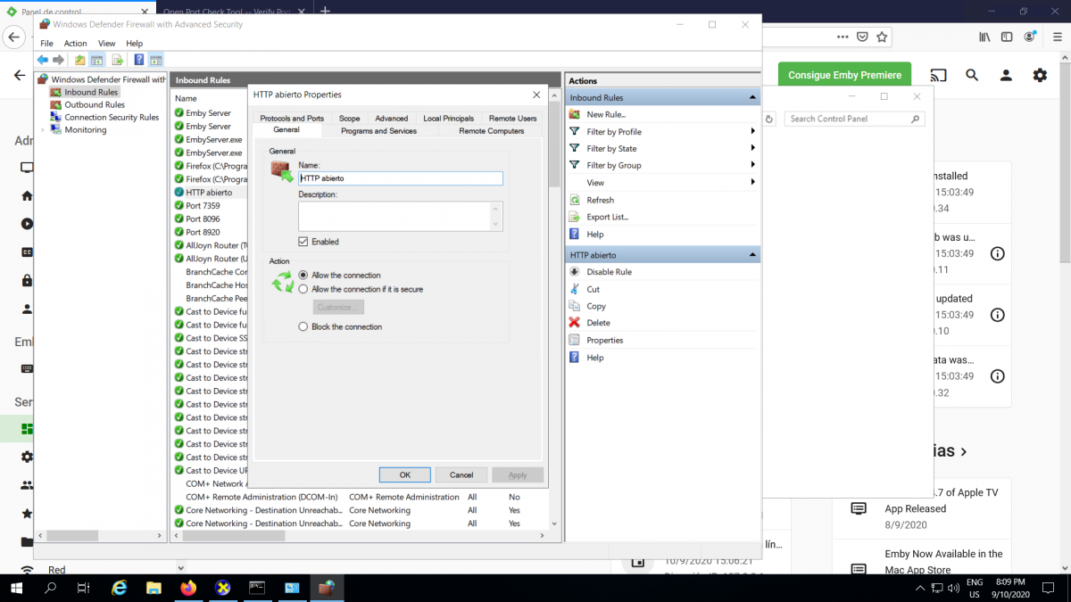

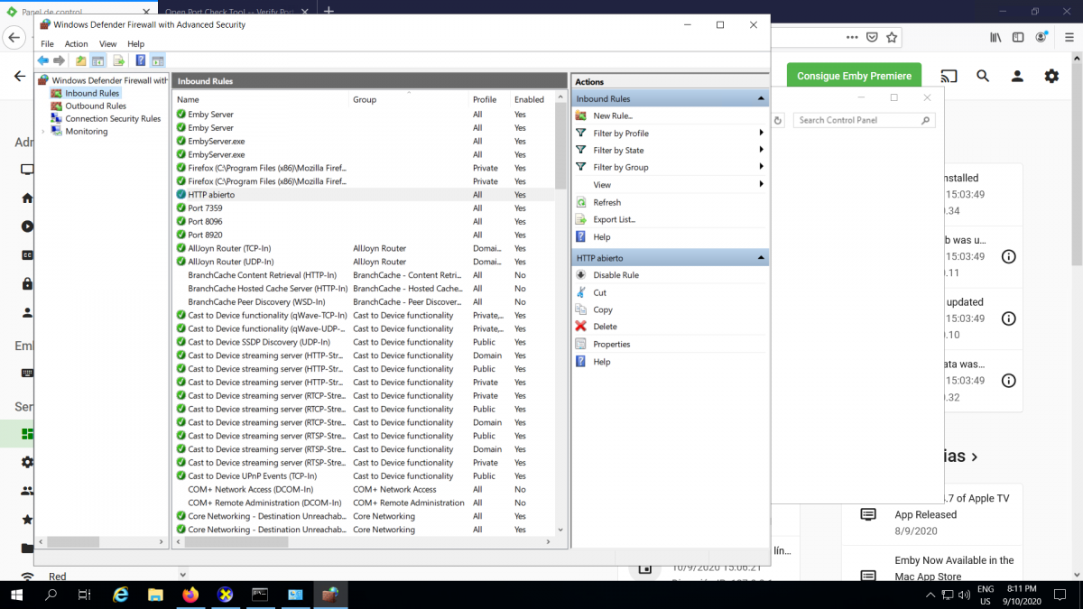

Administra 1 Posted September 10, 2020 Author Posted September 10, 2020 Hello new brothers, I have seen the tutorial you sent me, I have followed the steps, of creating new network rules, and I have bought if I can enter emby. well let me tell you that from my server if I want to enter emby with another browser, I successfully entered, but when I want to enter emby through my local computer I can not, I get an error, there in the tutorial talks about configuring the raoute, I did the steps but could not enter the server raoute, enter the end and put ifconfig to see the address and also was not successful, please help me, because I want to access my emby but remotely, either from my local computer or an external browser.
Carlo 4561 Posted September 10, 2020 Posted September 10, 2020 Can you post screen shots of the AWS firewall and passthrough/port forwarding you have setup in AWS?

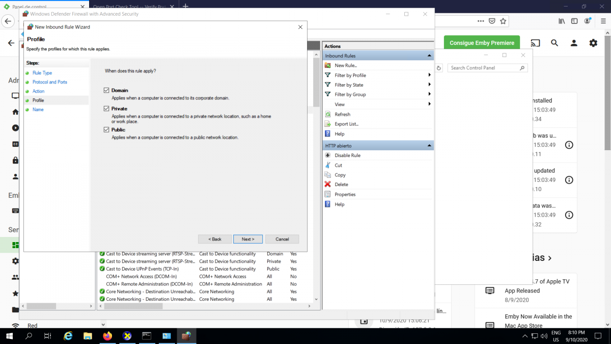

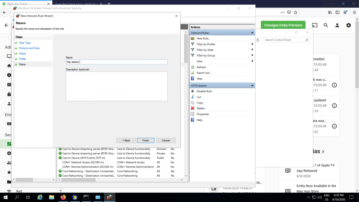

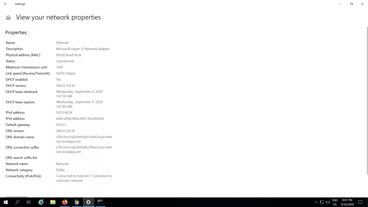

Administra 1 Posted September 10, 2020 Author Posted September 10, 2020 Of course, with pleasure I attach the captures of the steps that you realize, they located a few steps for example as the configuration of the route that I could not realize, where it is the configuration for the wifi does not appear to me, only appears ethernet

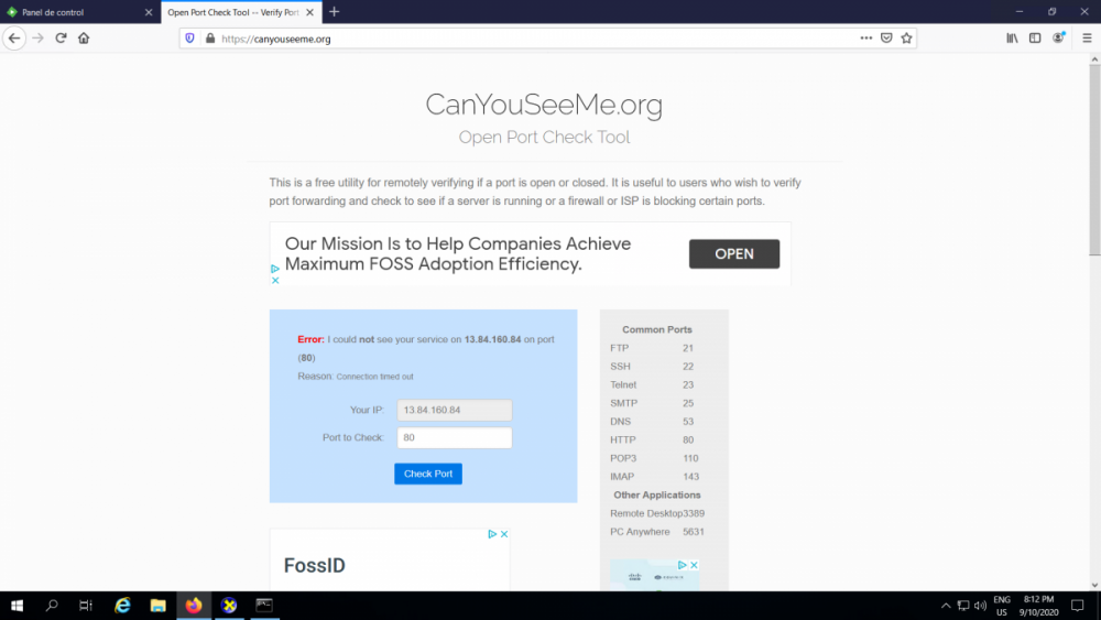

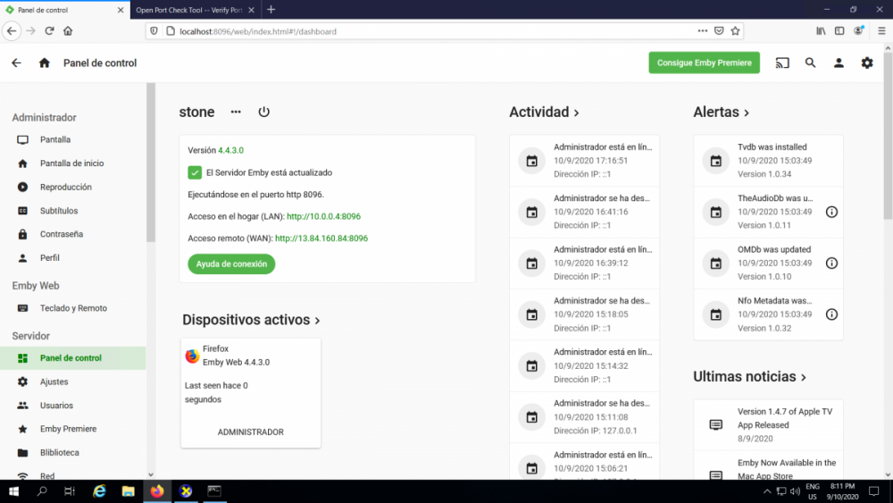

Carlo 4561 Posted September 10, 2020 Posted September 10, 2020 Your machine is running on the local network with an ip of 10.0.04 and the external IP is 13.84.160.84 Where is your forwarding of the outside IP to the inside IP?
Happy2Play 9800 Posted September 10, 2020 Posted September 10, 2020 Only one port appears to open on that external ip also.

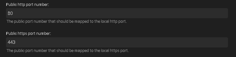

Carlo 4561 Posted September 10, 2020 Posted September 10, 2020 I just happened to notice you're testing port 80 at canyousee me but your Emby Server is setup on port 8096. If you setup port 80 to 8096 forwarding then you need to change the remote port in Emby Networking for non SSLto port 80 as well. 1

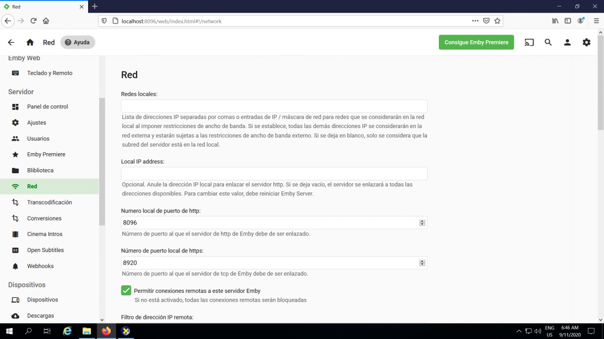

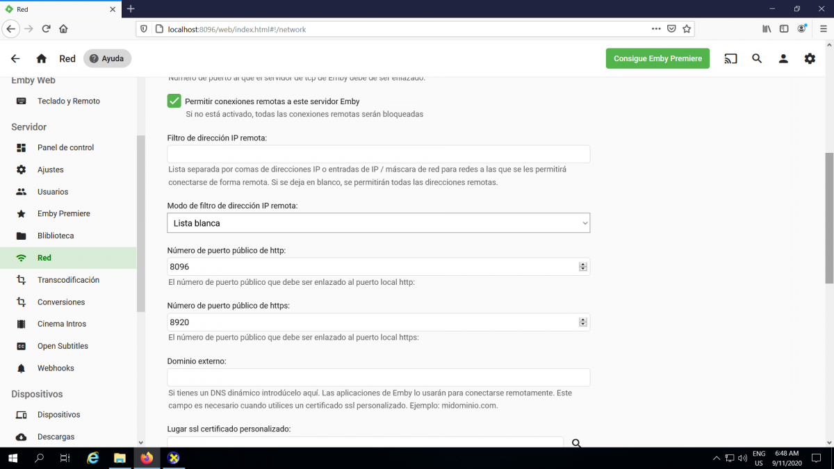

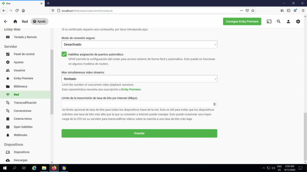

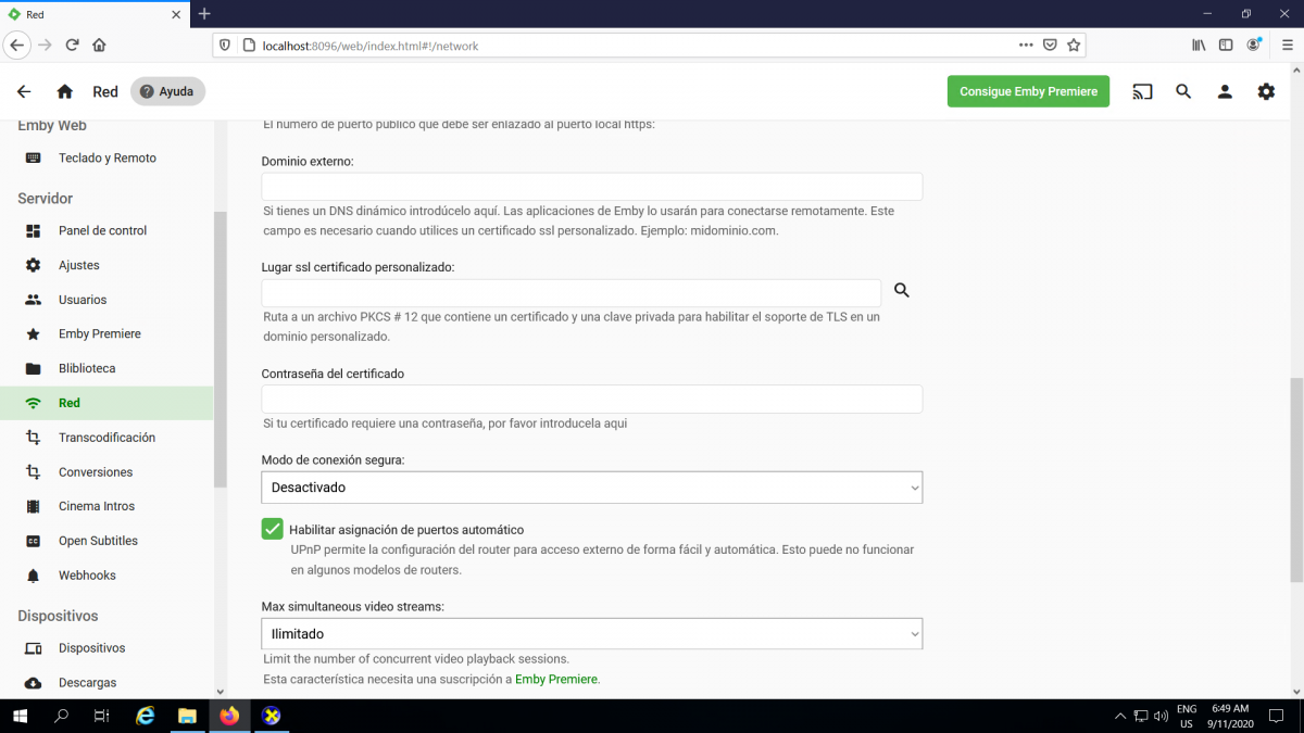

Carlo 4561 Posted September 11, 2020 Posted September 11, 2020 In Emby on the Network settings what do you have set here?
Administra 1 Posted September 11, 2020 Author Posted September 11, 2020 29 minutes ago, cayars said: In Emby on the Network settings what do you have set here? Here's what I got, here's what I got, brother
Carlo 4561 Posted September 11, 2020 Posted September 11, 2020 You don't need to show me what you got. You need to change it to what I showed you. You opened port 80 on your router so you need to set Emby to use port 80 in the remote setting I showed above. You also need to make sure you are forwarding WAN IP port 80 to internal machine port 8096 on the Emby Server.
Administra 1 Posted September 11, 2020 Author Posted September 11, 2020 7 hours ago, cayars said: You don't need to show me what you got. You need to change it to what I showed you. You opened port 80 on your router so you need to set Emby to use port 80 in the remote setting I showed above. You also need to make sure you are forwarding WAN IP port 80 to internal machine port 8096 on the Emby Server. It's ok brother, only I already tried changing the port 80 and it didn't work, what I haven't tried is to see the WAN 80 ip forwarding to the internal port, I really don't know how to do that step, can you support me with that?

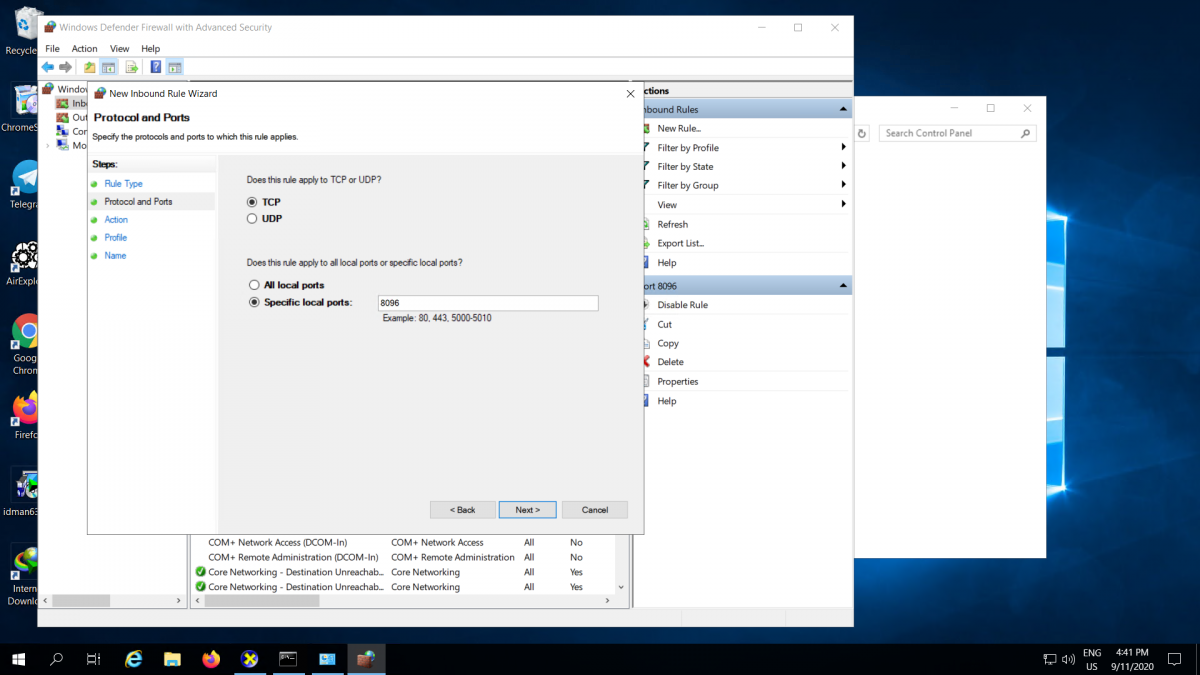

Carlo 4561 Posted September 11, 2020 Posted September 11, 2020 Do me a favor and try this. Open port 8096 on your router and set the remote port back in Emby to 8096. Does this work?
Administra 1 Posted September 11, 2020 Author Posted September 11, 2020 13 minutes ago, cayars said: Do me a favor and try this. Open port 8096 on your router and set the remote port back in Emby to 8096. Does this work? I already tried and nothing works, brother, I opened the other entrance of the port and it always gives me error of to connect, this is the port that I opened
