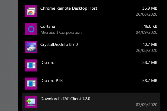

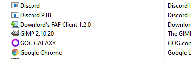

KaiKama 0 Posted September 6, 2020 Posted September 6, 2020 (edited) Going to preface this with that it does NOT appear withing the add/remove progams within control panel, it does NOT appear in Apps within settings and searching every drive i have does NOT find anything to do with uninstalling. I'm trying to fully remove the server as I've recentrly changed some hardware (cpu/Ram) and now no one can connect remotely, even via the IP address or verified accounts, even i can't connect remotely on my admin accounbt anymore, so thinking a complete restrat reinstall would fix it, but as the rest says, how the frick do i uninstall this damn thing? there's no uninstaller exe nore does anything appear elsewhere, unless it isn't listed under Emby. Attached is both add/remove in control pannel and apps in the main settings of windows 10, as you should see, Emby simply isn't there. note that this is NOT a Port issue, nothing has changed on my router and untill i changed CPU/RAM myself and my friend could connect remotely no problems, literally the ONLY thing that has changed has been physical config, nothing software based has changed. Edited September 6, 2020 by KaiKama

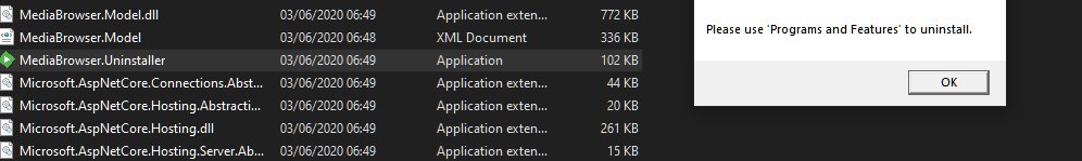

KaiKama 0 Posted September 6, 2020 Author Posted September 6, 2020 (edited) 5 minutes ago, seanbuff said: Did you perhaps install a portable version of Emby Server? Probably the quickest way to find out is to find the location of the running 'EmbyServer.exe' process. Go to Task Manager, find Emby Server and right-click 'Open file location' If it is in a location other than C:\Users\<USER>\AppData\Roaming\Emby-Server\system then you're probably running a portable copy, which would not show up in Add/Remove Programs. i definitely did not (i've had it installed for months, maybe even a year? i dunno, just know it's unlikely i chose portable) though this brings this up in C:\Windows.old************* as i've recently reinstalled windows which seems to create these "old" folders... found an uninstaller but it's telljng me to use programs and features to uninstall Edited September 6, 2020 by KaiKama

ebr 16310 Posted September 6, 2020 Posted September 6, 2020 9 hours ago, KaiKama said: i definitely did not (i've had it installed for months, maybe even a year? i dunno, just know it's unlikely i chose portable) though this brings this up in C:\Windows.old************* as i've recently reinstalled windows which seems to create these "old" folders... found an uninstaller but it's telljng me to use programs and features to uninstall Those files are from a very old installation. My guess is you installed it a long time ago and then just did updates from then. When Windows updated, it moved most of your installation - including the uninstaller to that ".old" folder - which it does with programs it thinks are not compatible (incorrect in this case).
