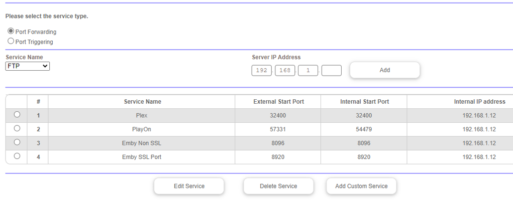

rbjtech 5337 Posted September 7, 2020 Posted September 7, 2020 Port triggering is an older, now rarely used method of port forwarding where the ports are only opened when needed, but the downside (as you have discovered) is they close by themselves, leading to unpredictable connections. If port triggering to the same 'service' works fine but port forwarding does not, then there is something very wrong as they are both doing (almost) exactly the same thing. Is it worth showing a screen grab of your forwarding config page and maybe your overview page (remove the WAN address) ?
MBSki 1115 Posted September 7, 2020 Author Posted September 7, 2020 6 hours ago, cayars said: Remote was working fine so you shouldn't need port triggering. Unless you're saying this helps with the WIFI? Yes, it fixes the WiFi issue. All my wireless devices show up connecting with a local IP when using port triggering. 3 hours ago, rbjtech said: Port triggering is an older, now rarely used method of port forwarding where the ports are only opened when needed, but the downside (as you have discovered) is they close by themselves, leading to unpredictable connections. If port triggering to the same 'service' works fine but port forwarding does not, then there is something very wrong as they are both doing (almost) exactly the same thing. Thanks, definitely seems like a bug then. 3 hours ago, rbjtech said: Is it worth showing a screen grab of your forwarding config page and maybe your overview page (remove the WAN address) ? Here's my port forwarding page. Which overview page are you referring to? 1
