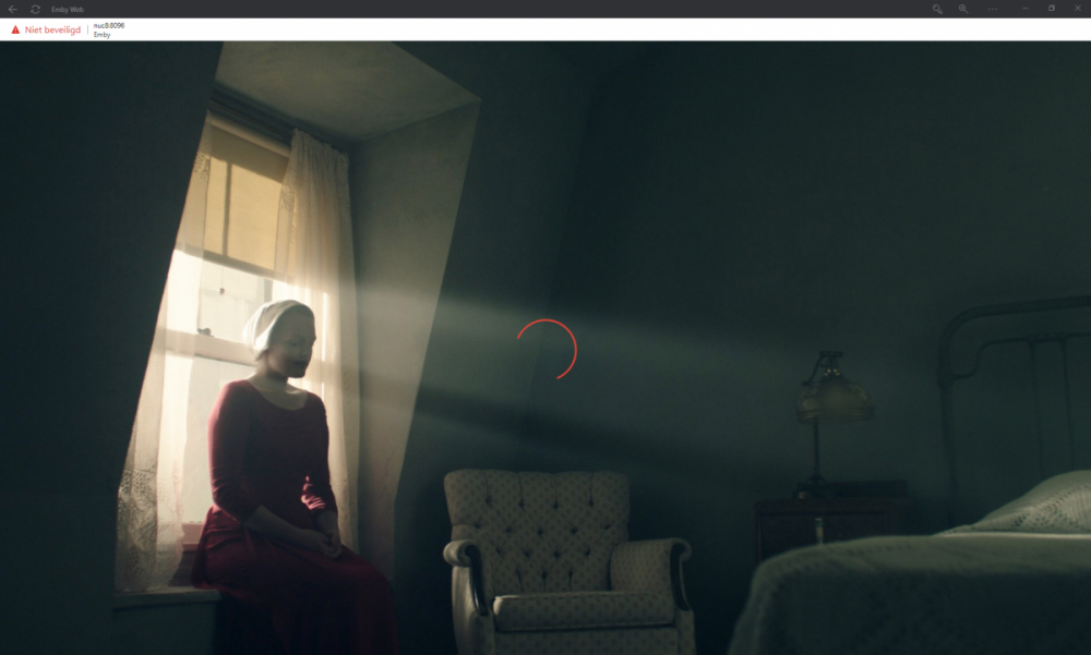

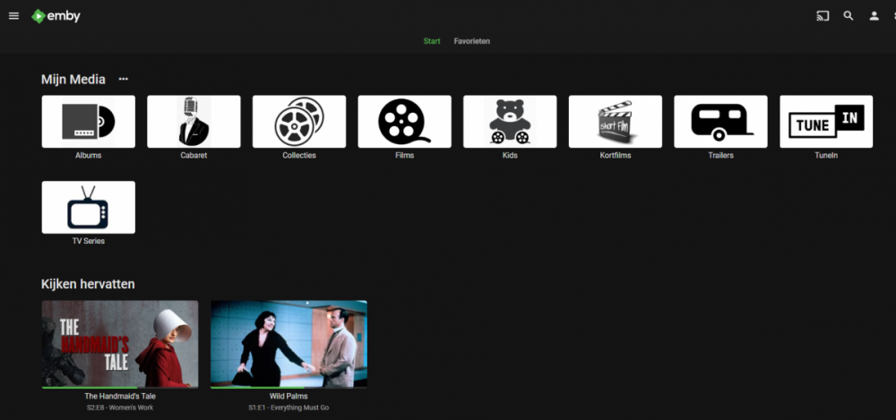

cisfi5h 2 Posted September 1, 2020 Posted September 1, 2020 All, I'm a very happy Emby user for almost 1 year now. Until now I did not have 1 error Since recently 1 user named "Karen" (I have 22 users now) is complaining that 1 show/series does not play. I logged in with the user "Karen" (Through browser) at my home PC. Under continue watching (screenshots are in Dutch), I can see the series that she was watching (In this case The Handsmaid's Tale S02E08) -> See screenshot image.png. If I click on the green button on this show, the browser shows the background image of the show but does not start (See 2nd screenshot).. I also don't get any buttons to go back. Only solution is closing the browser and logging in again. I checked the network path to this show. The file is a bluray rip 1080 x265. If I logon with any other user (I have 22 at the moment), the file plays just fine. Also the continu watching works with other users. I tested this with a user Cisther so you can compare them in the logs (See attachment for logs). With regards and keep up the good work! Cis Jacobs cis.jacobs@outlook.com embyserver (1).txt ffmpeg-transcode-12420001-e3fa-42b7-a002-137ca5b68908_1.txt hardware_detection-63734581915.txt

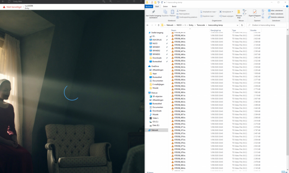

cisfi5h 2 Posted September 1, 2020 Author Posted September 1, 2020 All, Little update: I stopped emby server and restarted it and did the test again. This way the logs are smaller (See attachment). Still same problem. I've noticed that the transcoding temp folder is filling up. Deleted the files, started up the server but still the same. Files are pilling up again the the transcoding temp folder. Only 1 user has this. Other users (same user profile settings) can play this file fine. ffmpeg-transcode-1ca81e68-a086-42b3-97e1-5a8d01a89ddd_1.txt embyserver.txt

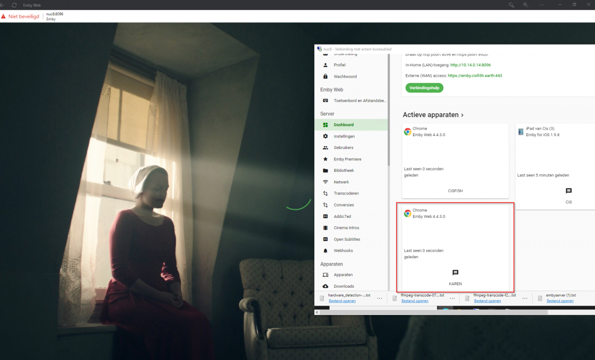

cisfi5h 2 Posted September 1, 2020 Author Posted September 1, 2020 Hi, Waw this is quick. Just created this ticket 1h ago. tnx! Actualy, I got a phone call from the user with the problem. Instead of taking over here screen, i logged in on my PC at home (Where the server also is, so not over the internet but local). First with another user (non admin - Cisther) and that worked. Then I logged on with here account (Karen) on my PC (so local) and played the file. Same error as she has at home over the internet. So both test are done on the same windows PC (Windows 10) with the same browser (Edge Chromium). Only the user is different. All my users (except my admin user) are configured exactly the same. User Cisther (Which works fine, same as all other users) gives following while playing: Use Karen (with the hanging screen) doesnt say anything. It's just does not start. Green cirkel goes on forever. Emby config says last seen 0 seconds. All my users have an internet streaming limit of 4Mbit. But the test i've done are all locally so that doesnt count. No difference (except name and password between users ffmpeg-transcode-f2d903fe-2002-46a2-ad28-47b5beb24dac_1.txt hardware_detection-63734591100.txt embyserver (1).txt ffmpeg-transcode-070c2f4e-35c8-45b0-9d9d-9f242bf627f7_1.txt

cisfi5h 2 Posted September 1, 2020 Author Posted September 1, 2020 PS: The last log files I've send are done with following tests: 21:02 Stopped Emby server (for starting with fresh new logs). 21:04 started Emby server 21:04 - 21:05 Logged on with user "Cis" and started Handmaid's Tale S08E02. PLays normal. User "Cis" Logged off. 21:06 - 21:07 Logged on with user "Karen" and started Handmaid's Tale S08E02. Does not play (Shows background picture of the show and a continious rotating circel. 21:08 Killed the browser (Can not go back if this user tries to play the file).

cisfi5h 2 Posted September 1, 2020 Author Posted September 1, 2020 Ok, I think by in-app you mean this This was not on 1 Mpbs before I took the screenshot, it was on Auto. Anyway, I did the test with 1mpbs (I have a network with 10gb uplink between switches and NAS so if this is the problem, I'm going to have a domotica nightmare and my monitoring server has to be checked). No luck still the same. Did also a test with Chrome (84.0.4147.135 (Officiële build) (64-bits)), the same problem and behaviour (pile up of transcode files, rotating cirkel, having to close browser,...). I will now look further for more info regarding the settings of this user compared to others (I did configure them in the past the same but you never know. My brain is much beter at forgetting the right things than remembering the not so usefull). with regards, Cis

cisfi5h 2 Posted September 1, 2020 Author Posted September 1, 2020 Thanks Cayars! Did the test and I can go up to 1080p 60Mbps with this episode for all users. If it is set to auto, it also gives this quality. For the user Karen I can't test because it never starts playing. After playing the green button, the backround image of the sow appears and a cirkel keeps turning forever. By the way: The reason for transcoding (so also internally on LAN) that emby gives is that the subtiles are not supported.
