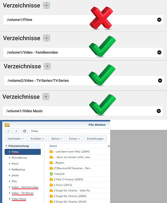

Carlo 4561 Posted September 4, 2020 Posted September 4, 2020 Hi. Please attach a picture/screen capture of the top of each of your libraries when you edit them from web admin LIBRARY menu please. This will clear up any confusion. Your log file is full off errors where Emby is denied access to your files. I would start with reviewing each of your library paths at the OS level and resetting permissions for the user running Emby Server. Carlo

ArnoRoggo 1 Posted September 4, 2020 Author Posted September 4, 2020 Ciao Carlo Here are the screens. I hope I got you right. As I said, you don't need to pay attention to the log entries for the series, because a copy process was still running during the scan (and it still does). Arno

Happy2Play 9802 Posted September 4, 2020 Posted September 4, 2020 My first guess looking at that image would be #recycle, but it could be those first three folders with periods. As there are other topics where a single item within the library folder caused the entire library to not be seen. Will look for the other specific platform topics in reference to recycle.
Happy2Play 9802 Posted September 4, 2020 Posted September 4, 2020 Do the other library folders have #recycle?
ArnoRoggo 1 Posted September 4, 2020 Author Posted September 4, 2020 The other libraries do not have a #recycle folder. So I deactivated / deleted the folder for the series and tried a scan, but without success.
Happy2Play 9802 Posted September 4, 2020 Posted September 4, 2020 Not ideal but this would suggest a item within that folder. Could you create a new folder and move a couple items into that folder and create a new library pointing to that new folder to see if it populates. Could you rotate your log file before doing this to have a new log to look at. Dashboard-Scheduled Tasks-Rotate log file
