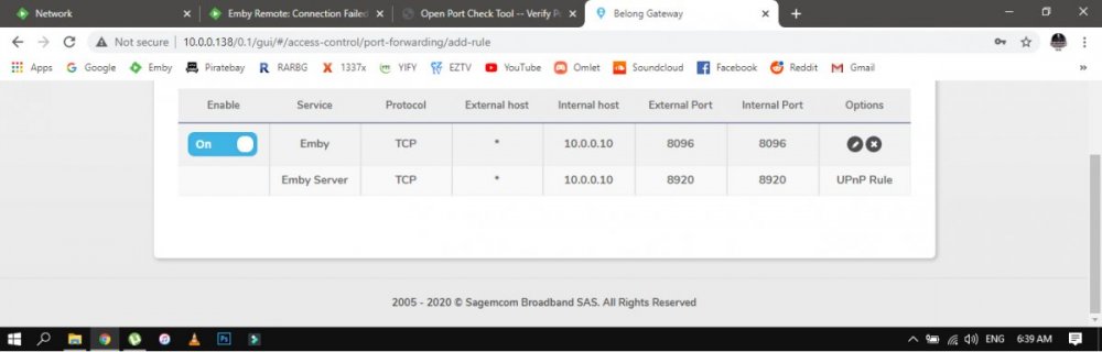

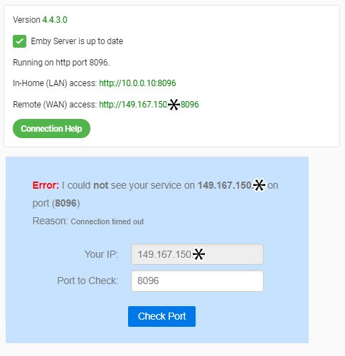

EVDEADSHOT 3 Posted September 1, 2020 Posted September 1, 2020 (edited) Hi, I'm very new to this please be patient. I've read all the forum topics and am no closer to solving this. An emby connect user account has been created. I have linked it successfully. The server is visible from the mobile app. But attempting connection gives the connection failure message. I have enabled remote connections in emby. TCP Port 8096 is forwarded, as is 8920 which appears to have happened by default. I completely shut down my firewall just to attempt to isolate the issue. Still cannot see the port on canyouseeme.org Your help is appreciated. Thank you. Edited September 1, 2020 by EVDEADSHOT Forgot to write something.
Carlo 4561 Posted September 1, 2020 Posted September 1, 2020 (edited) Hi, When looking at your dashboard in Emby web admin is the IP it shows for remote access the same IP you see listed at canyouseeme.org? Edited September 1, 2020 by cayars 1
EVDEADSHOT 3 Posted September 1, 2020 Author Posted September 1, 2020 (edited) 7 hours ago, cayars said: Hi, When looking at your dashboard in Emby web admin is the IP it shows for remote access the same IP you see listed at canyouseeme.org? Hi Buddy, It is indeed. I have another port forwarded - no conflict - that does work for its host application, but it's also not reachable from canyouseeme.org Edited September 1, 2020 by EVDEADSHOT
Carlo 4561 Posted September 1, 2020 Posted September 1, 2020 Do you have SSL setup on your Emby Server? How did you do the forwarding for port 8096 and 8920 in your router? Can you take a picture? Feel free to cover any external IP. 1
EVDEADSHOT 3 Posted September 1, 2020 Author Posted September 1, 2020 (edited) 25 minutes ago, cayars said: Do you have SSL setup on your Emby Server? How did you do the forwarding for port 8096 and 8920 in your router? Can you take a picture? Feel free to cover any external IP. Port forwarding in the router gui. I haven't changed or added any SSL settings in the server no. Edited September 1, 2020 by EVDEADSHOT
Carlo 4561 Posted September 1, 2020 Posted September 1, 2020 (edited) What happens if you right click open (clicking on the remote address) in new tab your remote IP address? In other words load up the remote address while on your home lan? Does this work? Edited September 1, 2020 by cayars 1
EVDEADSHOT 3 Posted September 1, 2020 Author Posted September 1, 2020 24 minutes ago, cayars said: What happens if you right click open (clicking on the remote address) in new tab your remote IP address? In other words load up the remote address while on your home lan? Does this work? This site can’t be reached 149.167.150.* took too long to respond. Try: Checking the connection Checking the proxy and the firewall Running Windows Network Diagnostics ERR_CONNECTION_TIMED_OUT
Happy2Play 9802 Posted September 1, 2020 Posted September 1, 2020 It shouldn't matter but it looks link you have upnp and manual port forwarding. If you disabled port mapping in Emby and then restarted Emby and your router do you see any difference? Dashboard-Network setting near the bottom. 1
Carlo 4561 Posted September 1, 2020 Posted September 1, 2020 (edited) 30 minutes ago, EVDEADSHOT said: This site can’t be reached 149.167.150.* took too long to respond. Try: Checking the connection Checking the proxy and the firewall Running Windows Network Diagnostics ERR_CONNECTION_TIMED_OUT This is what I expected. Either forwarding is not working correctly or your router doesn't support loop back. Let's start by simplifying a couple of things and doing what Happy2Play mentioned. Your not using SSL so let get rid of 8920 forwarding. Let's do this the easy way by removing the port mapping plugin from Emby. You don't need this as you've manually forwarded port 8096. Remove the plugin, restart Emby. Then reset your router. After this retry the above test (right click on remote and open in new tab). Any progress? Edited September 1, 2020 by cayars 1
EVDEADSHOT 3 Posted September 1, 2020 Author Posted September 1, 2020 7 minutes ago, cayars said: This is what I expected. Either forwarding is not working correctly or your router doesn't support loop back. Let's start by simplifying a couple of things. Your not using SSL so let get rid of 8920 forwarding. Let's do this the easy way by removing the port mapping plugin from Emby. You don't need this as you've manually forwarded port 8096. Remove the plugin, restart Emby. Then reset your router. After this retry the above test (right click on remote and open in new tab). Any progress? Thank you. Yeah it's the default ISP router, likely locked up. Uninstalled port mapping, checked router ports and power cycled, restarted the server. Still cant access the remote address.
Carlo 4561 Posted September 2, 2020 Posted September 2, 2020 I took a quick look via Teamviewer and @EVDEADSHOT is behind a major cgnat a couple of layers thick. He's going to check for other possible ISPs or more than likely a public VPN that he can get with a dedicated IP and reserved port. That would punch through the ISP and give him a port/IP address on the public Internet for Emby use. 1
EVDEADSHOT 3 Posted September 2, 2020 Author Posted September 2, 2020 1 minute ago, cayars said: I took a quick look via Teamviewer and @EVDEADSHOT is behind a major cgnat a couple of layers thick. He's going to check for other possible ISPs or more than likely a public VPN that he can get with a dedicated IP and reserved port. That would punch through the ISP and give him a port/IP address on the public Internet for Emby use. This guy is an absolute champion. 1
EVDEADSHOT 3 Posted September 2, 2020 Author Posted September 2, 2020 7 hours ago, cayars said: I took a quick look via Teamviewer and @EVDEADSHOT is behind a major cgnat a couple of layers thick. He's going to check for other possible ISPs or more than likely a public VPN that he can get with a dedicated IP and reserved port. That would punch through the ISP and give him a port/IP address on the public Internet for Emby use. 5 hours ago, Luke said: Thanks for the feedback! Hey guys you can mark this as solved. Carlo eventually figured out what i missed and that was that my ISP had me on dynamic IP. I requested a static IP, it's been assigned, with port forwarded and IP assigned correctly I can now log in remotely without any further hassle. Thanks heaps Carlo.
